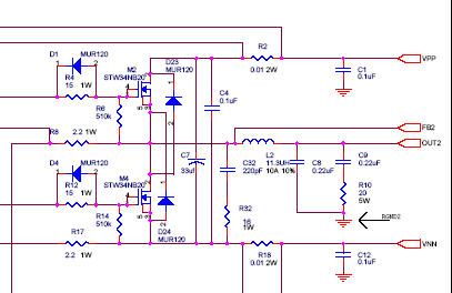

Let's look at this part of a Tripath amp for example. How would changing the output inductor improve the class D amplifier performance. People have previously posted core material parameters and windings. Does it make sense as a better output inductor?
I'd put an additional "RF filter" after the main output filter in order to improve on RFI performance.
Remember that a simple LC filter is just a proper 2nd order lowpas IN THEORY.
I don't think that Lars' modulator is very susceptible to RF either. AFAIK it is a self-oscillating topology. Carrier-based amps are more susceptible to RF glitches (and restricted in terms of THD performance due to carrier residual).
And back to topic: Winding schemes that reduce the coil's parasitic capacitance will also improve the RF behaviour. One such scheme has already been mentioned by Lars.

The Tripath amp (from your posted section of the schematic) appears to use only pre-filter NFB. The output filter is therefore not part of the feedback path, so any problems with core non-linearities may have a measurable and audible effect on the output.

Ouroboros said:The Tripath amp (from your posted section of the schematic) appears to use only pre-filter NFB. The output filter is therefore not part of the feedback path, so any problems with core non-linearities may have a measurable and audible effect on the output.
Tripah engineers said the system would be unstable with post filter feedback. Even if post filter feedback was implemented, measureable and audible effects would still be there.

This is a practical example where people have actually changed the output inductor design. Is there a practical explanation whether the design is better or worse? It's okay to not respond if nobody knows the answer.
Lars Clausen said:
This is a common misunderstanding. The pre / post filter scheme has absolutely no bearing on PSRR. However open / closed loop has.
One way to get rid of the RF transmission problem in the coil, is to place a small open aircoil to 'eat' the high slopes before they hit the real filter coil. This way you can wind a normal simple filter coil without considering the RF properties.
I'm not sure how effective that would be, but it could certainly be simulated in spice if all spice models were available (a problem I constantly run into). Looks quite valid approach at a glance.
Here you can see why it works. This scope shot shows the 'blimp' enlarged, has a frequency of around 85 MHz. The first LC filter should have a pole at maybe 10 MHz, and thus will have 36dB attenuation at 80 MHz (3 octaves x 12 dB). Blimp 'poof' gone..!
