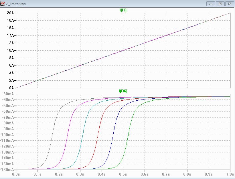

With 50V across the output transistor, current limiting starts at about 3A. This gives 150 Watts dissipation in the 2SC5200. That's just inside the SOA 🙂
For 2 output transistors value doubles, of course.
C6 was later added, after some simulating and real world testing. It makes the protection a bit smoother.

The 100ms one shot Tc=25°C SOA is ~4.3Apk @ 50VceWith 50V across the output transistor, current limiting starts at about 3A.
De-rate for elevated temperature and you may find that 3Apk is too high for a 1943.
Tc=65°C gives a derating factor of (150-65)/(150-25) = 0.68
Apply that to the ~4.3Apk from the cold SOA graph and you get ~2.92Apk for less than 100ms.
what current is passing the protection transistor when the output is 10mApk? 100mApk? 1Apk? and PSU is 52Vdc?
What if the prot transistor has warmed up during operation due to the internal Ta rising to 35°C. It's Vbe turn on voltage will be lower.

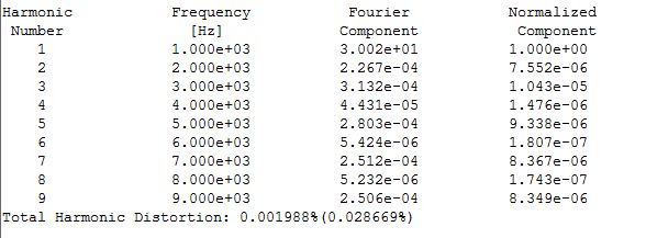

I think you are saying that the VI limiter adds up to distortion?
Actually, I did some simulations and it is adding distortion. For this board I found it acceptable, as distortions is very low. (120 W in 8 Ohm => 0.001988% @ 1kHz)

@AndrewT: thanks for your input. A bit alarmed I decided to simulate the output stage with protection in a different way.
I noticed that the current thru the limiting transistor was to high, just as you said. The result was that the limiting was not "steep" enough.
I played with the resistor values, and did some calculations too 😉
The result can be seen in the new simulation. The current through the limiting transistor is now 5 times lower.
With 8 ohm load, the current through the diode is 30nA top, so the signal passes unaltered.
With 4 ohm load the current is limited at about 9 amps. Voltage across the
power transistors is about 15V, giving 135 Watt total loss, or 67.5 Watt per transistor. No problem.
With 2 Ohm load the current is limited at about 7 Amps. Voltage across the transistors is about 39V giving 273 Watt total loss, or 136,5 Watt per transistor. Just within SOA.
With 0.01 ohm short circuit, current is limited at 5.4 Amps. Voltage across the transistors is about 53V giving 286 Watt total loss, or 143 Watt per transistor. Just within SOA.
View attachment vi_double_lim.asc

Could you post the .asc?
I would like to see the effect of the capacitor.
My thoughts are:
Set the DC limiting condition to pass enough very low frequency current through a resistive dummy load that equals the load rating of the amplifier.
Then use the capacitor to delay the limiter for faster current peaks.
This allows the limiter pass to transient currents that exceed the DC ratings and make use of the enhanced SOA for short term loadings.
If the prot Q is thermally coupled to the output devices/heatsink, then you can make use of the changing Vbe due to temperature to change the limiting condition depending on the temperature of the surroundings. i.e. more current passes without limiting when Qprot temp is low and less current when high temp.

I already posted it, 2 posts ago 😉
Interesting though about using the dynamic part of the SOA ..
edit: changed V2 in a pulse, and varied C1 a bit. When C1 is to small (< 1 nF) , the circuit oscillates. When C1 is to high (>100 nF) circuit is to slow, and peak current is to high.
