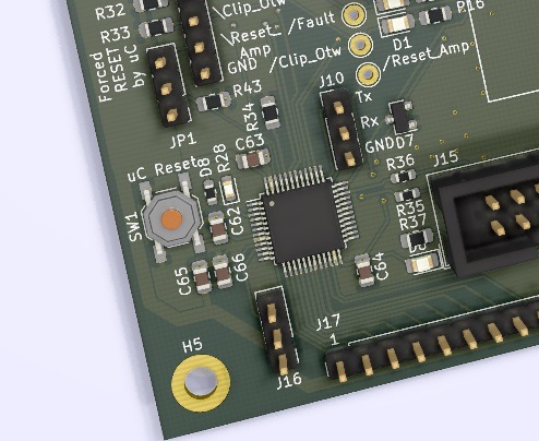

In order to establish a communication between NeatAMP and the terminal running on your PC you have to connect your PC to NeatAMP with a serial link.
On NeatAMP teh serial port connector is J10 (see pic.).
If your PC has a serial port, don't use it !, you'll destroy the STM32 as levels are +/-12V.
You need an usb adapter with 0/3.3V levels such as the one in my previous post.
