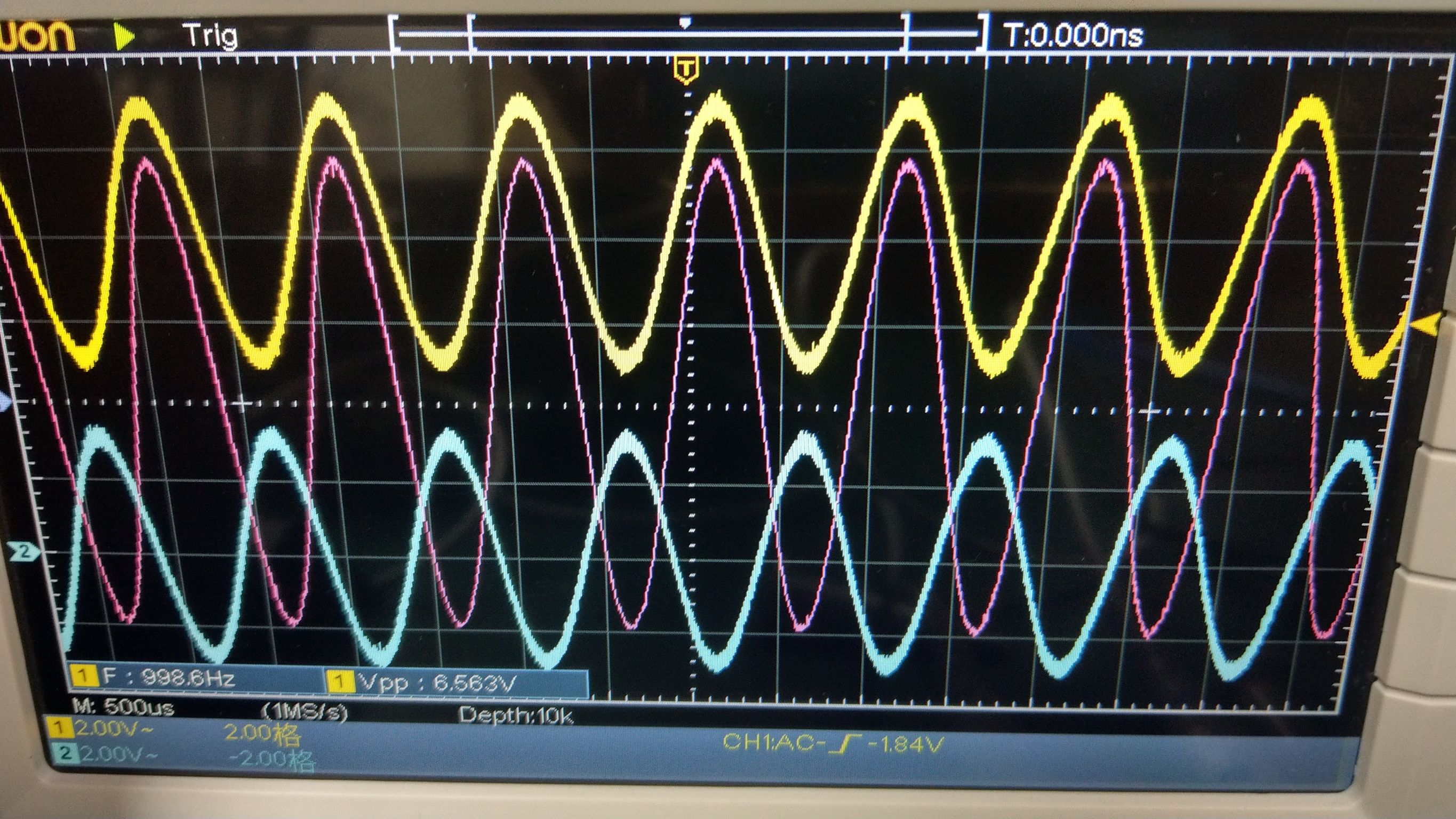

Great !, that looks like the expected result.
Pink trace is what see the load resistor, this is the signal the loudspeaker will see, then the music you want to hear... : that's the useful signal.
Amplitude is twice amplitude of each output, which is exactly what we expect from a BTL configuration.
Why doing this ?
Now you can hide channel 1 and channel 2 in order to only get on screen pink trace ( ch1-ch2), then repeat your measurement in post #365 : magnify the signal in order to display and measure the residual 600kHz ripple. Then you will be able to compare it with the useful signal (1kHz sine wave) and calculate the ripple ratio with some easy math.
But without doing math, the scope shows that the pink trace is less noisy than the yellow and the blue. As the two class D amp connected to Vout- and Vout+ are synchronous, the 600kHz ripple is synchronous too and the difference of the two signal cancel the ripple. Which should leads you to the conclusion that additional filtering is not necessary.
I'll try to measure on my setup (still a prototype ...) and report later.
Chris

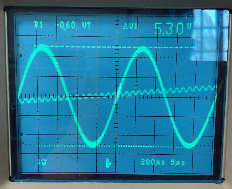

Hi Knee266,
This i what I get.
First trace @200us/div time base shows 1kHz signal on output resistor (8Ω) with 5.3Vpp.
Second trace @5us/div time base shows same signal but highlight the 600kHz part with approximatively 200mVpp. Not null, but ok.
Chris
This i what I get.
Chris

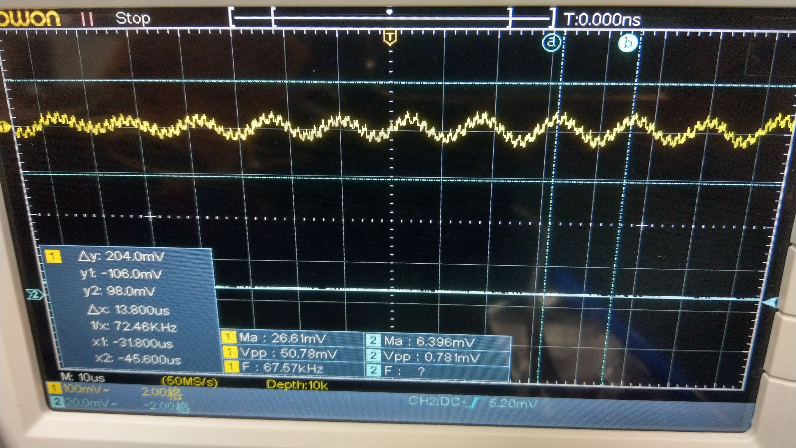

After I using the second L/C filter, the 600KHz carrier amplitude almost disappeared.
But I saw the resonance frequency(70KHz @42mVpp~100mVpp) of the first LC and other carriers on 7xKHz waveform.
Does CLASS D really contain so many frequencies?
Thanks,
Thanks,

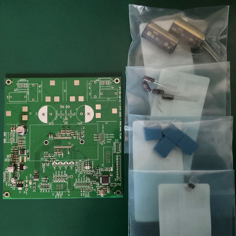

Hi Sebastien
I have a kit available with a board factory populated (JLCPCB) and some additional parts sourced at DigiKey :
PM me if interested.
Chris
- Panasonic FC ecap : 2* 2200uF/50V
- Elna SILMIC ecap : 4* 10uF/50V
- TDK/EPCOS film cap : 4 * 680nF / 1k
- Würth inductor SMD : 1 * 150uH / 770mA / 0.57R
Chris

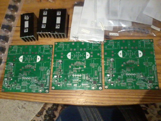

Hello,
the 3 cards are here and components too, missing the TAS3251 and C8 arriving for the end of June!!!!
I started welding some components and I study the datasheet and note. I can't weld all components because I need place to weld the TAS. I'm going to weld some connectors and test supply voltage and wait.
I have customized the heatsink too.
To be continued.....
