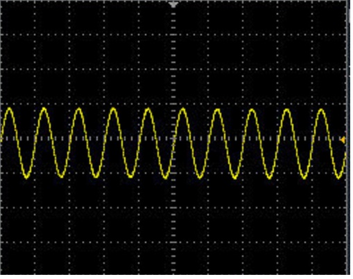

I am about to complete the TAS3251 test, but I found a question with the output:
I input a 1KHz sine wave to I2S of TAS3251 with no EQ mode.
The output A/B of TAS3151 has a 600KHz PWM carrier on 1KHz sine wave.
How do I filter out 600KHz carrier to restore 1KHz sine wave
Attachment: 121923.jpg is 1K sine wave with 600KHz carrier
Attachment: FG-1K-sine.jpg is standard sine wave.
Thanks.

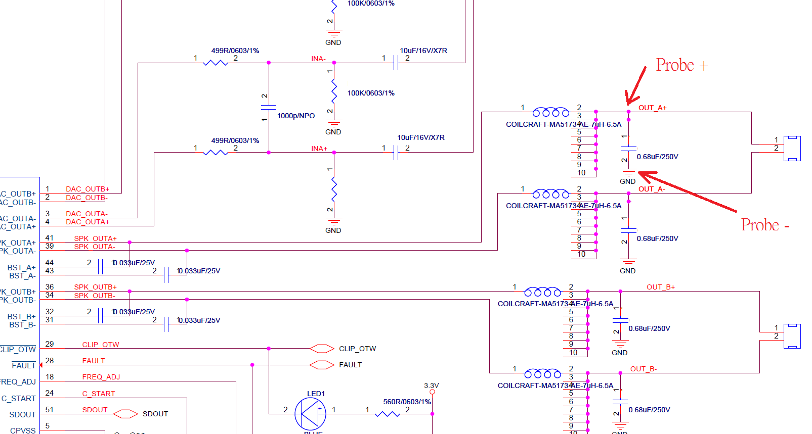

Hello AIM65,
#365, Please refer to the attached probe.png for the position of the probe

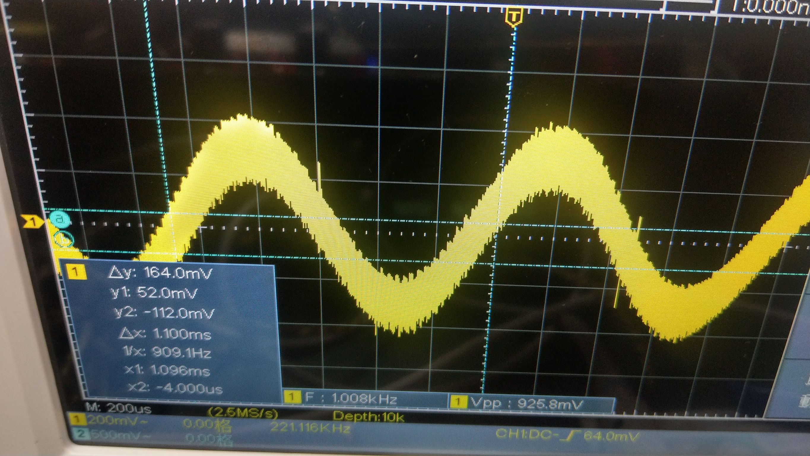

About #368,

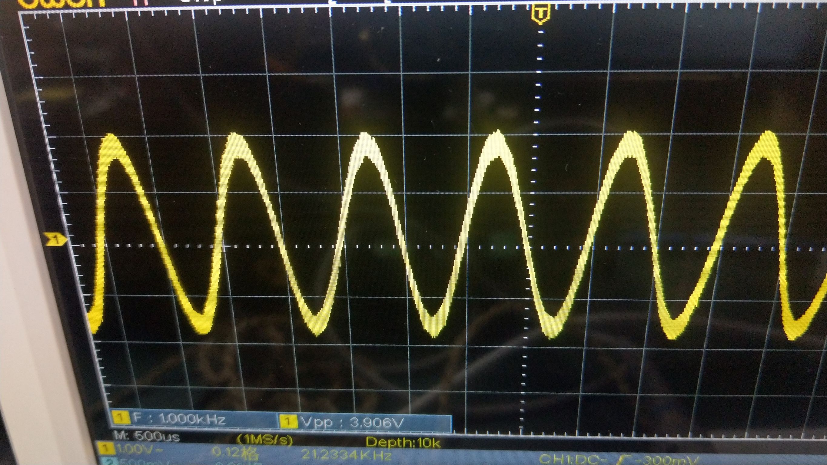

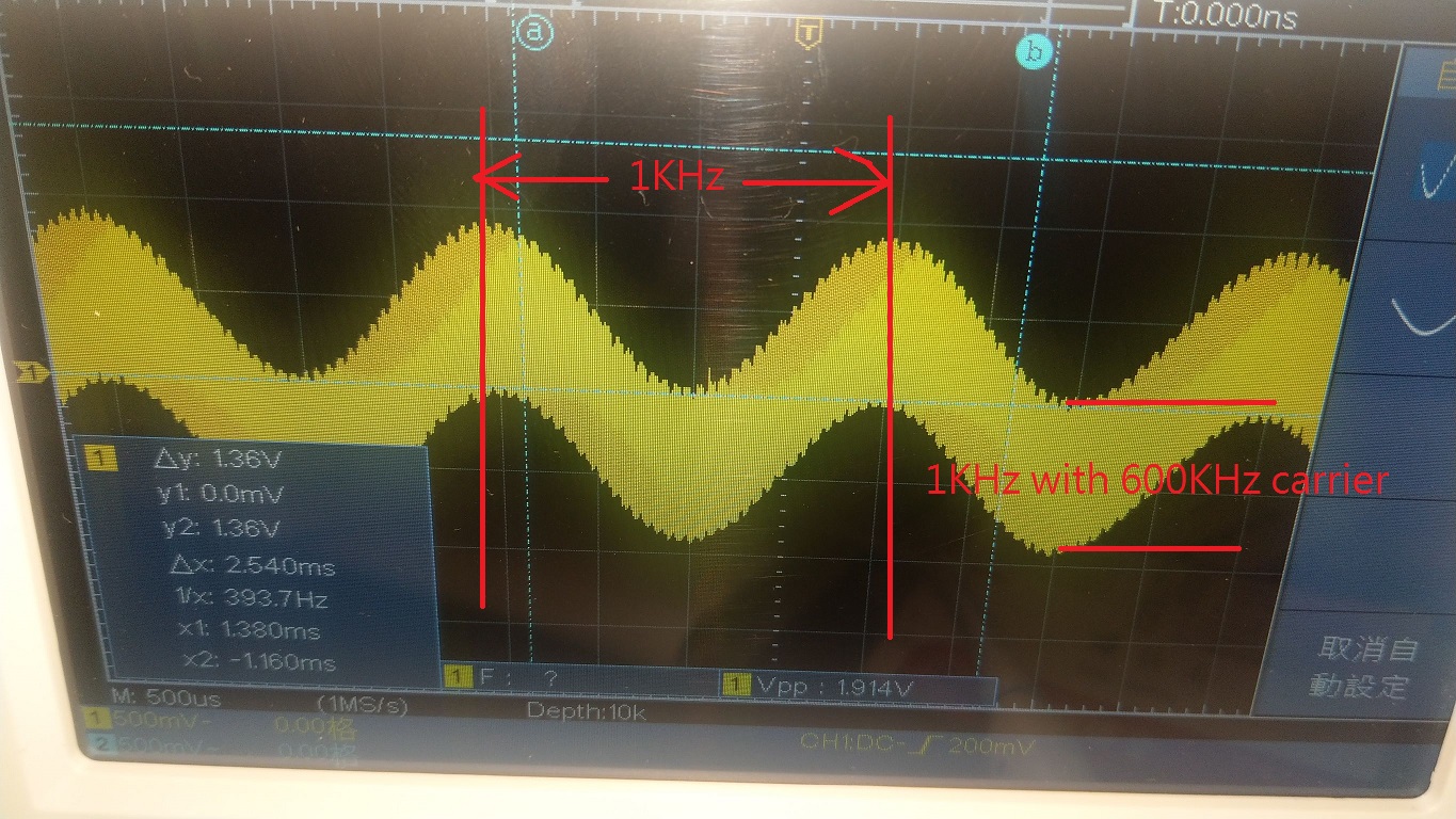

I can already measure a 1KHz sine wave, but because of the 600KHz carrier, the line of sine wave on the oscilloscope is very thick.
If I turn down the volume, the sine wave will be more thicker. I upload the picture for yo reference. (vol30.jpg and vol50.jpg).
I think the output waveform has some room for improvement.

Where is your speaker connected to ?, what are L and C values of your filter ?, what is L model and manufacturer ?, can you post a picture of the pcb ?
About vol30 and vol50 pictures, sorry to insist, but those are not measurement made according post #368. Could you connect scope channel 1 probe to OUT_A+ signal, scope channel 2 to OUT_A- signal and scope gnd to map gnd; then align trace zero level then display channel 1 minus channel 2 ?

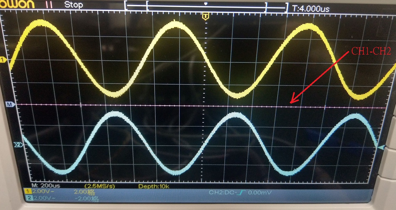

Hello AIM65
The L/C value is 7uH(EPCOS Inc) and 0.68uF (Panasonic) same as TI recommended.
For the waveform of CH1 minus CH2, please refer to the attachment, I connected a 20W/4ohm cement resistor between OUT_A+(CH1) and OUT_A-(CH2),

@knee266:
I think that there isn't any problem. That's totally normal output of a class-d amp.
1. 600 kHz is far out of the hearable frequency range.
2. the connected speaker acts as additional filter for the 600 kHz carrier.
3. To verify if the output LC-filter is working correctly, calculate the attenuation of the LC-filter and measure the ripple with the scope...

Hi Knee266,
What matters is the voltage seen by the load resistor, this voltage is (VoutA+ minus VoutA-). You should set your scope to display the results of the function (channel1 - channel2). We expect a single trace, not two. Do not forget to align the zero of the two channel, both should be AC coupled.
All scopes do this basic math function, usually you invert channel 2 then add the two channel.
Correct me if I'm wrong, but on the screen, I see channel 1 and channel 2, not their difference. They are phase reversed, which is as expected as amp is bridged (BTL).
Once you'll have the voltage seen by the load on the scope, you'll be able to measure de HF ripple and confirm your filter is ok or not. It's fc is close 73kHz
