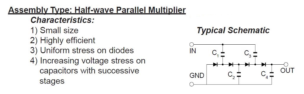

Multi-stage voltage multipliers are not difficult to construct. I'm uploading a schematic "swiped" from VMI that's highly illustrative. The graphic is for a positive PSU and we're dealing in negative voltages. So, stand everything on its head. Tapping a multiplier in different places should (IMO) be self evident.
