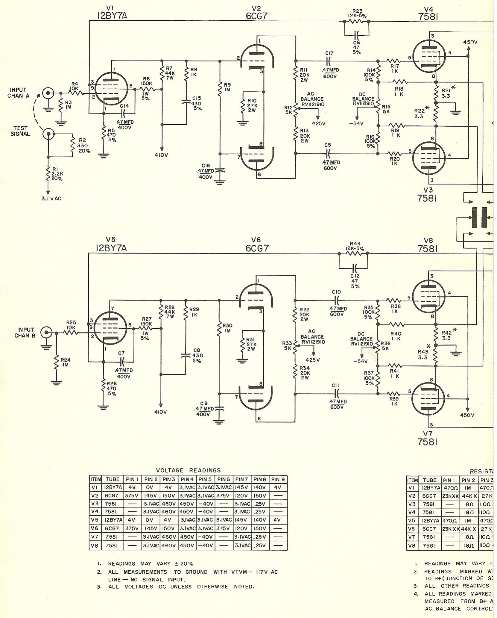

i will build anything but what do you mean by cit.5 copy with a really good psu?
if you mean values other then on the schematic.
in the end i want to get this going. everything has to be ordered so lets get a design with values stated and build something.
harman kardon citation 5....
eico hf-89:
http://sanacacio.net/hifi/hf89schematic.jpg
you can give these vintage amps a modern twist, like a CCS instead of a resistor in the tail of the LTP phase splitter....and if you can hunt down the opt irons, then that will be very good...
eico hf-89:

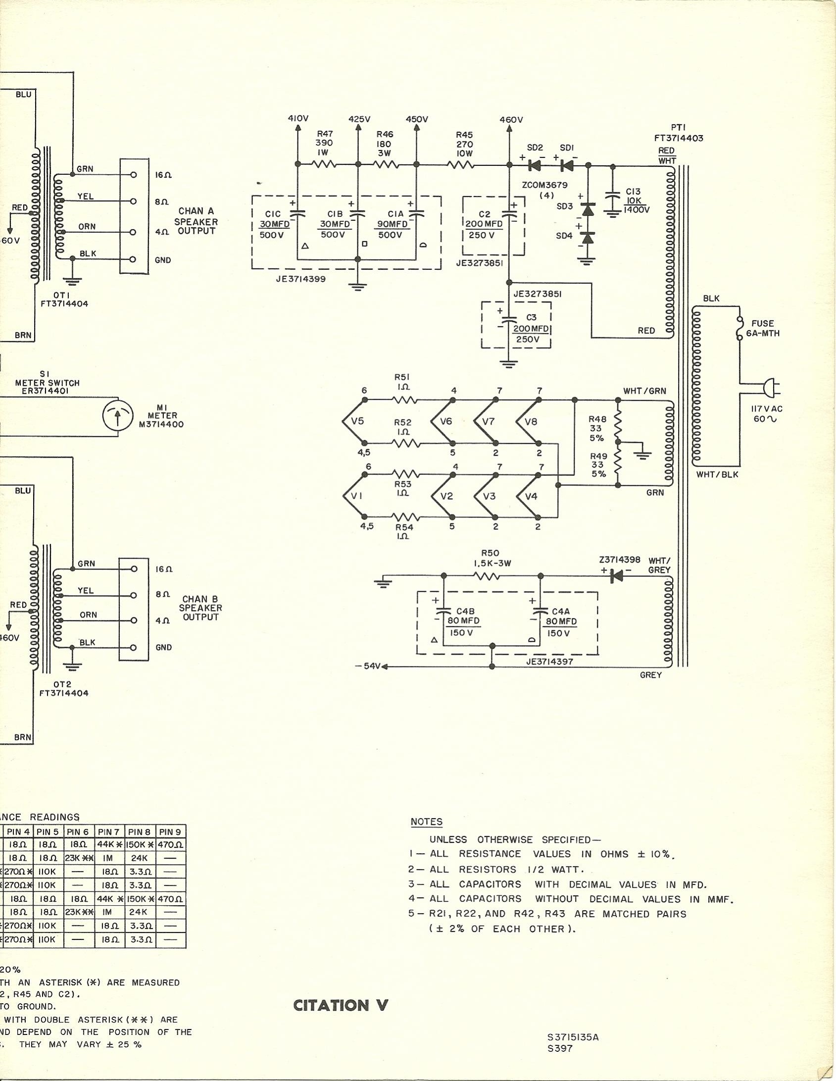

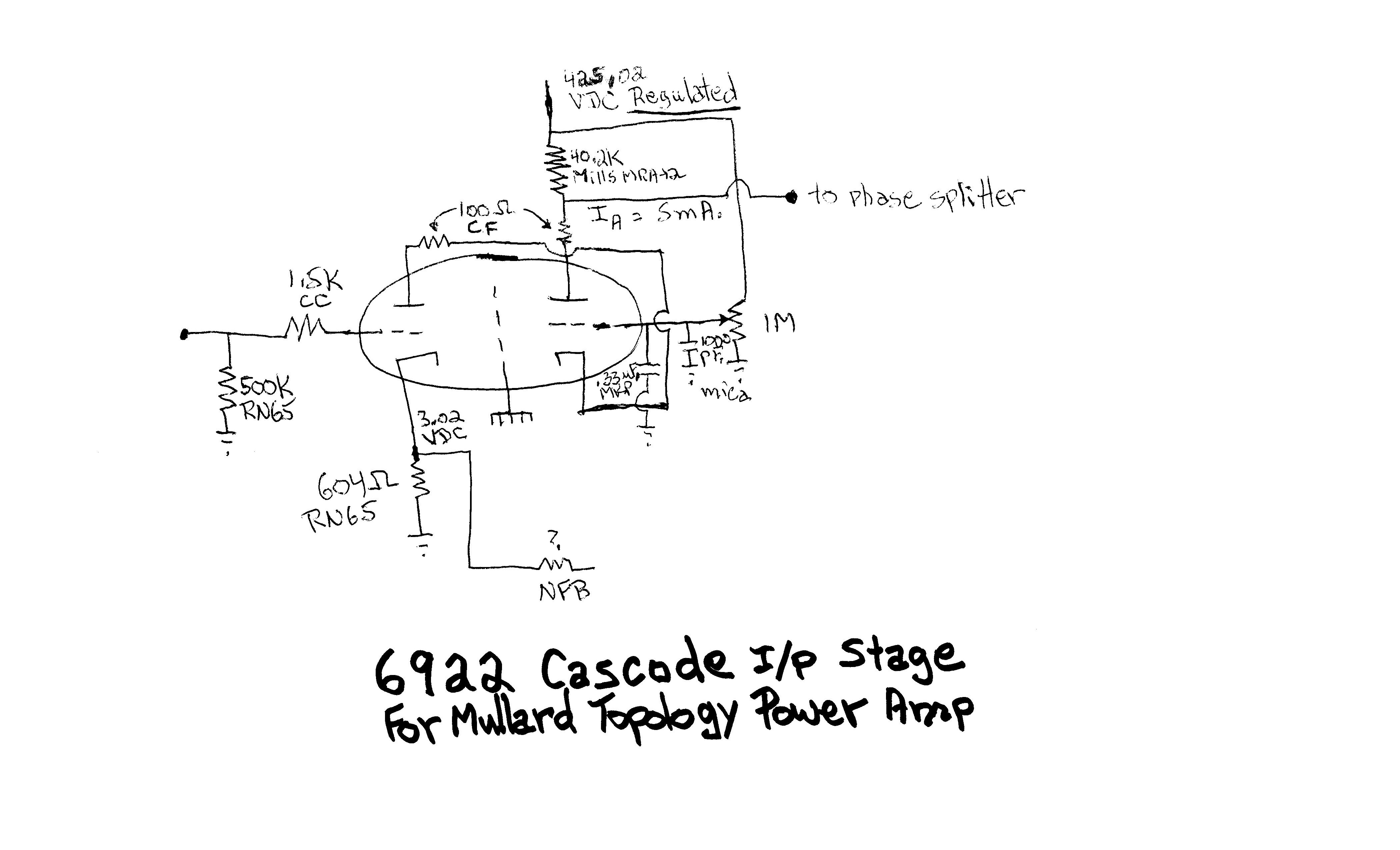

"i will build anything but what do you mean by cit.5 copy with a really good psu?"
We can go the monoblock route. Better diodes and caps. are available today than H/K was able to source/afford in the 1960s. H/K left a choke out of the Cit. 5 PSU, but we will not. The Cit. 5 was the low priced amp of the tubed Citation line. The Cit. 2 was the "balls to the wall" model, but getting the "iron" of the quality used in the "Deuce" today will cost you both money and body parts. 🙁 An Antek AS-2T350 power trafo in each monoblock will provide ALL the cojones needed and then some. Can't beat AnTek prices! We will bridge rectify the B+ with "noiseless" Schottky diodes.
You already know the Hammond O/P trafo to be used. Stay with the Hammond theme and use 1 of their 159T chokes in each chassis.
Time find a Canadian Hammond dealer with the best prices and order the O/P transformers and chokes. Order the power transformers directly from AnTek.
We'll deal with diodes, tube sockets, and passive parts very soon. The only possible additional "iron" that could be needed would be associated with negative rails and we might be able to voltage multiply 1 of the AnTek toroid's 6.3 VAC windings to satisfy that need.
I previously uploaded the voltage amplifier schematic.
A "modern" improvement for the LTP phase splitter is to constant current sink (CCS), instead of resistively, load its "tail". A 10M45S integrated circuit is quite adequate here.
Remember what I said about high gm and slew limiting. The 6CG7 will be changed to the higher gm ECC99.
Great! Configure the O/P "iron" for 8 Ω and don't look back. 😀 The amps will have a respectable damping factor. Of course, we can't match the "monster" numbers possible with "sand", but voice coil control will be quite satisfactory.
ok perfect these x2 done!
all this above stuff not a clue what you speak of
but no worries we will get there
progress brother...yeah
Tony,
The only Cit. 5 schematics to trust are the left/right originals. I'm uploading them again.
Yes. The SAMS Cit V schematic has a major error in it. You can see the correction on my site: http://www.mcshanedesign.net/adjust5.htm
I second Eli's idea of a Cit V clone. Also, if you want to you can use a 6CL6 to replace the 12BY7A if you decide not to use Eli's new front end. The 6CL6 pins out differently, but that's no problem for a DIY build.
If you have enough heater current capacity you can run the superb Genalex reissue KT66 tubes in them too - that's a really nice tube.
