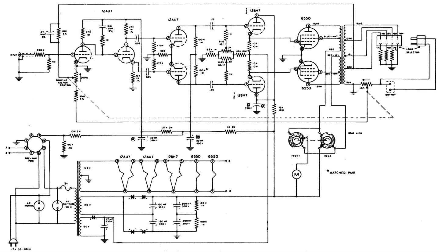

The capacitor after the CL-130 might be a bit large for it. The data sheet recommends 145uF max when the supply is 240 vac. Maybe the CL-180 would be better. C max = 400uF at 240vac.
http://www.farnell.com/datasheets/85914.pdf
On the other hand, it might be fine. I don't have direct experience with these devices.
Also, the middle capacitor looks a bit too small to really be useful. I'm not sure what your intention is with this value.

You have to look at the max. current allowed through NTC thermistors, in this situation. It's highly likely, in this case, for the device to run relatively cool and continue to introduce some resistance, in the "steady state". While the B+ rise delay introduced by the thermistor is small, it's enough to allow a SS rectified bias (C-) supply to turn on, fully.
The 1.5 mH. RFC and the 1000 pF. cap. comprise a "hash" filter. The "hash" filter suppresses HF noise riding on the B+ rail, regardless of said noise's origin. Such HF noise could sneak into the reservoir cap., via the main filter choke's winding capacitance. A more "black" background is the result of installing a "hash" filter.
BTW, large valued cap. I/P filters are inherent "hash" generators. Look at the ripple current waveform and apply Fourier's Theorem.
@Eli, you posted a "new" scheme to my eyes, will try it in my next build.....in my case, will usually start with smaller cap as first cap and then make the last cap the biggest...
Don't use a large valued cap. at the I/P of a CLC filter, when the power trafo is not "hefty". Trying to pull more than 50% of the rectifier winding's rated RMS current is asking for big trouble. The bigger that 1st cap. gets, the worse I2R heating in the rectifier winding becomes. Also, the bigger that 1st cap. gets, employing a "hash" filter becomes ever more important.

Eli,
It might be here but I have not found it.
Where in this circuit (Cit 5) does the I/P roll off occur
at under 30Hz?

GKF,
Frankly, I don't think you will be happy with the no better than marginal MK3.
Most, if not all, of us here face budget realities. Quite nice results can be obtained from Mullard style circuitry and decent, if unspectacular, O/P "iron". IMO, the best "vintage" implementation of Mullard style is the H/K Cit. 5 (schematic uploaded). The Cit. 5 does use high gm small signal types.You could "copy" the Cit. 5 around Hammond 1650P O/P transformers. Roll the deep bass off just below 30 Hz. at the circuitry's I/P, to protect against core saturation. Please keep in mind that the lowest note a "standard" double bass plays is 41 Hz. 😉
The 12BY7 the Cit. 5 employs as its voltage amplifier is out of production and, IMO, the available stock should be reserved for amps already in existence. That fact set is really a non-issue as I've uploaded a 6922 cascode voltage amplifier schematic that's specifically intended to dispose of the matter. 😀
We are looking for the 30Hz cut off? or
we could look at it like a hi-pass at 30 Hz.
If I recall the math should look something like this:
Fc=1/2PiRC, 270 Ohm resistor, 100uF (2 x 200uf in series)
fc= 1/ 6.28*270x.000,100
fc=1/1,695.6*.000,100
fc=1/.16956
fc=5.9Hz
So we just high pass at 5.9 Hz?
Or roughly 10 times less than the power frequency of 60Hz.

PSUD2 does a marvelous job with the math. It's a free download and it's fun to tinker with. A large capacitor coming out of the bridge isn't necessarily a bad thing if the DC resistance of the transformer secondary is enough to limit the turn-on surge current through the diodes to their design value.
