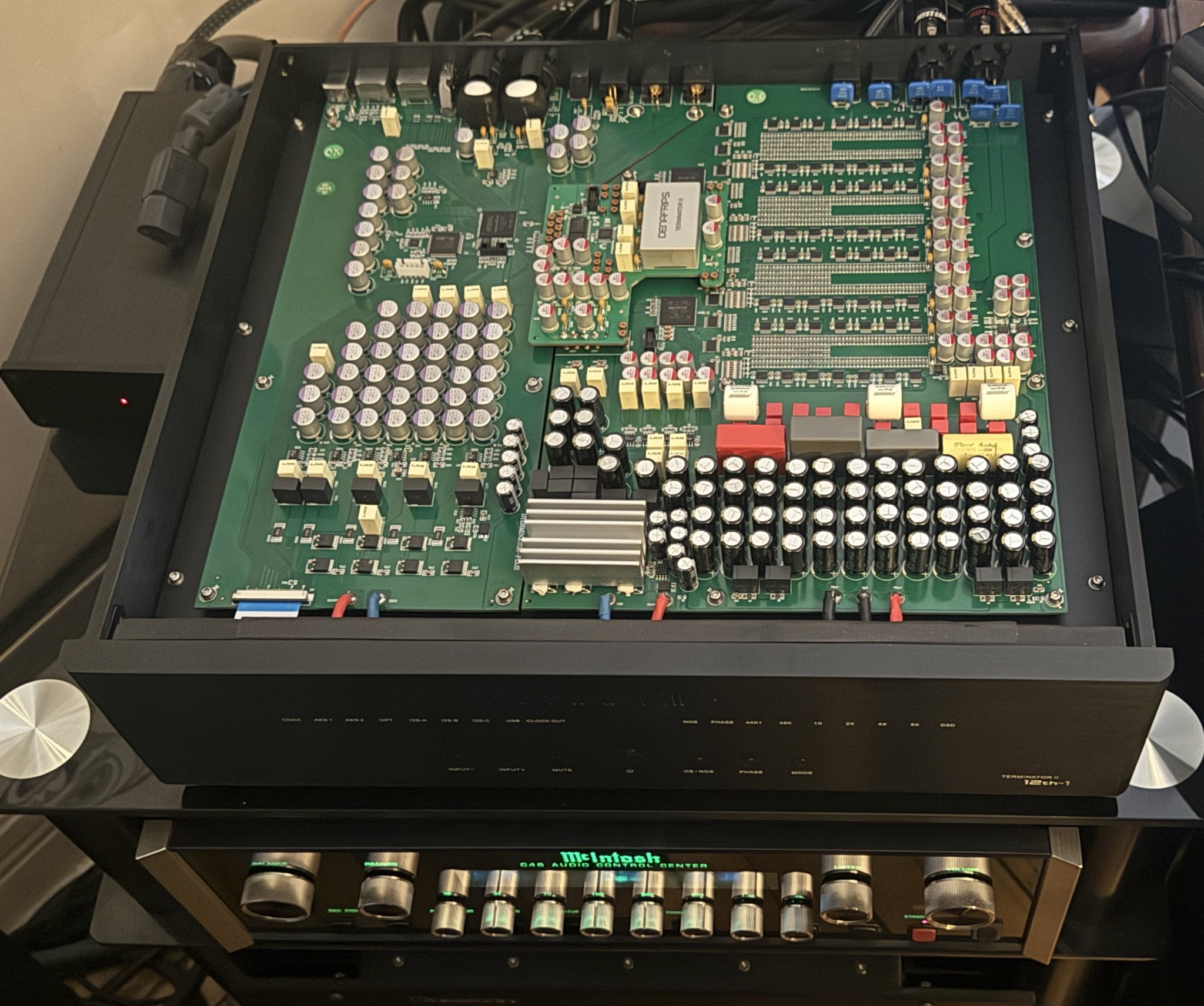

Well after the time since initial power-up, the improvement is unmistakable. Accuracy, transparency; this is the way it should have been. 100%.

Nah , you're more into stratosphere than most here 🙂 Nice, clean job with Denaphris. I only mentioned Mcintosh because I've "been " inside a few fairly modern pieces and the exterior is far more illustrious than interior. I have nothing against the brand. Well , one can't hold it against them that a lot of people buy it becuase it holds value rather well. Just like Rolex.

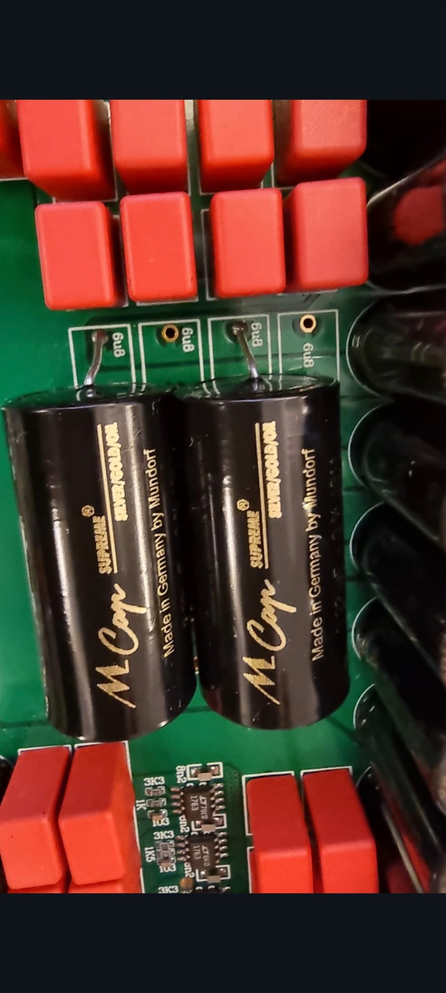

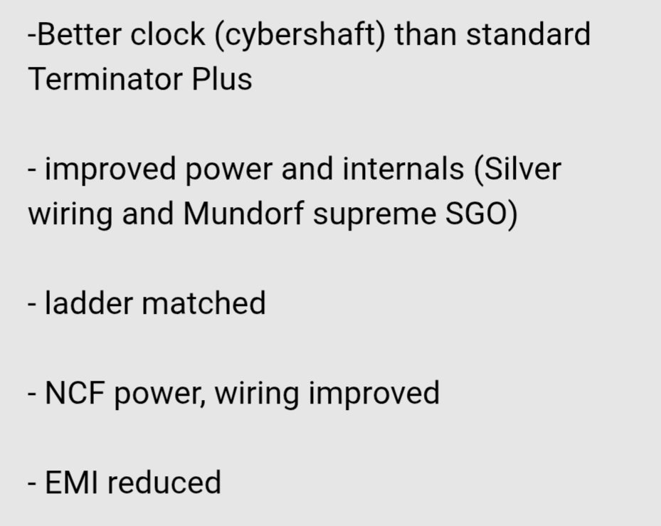

Go to Korea Digituslab Electronics who also sells Taiko Extreme and get long available since 2 yrs ago in my system that is customised and bench tested Terminator Plus DE with the following highlights and yet with full factory warranty at usd12k that trickles down to 12th and 15th anniversary versions ... in parts.

Hi, they are all real deals ...wima, mundorf, laser trimmed resistors etc. Denafrips products are simply VFM one cos built as Chifis and does not have CEO, CFO and minimum wages to struggle with. Cheers.

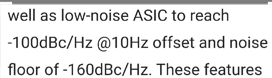

Interested to know more about this cybershaft clock, and great move with the Mundorf SilverGold wire for power, the power section is still on my list to do, put it off because of the disassembly. I think stock wires are stranded tinned copper, maybe silver plate, but there was talk of them actually being silver, which they are not. Seems these guys also recognize quality over quantity approach on the power bank with the SGO addition, I chose smaller value SGO Evos for mine, probably similar result. I'd be interested to know if they sell this upgraded clock module, that would be a nice touch.

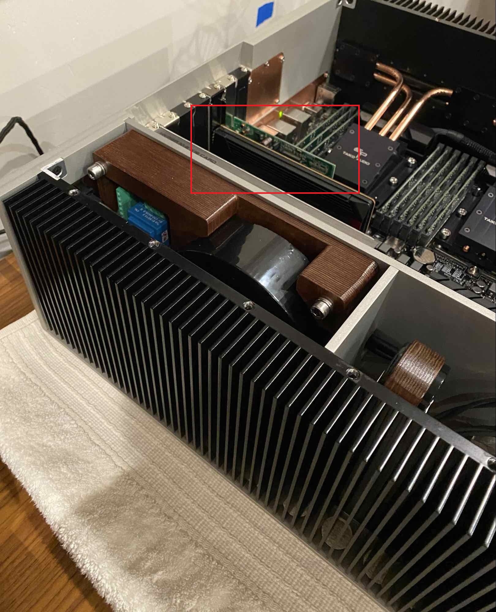

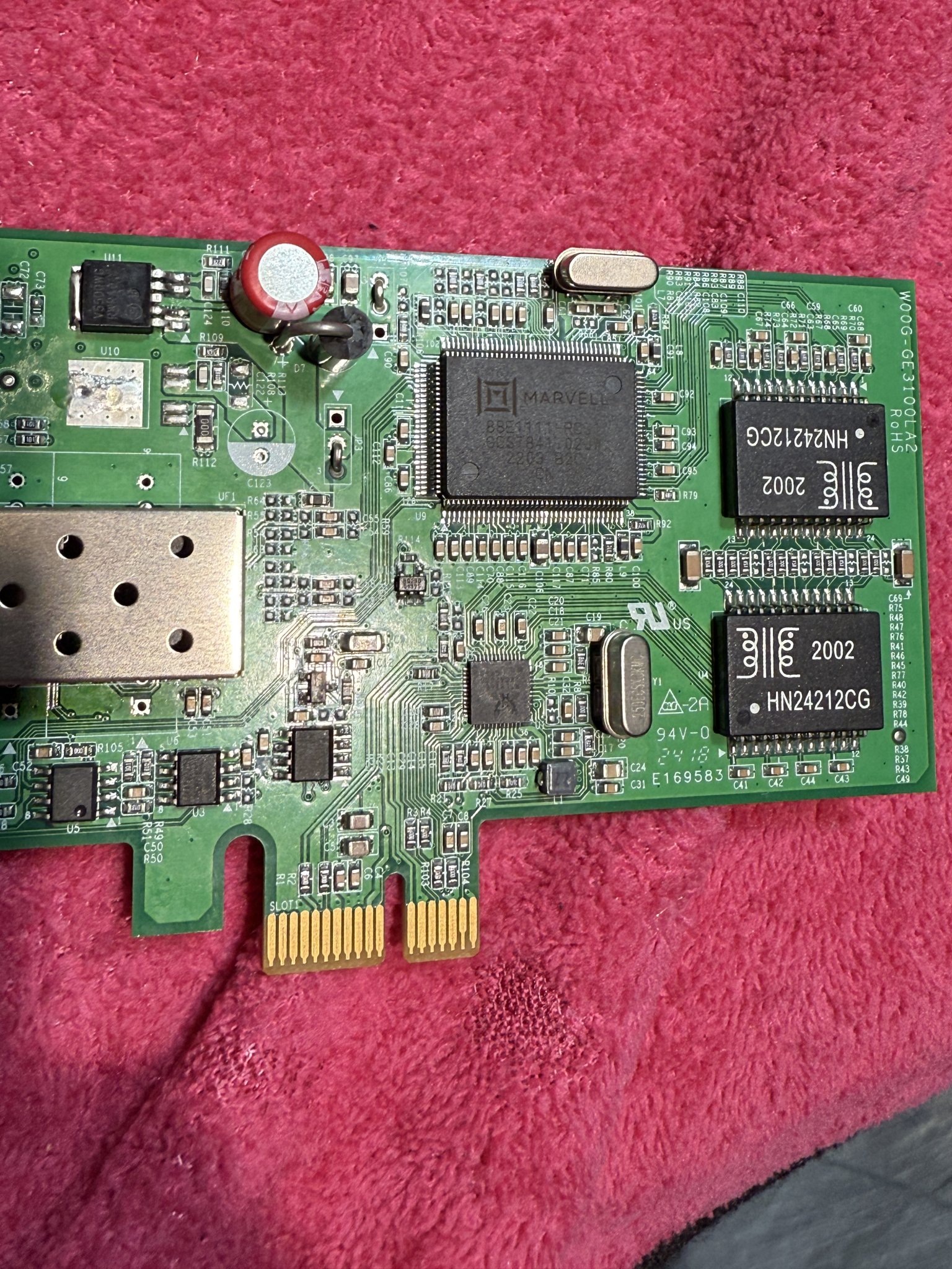

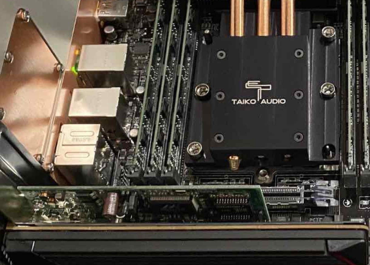

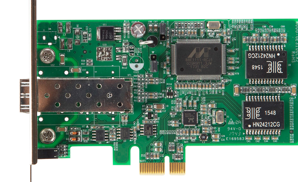

Interesting you mention Taiko Extreme. I use a computer as a primary source and have been experimenting with different NICs, astounded by the sound profile differences between them. So far I really enjoy the Intel 210/350 cards (SFP) which have a very high degree of detail, transparency and accuracy. I am using a Realtek variant as Itype this, I am currently burning in after some component changes, the StarTech PEX1000SFP2, which is the same card used in the Taiko Extreme (Taiko used stock card, really cheap filter cap..):
Modified Realtek RTL8125B (PEX1000SFP2) Parts List
Component Upgrades
  • Voltage Regulator: Stock SOT-23 → ON Semiconductor NCV5500 (ultra-low noise ~6.5μVrms)
  • Main Filter Cap: Stock 22µF electrolytic → Würth 47µF polymer (ESR + value upgrade)
  • Clock Crystals: Stock → 10ppm precision replacements (TH modified to fit)
  • Inductor: Stock SMD → Bourns low-DCR inductor
  • EMI Reduction: LED components desoldered (switching noise elimination)
Key Points
  • Same Realtek RTL8125B chip used in Taiko Audio's €28k Extreme server
  • Sound signature: More musical/warmer vs Intel's analytical presentation
  • Burn-in assessment: 2-week possible evaluation period needed based on component settling
Context
  • Compared against Intel i350/i210 (all SMD ceramic, no through-hole components)
  • Part of systematic network infrastructure optimization in reference audio system
  • Taiko validation: Professional audio company chose this architecture for flagship product
