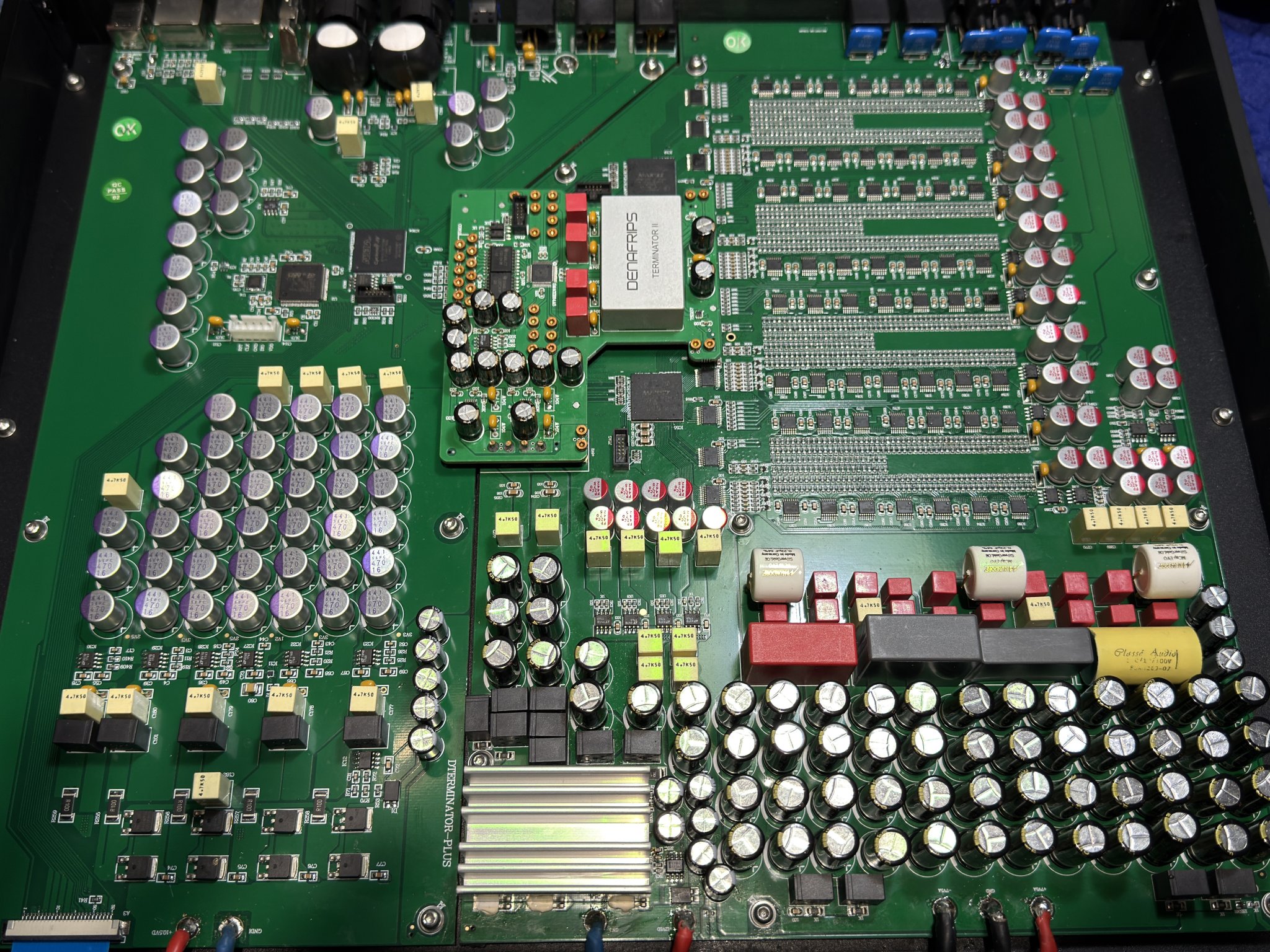

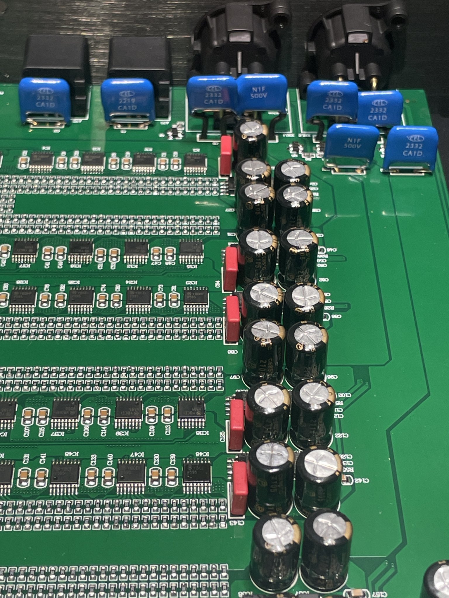

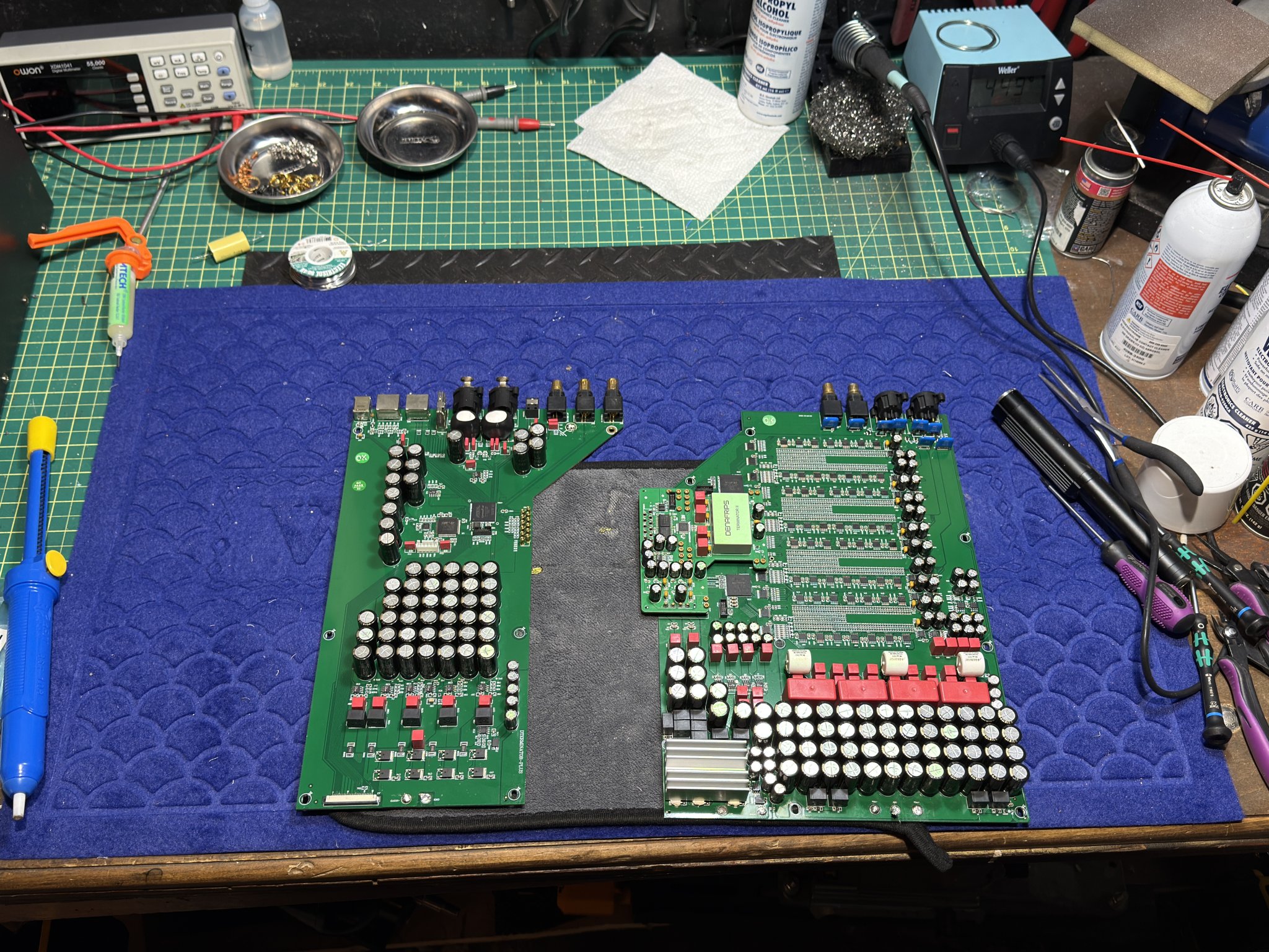

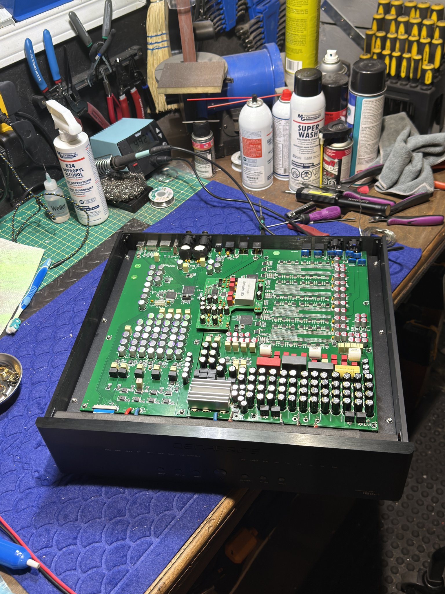

Thought I'd share how I finished the job on the Terminator II. Complete re-cap, OS_CON complete on the digital board, Kemet MKT 4.7uF with 100pF MLCC NP0 as bank bypass cap combos. MLCCs used elsewhere - complete removal of all "Elna Silmic II" and "WIMA" MKS. Nichicon RNU on the ladders, Panasonic FM-A on the analogue side bank. Mixed cascaded MKP augmenting the electrolytic bank - of course we still have the Mundorf SGO. I guess I might be one of the few to actually hear a Denafrips Terminator II the right way, it was worth the desoldering marathon and cooking away - a month of burn-in to go...
Completed full-scale replacement of approximately 130 capacitors throughout the T2, addressing every critical subsystem with premium components selected specifically for their application:
The upgrade represents a comprehensive approach targeting every significant weakness in the original design, creating a unit that should exceed the performance of even Denafrips' premium models through both component quality and optimized engineering approaches.

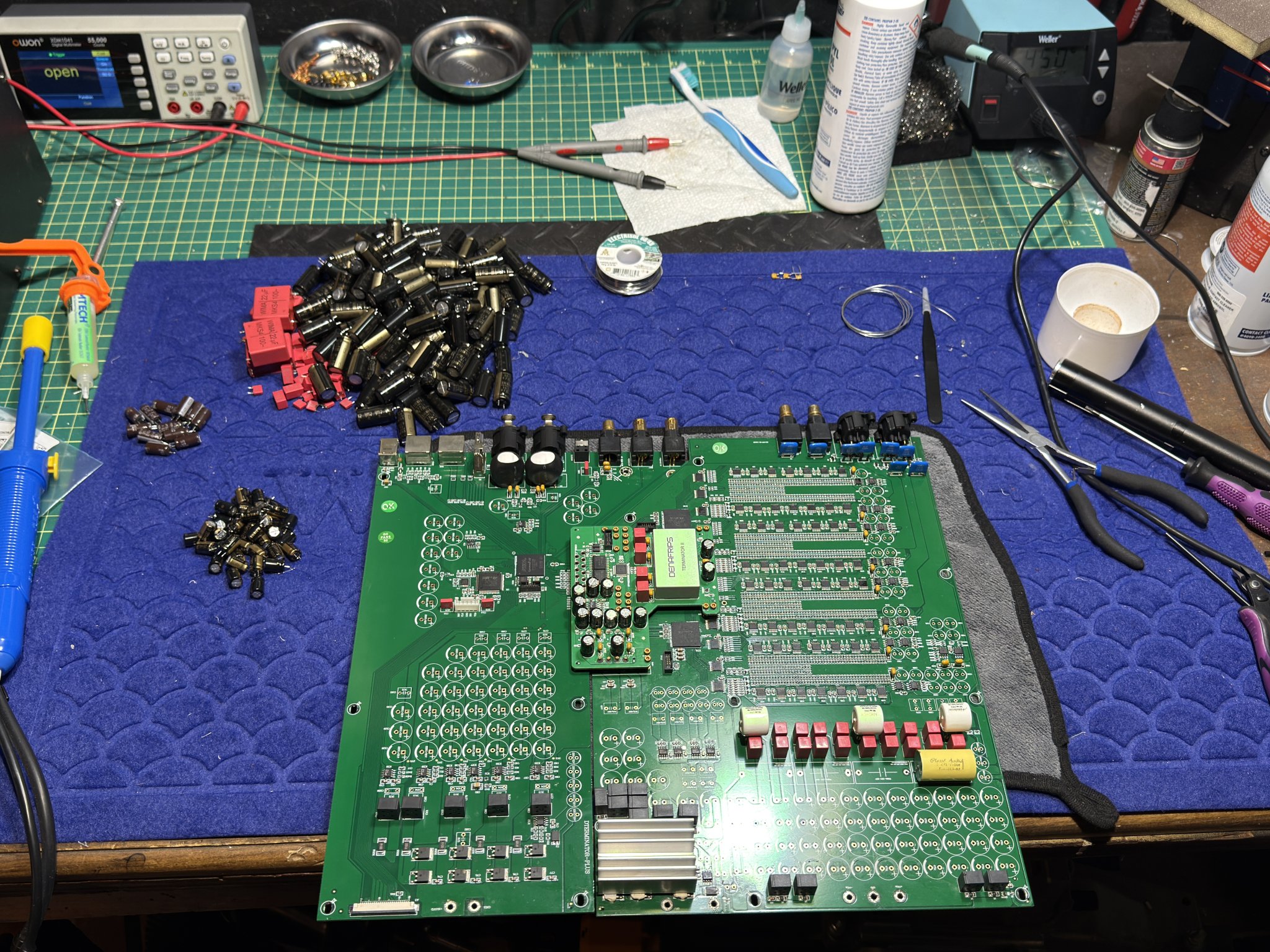

Project Scope:
Key Technical Findings:

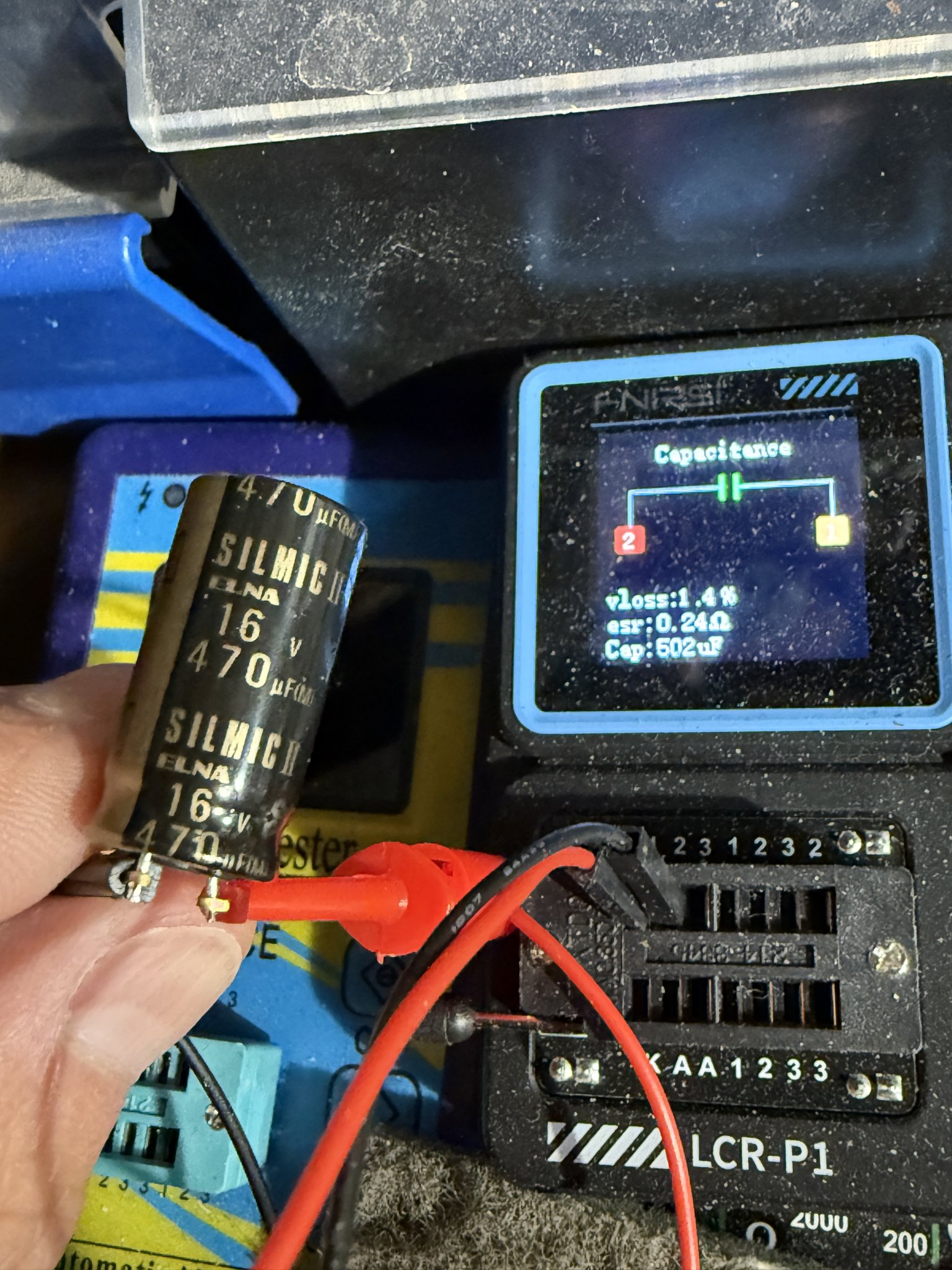

- Original capacitors tested as counterfeit "ELNA" and "WIMA" components

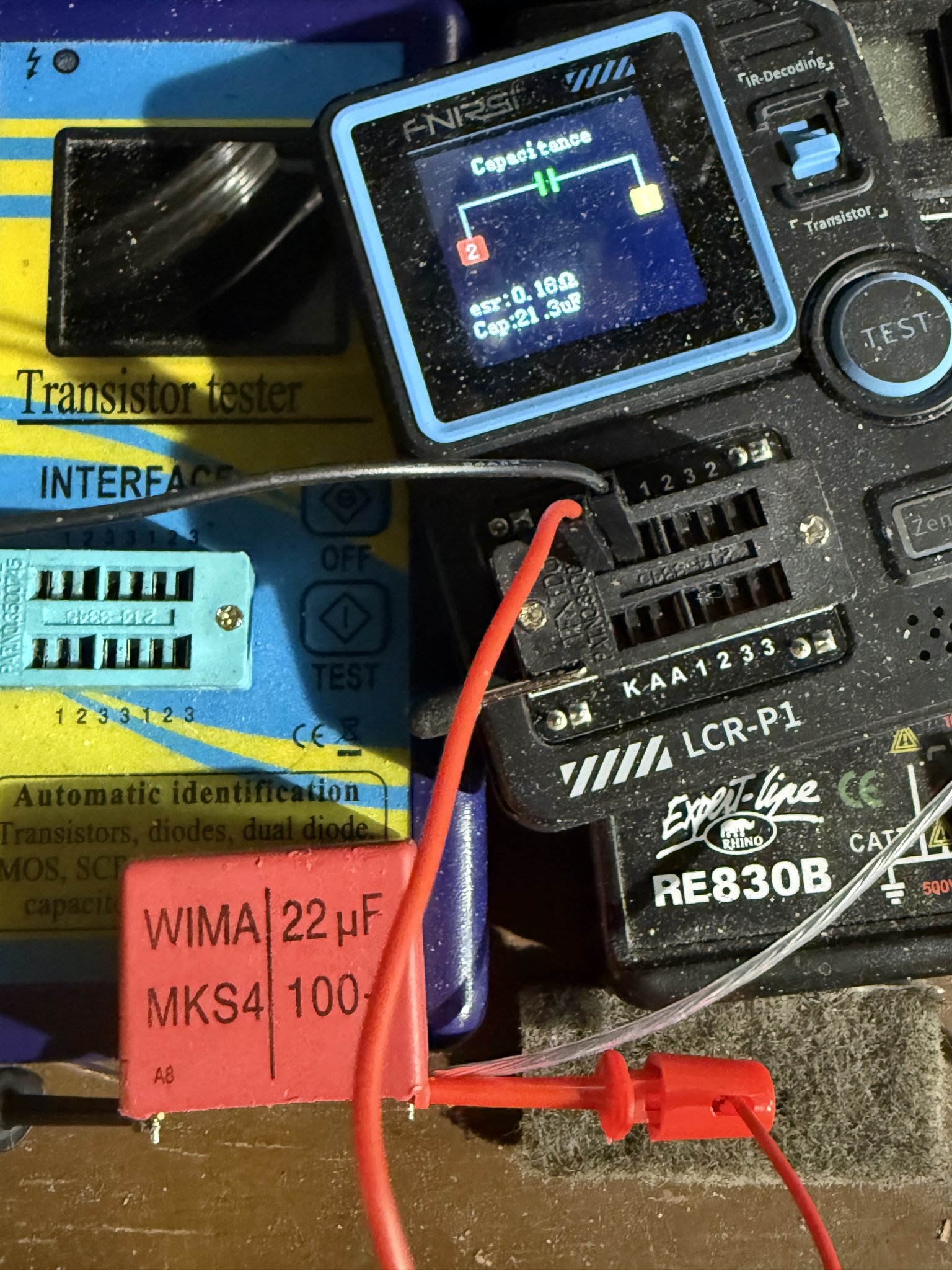

- Measured ESR values of 0.23-0.8Ω on fake film capacitors (vs 0.01-0.03Ω typical for genuine)
- Evidence of deliberate performance limitation through component selection
- PCB silkscreen showed 3.3μF design intent, while installed values were 0.1μF
Component Upgrade Strategy:

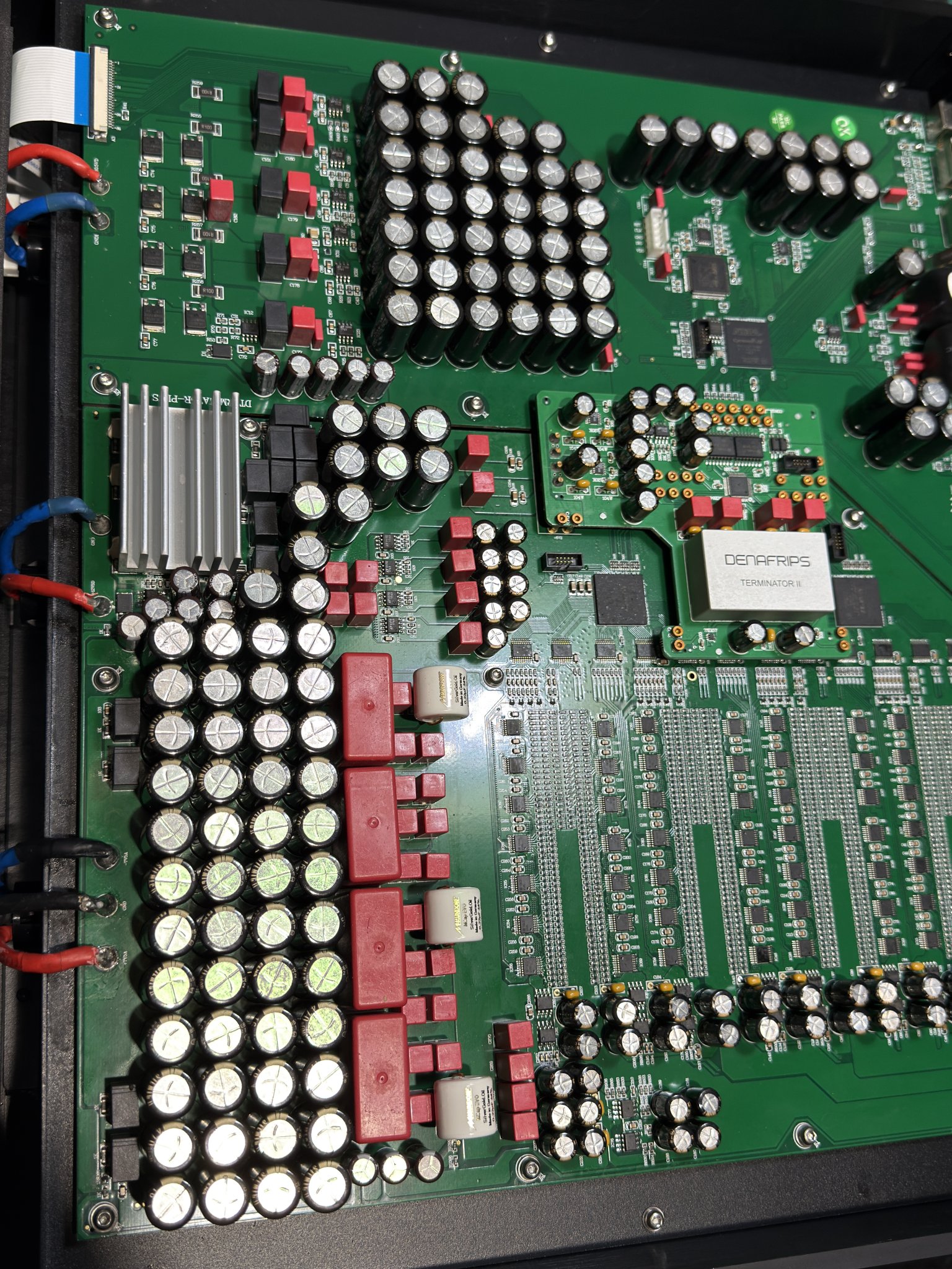

Digital Power Section:
- Replaced generic electrolytic bank with Panasonic OS-CON polymer capacitors (16SEPC470M)
- Implemented high-frequency MLCC NP0 bypassing for FPGA power
- Created progressive digital filtering using varied capacitance values
R-2R Ladder Power:
- Implemented Nichicon RNU polymer capacitors (47μF/25V, 24mΩ ESR, 3.6A@100kHz ripple)
- Optimized high-frequency power delivery with KEMET polymer caps

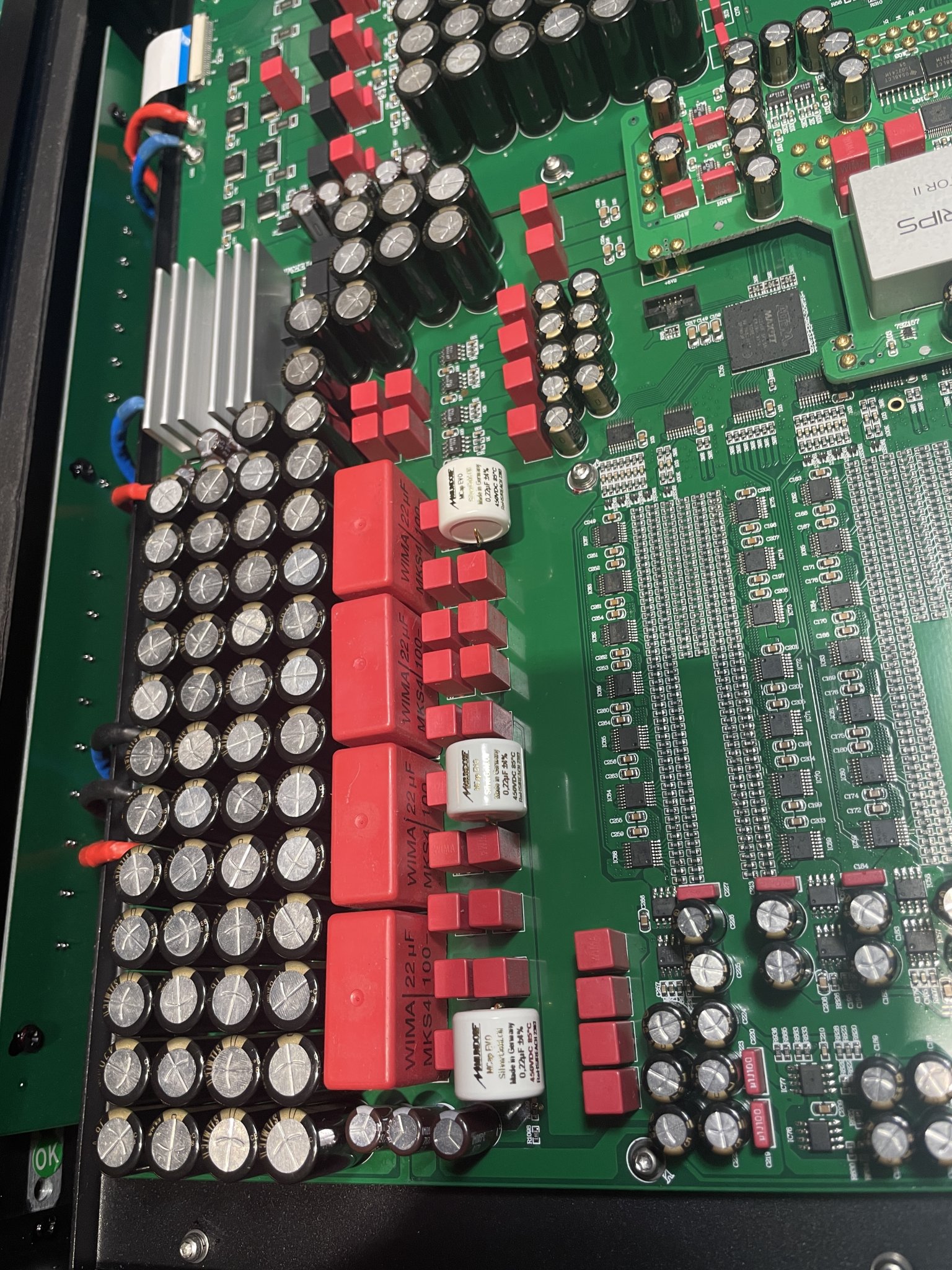

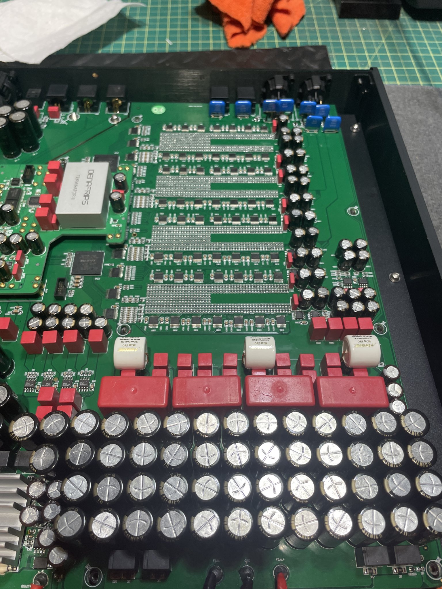

Analog Signal Path:

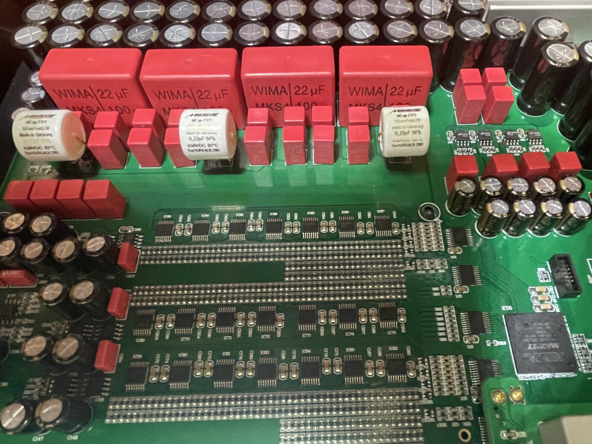

- Replaced four identical "WIMA" MKS with progressive staggered capacitor array:
- 22μF KEMET MKT (low frequencies)
- 12.5μF KEMET MKP polypropylene (mid-low frequencies)
- 6.8μF Würth MKP polypropylene (mid-high frequencies)
- 1μF Classe MKP (high frequencies)
- Retained three Mundorf Silver/Gold Oil 0.22μF for critical high frequencies
Analog Output Stage:
- Upgraded to Panasonic FM-A series (19-28mΩ ESR, 1.635-2.18A ripple)
- Implemented Nichicon UHV for 270μF requirements
- Added KEMET premium film capacitors for bypass
Technical Design Improvements:
- Eliminated resonance issues through staggered capacitor values
- Created complementary filtering across frequency spectrum
- Optimized ESR characteristics for each application
- Hard-soldered critical clock power connections
- Improved high-frequency noise rejection through strategic bypassing
Current Status:
- Unit is functional with initial break-in underway (~24 hours)
- Bass performance showing first signs of improvement
- Full break-in expected to take 3-4 weeks due to extensive polymer capacitor count
- Expecting progressive improvement in detail retrieval, spatial characteristics and dynamics

any thoughts on the denafrips board sitting on top of the o core transformers and whether metal shielding on top of transformers is effective in blocking emf/rf noise ?
Well, I have thoughts, others I'm sure do as well. I think the chassis design and shielding is significantly better than most. While underneath, is it separated by two sheets of the finest in Chinese sheet metal, many units don't come close to it in a one-chassis design. Again, it's not the designs with these things, its the execution in my opinion - parts. I'd be more inclined to replace the wire out of the LPS and address parts within the PSU with as many North American equivalents as I could than worry about the shielding, they did a very good job with that.

I remain uneasy of wound capacitors like these in the vicinity of high-frequency logic circuits, as they are antennas.

My cautious side suggests the analog end could possibly pick up the digital, even from one side of the case to the other. It might be worth probing with an oscilloscope.
Sometimes, a bit of series resistance in a capacitor can help damp what might otherwise become a resonant circuit. The big thing with wound polypropylene capacitors is the windings can vibrate and they rarely can a metal can to shield them. The Wimas, by comparison, are usually flat stacked and have minimal pickup, particularly in one orientation.

If this is true* (that device is not exactly low cost Aliexpress stuff) replacing the fake film caps for original WIMA caps could heave been sufficient. There is really nothing wrong with real WIMA caps not even their MKS2 series. Despite all the flak they get from audiophiles many use these and the Kemet ones to great pleasure. They perform the same.Key Technical Findings:
Also why choose axial 450V caps with way too long lead wires for this low voltage application? You need radial caps and straight to PCB mounting. Maybe the device even measures worse this way.
*Are you sure your measuring equipment is of good quality? It seems Aliexpress stuff, certainly the 29 Euro LCR meter.
OK, I will take this into account next time. Please consider using the cap with its outer foil wire connected to the lowest potential. That way the cap will use its outer foil as shielding.

I'll hazard a WAG that with the pulled "fake" parts you used the clip probes and for measuring "real" parts you inserted them directly into the LCR-P1 because you had full leads. You provided photos of the measurements of the "fakes", but you seem to have conveniently left out any evidence of the "control". I could be wrong (and I often am) but an engineer such as yourself would want to be thorough before tossing out serious accusations, wouldn't you? If you did in-fact measure them using an identical process, you'd also want to take into account that the ESR of these capacitors increases over the component's life. How much of a delta did you allow? You did not state the number of hours on the unit. Your findings / readings may be correct, but the explanation for how you came to such a bold conclusion and the methodology for determination is lacking.
