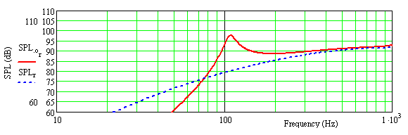

I just looked at this implementation with the Aura 3 inch driver and came to the conclusion that with the information given, no one but the designer of this speaker can be sure if it’s a good design regardless of what is said here above.
I’ve designed with more than 100 of those drivers in many different enclosures but I never came up with a dimensioning that is even close the suggested one.
There is a spread in sample data that should make difference if used, but I believe not as severe to be a coincidence and fitting this Delsol-box.
This box suffers from a huge peak close to 90-100 Hz with my T/S data and is under dampened with no control from the port back to the driver, thus the driver is as in IB condition.
I’ve tried both port lengths it makes no difference.
When tested in a ported box simulator, MJK: s ‘of course’ and only the box volume, driver position and the inner port were simulated, I immediately saw that the box must ’?’ be defined in a sort of very simple reflex box simulator because now the port was controlled as should be, but still severely peaking at about 110 Hz.
By the way, there is no way to use programs like WinISD or similar to predict the Delsol speaker other than what I just commented in my reflex box simulation test.
As no simulations or measured performance is shown anywhere ‘?’ for this speaker project other than hearsay.

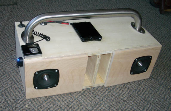

One more thing before I finally build these things...Does the front have to be curved like that or is it just for aesthetics? Can it be like your boom box is?
This question, I think is quite superfluous and I recommend; don’t build this box until measured FR data or a simulation with all simulation data is available.
Is there any possible rescue to implement?
Yes, by either use driver acoustic dampening or by the use of derived closed or reflex box methods like: closed box leakage dampening or dampened box/dampened vent and even the use of a BBC method, the double cavity vented box where if an acoustic resistance is the box divider, no notch will occur on the FR curve.

I wouldn't jump to conclusions with the T/s parameters alone. After all, the manufacture states that there is a tolerance of +/- 25 percent...or atleast that is what has been discussed in this thread. I dont like using graphs for all my conclusions. I rather go off someone who has actually built the enclosure and go off of his opinions....A simulation can only go as far as the accuracy of the parameters...

The front is curved for aesthetics. Use 1/2" BB ply for the front baffle, planet10 is right MDF is inferior here.

From the first post in this thread -"I present this as an experimental starting point, and welcome suggestions."
I don't design by simulation. I build and test.
In designing this driver, I reduced box size as much as possible, while maintaining a good sound. Using larger boxes can give better results with this driver.
While far from a severe problem, You are correct this box may benefit from more damping. I'll let everyone know when I find an improvement that doesn't kill the life that the sound in this box currently has.
