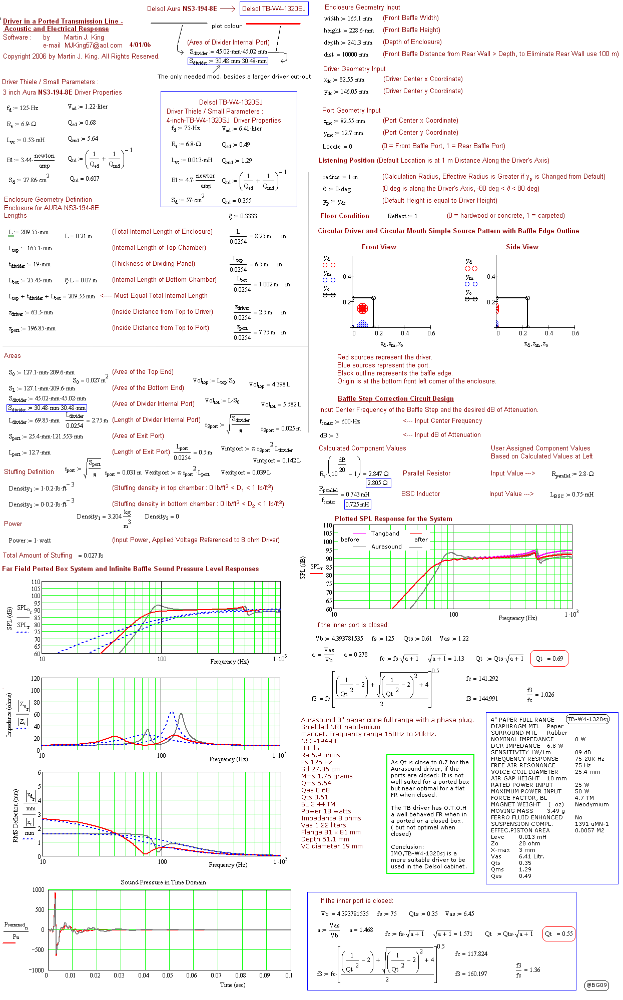

Hi, FYI: IMO, a newer driver well suited for 'Delsol' is the Tb-W4-1320sj that uses the simulated box dimensions as in my post #107 .See the picture.

Thank you for sharing useful information. Although I don't fully understand the implications of the information provided, I see that TB-W4-1320sj is a better alternative to the Aura NS3-194-8E for building DelSol bookshelf.
However, the price of the TB-W4-1320sj (almost 100 US dollars for a pair, quoting Parts-Express) is beyond what I can consider as "inexpensive" for my first DIY speaker project.
I don't like to sound cheap, but what I liked so much about the original Delsol project was that the woodwork seemed simple enough for me to try as a first DIY project and the price was "cheap" enough to swallow even if I mess things up and end up with some wood and magnets while having a promise of good sound if I manage to build properly.
So any cheaper (and simple) alternatives?

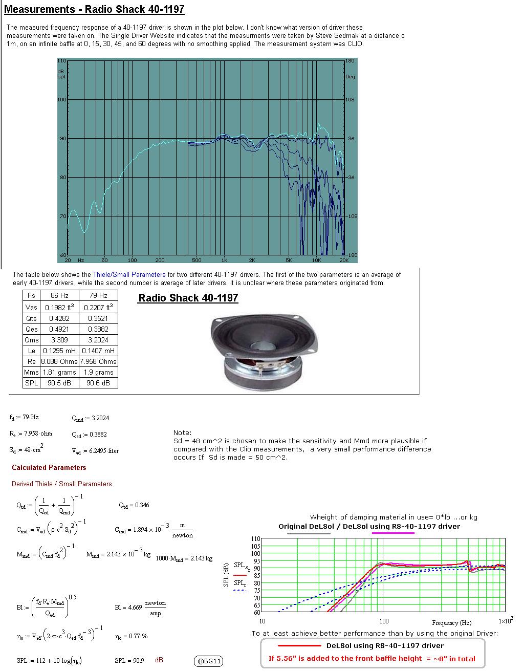

Does anybody have a clearer drawing of the Delsol plans?
The 1197 mod is what I would like to try.

Add 5.56" to the height: If the top plate is 0.75" then the new height is 9+5.56"=~37cm or if your top plate has another thickness: add 5.56" to 8 1/4" = ~35 cm
Hint: Move the 2" internal port towards(close to= 1/2 inch at most from the (leaving clearance for a thin layer of wool felt(1/4") to cover the rear inside wall of the top box ) the rear side of the box as this will lengthen the the total port system and improve the low end FR.
Adding an inch or two to the width of the top box is also beneficial as making this volume larger by pushing the tuning lower resulting in a much smoother low FR end.
