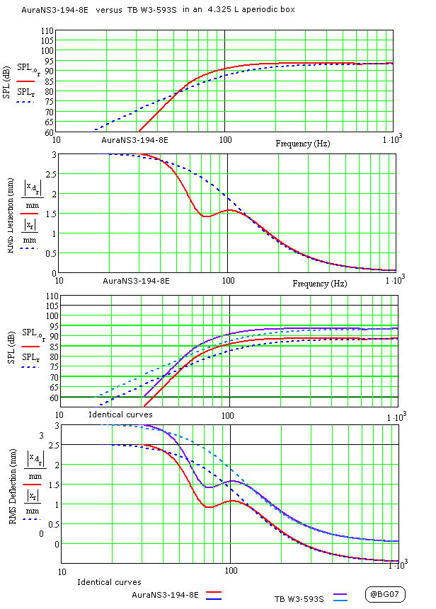

bjorno said:
Yes and I also don’t think there is any need for reinforcing the basket, colouring effects from vibration is negligible if the driver is glued hard to the baffle, but worse and detectable near x-max if only secured with screws caused from the ‘flimsy’ small flange.

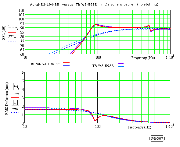

Post#97:
Yes I do and that the W3-593S also have much better FR performance.
It looks likes the drivers almost perform identical when simulating in the same DelSol box, see picture 1(1), also in a 4.325 L aperiodic box, a box I simulated optimizing the DelSol possible FR performance, see picture 2(2)
The conclusion is that TB W3-593S can also be substituted for the Aura NS3-194-8E and simulated identical with all suggestions found here:
http://www.diyaudio.com/forums/showthread.php?threadid=99493
I believe the W3-593S is designed generations later than the Aura NS3-194-8E and by examine the appearance and driver data, its likely that the former driver is an improved version designed by the same designer i.e. by Ben Tang.

Do u think it will work with W3-593S? (on sale at PE)….gychang

bjorno said:Post#97:

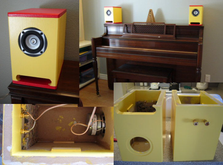

I just finished the DelSol project with TB speakers. (W3-593)
so far the sound is satisfying, minimal stuffing with capet underlayment on the back inside of the cabinet. Reminds me of the South of the border colors. wish there was a way to compare with Aura speaker...
gychang

Tangband W3-593 driver hole
I am currently in the middle of building sets of Del Sol bookshelf using Tangband W3-593 (3/4 MDF and 1/2 Birch Ply Face).
I have question concerning mounting the 593 driver. What size should the driver hole be on the faceplate? I noticed around the rear of the 593’s mounting plate there is a slightly raised lip which extends past the basket. The diameter of basket is about 2.75" and the diameter of the lip is 3". If I make the driver hole 3", the square sides of the 593's plate will barely have enough overlap for speaker caulking. If I make the driver hole 2.75”, the driver plate edges will not sit flush against the faceplate. I read the 593 is supposed to be a rear mounted driver. Any suggestions?
Thanks,
Nathan
Thanks,
Nathan
I haven't dealt with that driver specifically.
I would recommend against rear mounting,
The original driver had similar dimensions, with about 1/16 overlap.
I used a 3" holesaw, and used silicone caulk on the drivers flange.
I made pencil marks to be sure the driver was perfectly centered.
If it's your first time I'd cut a practice hole in something and see if it looks like it will work.
If you look at the picture above posted by gychang, you can see that he routed out a depression to accomodate the flange depth.
