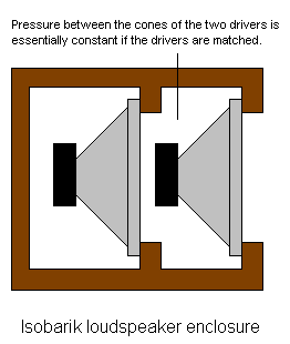

But I must not understand your Acoustat Isobaric arrangement if there is no overlap...the way I understand, there is 100% overlap with isobaric arrangement, no?
I have many Acoustat panels (and acouple pairs of Medallion interfaces) and would like to accomplish:
* 7 feet tall max
* Mid of top panel at around 5' - 6' high
* Better focus bass (hence looking at the Isobaric arrangement)

If they are curved then there is not a real issue as they do not face each other or overlap. In case the speakers are overlapping you have an issue. If there is as complete overlap like in the woofer arrangement then they act as one (sandwich). But only if the phase shift is very small (In case of the low frequencies his is no problem).
