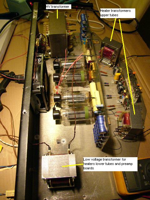

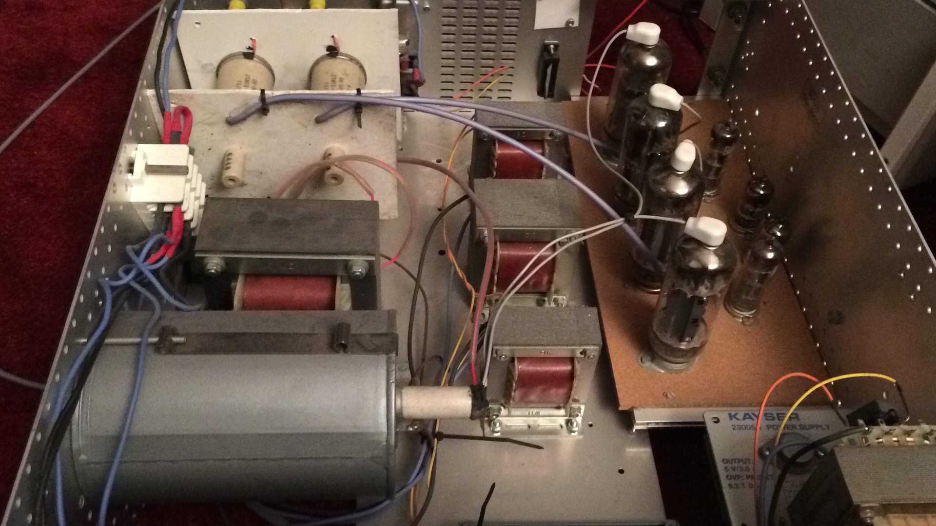

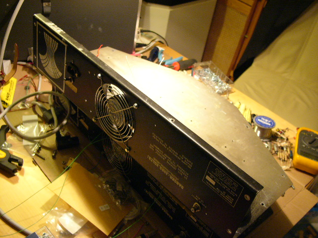

The decision to discontinue the DD amp was driven by the potential liability issues due to the lethal voltages present and Mr. Strickland's conscience. The superiority of the DDs was well established by the time they were discontinued since both they and the interface were available until their demise. As Stereophile conceded, "the king is dead". Subsequently, and probably consequently, so was Acoustat. There's a short history at Audio Circuit. Marketing promoted the ostensible supersession of the interface. It's interesting discussion about further improvement/development of the DDs is conspicuously non existent. I can attest to my own experience having both the Monitor 3 and Model 3 with the best interfaces that the Monitor 3 simply spanks them. They are in a different league.
mr

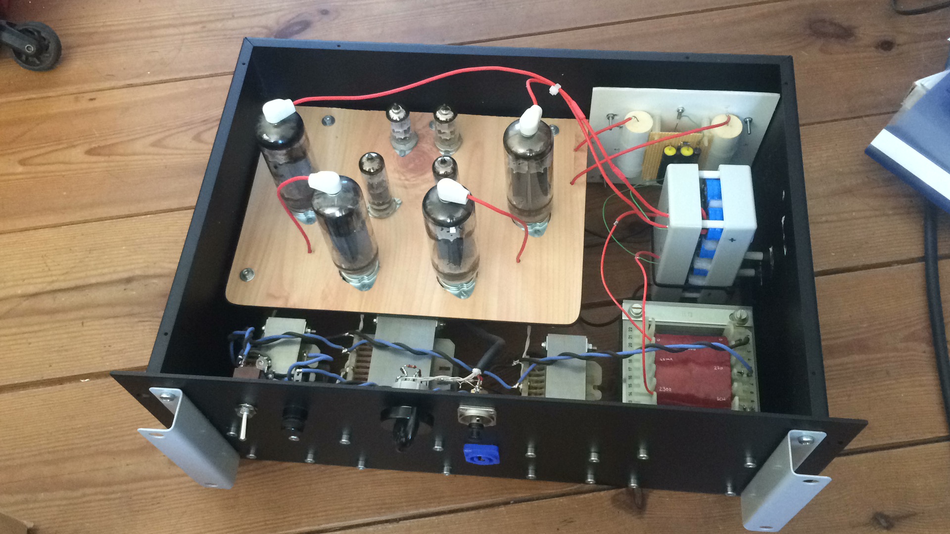

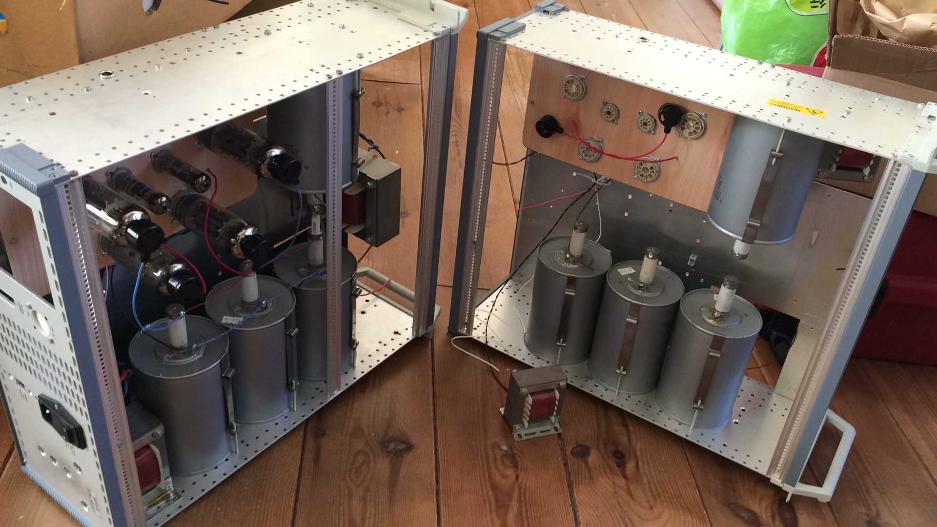

I think that the DD amps could be improved a lot (input and driver part). There was no choice in amps just this 1 model. With transformers different amp types could be used with far superior circuitry. So the comparisson is unfair. If the cheap opamps in the DD amps are replaced by something more advanced then the story would be different. Yes the amps are dangerous when opened but were very stable (for a tube amp). Only when modified these became unreliable.
The reason for me to build my own was simple. They sounded just not good enough for me.
Not all DD drive amps are Acoustat (for me that is)!
We must try not to generalize all DD amps just because we do not like the Acoustat amps.
One can say that no tube amp is good as i have heard one ....
Then you also would ask... wich one did you hear... no ?
In 2007 i have demoed my amps at a ESL club meeting as can be see on the picture.. The other picteres show a rebuild of a Beveridge DD amp.
