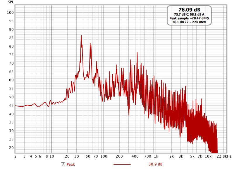

OK, I couldn't resist. Here's Malia and Boris link, first minute or two. This is great music for the simple folks who pull up to stop-lights in their car next to mine with music booming out. As far as true low bass... not much compared to substantial booming 80 Hz. Not a whole lot below that last big peak at 52 Hz.

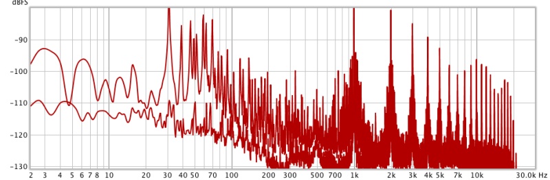

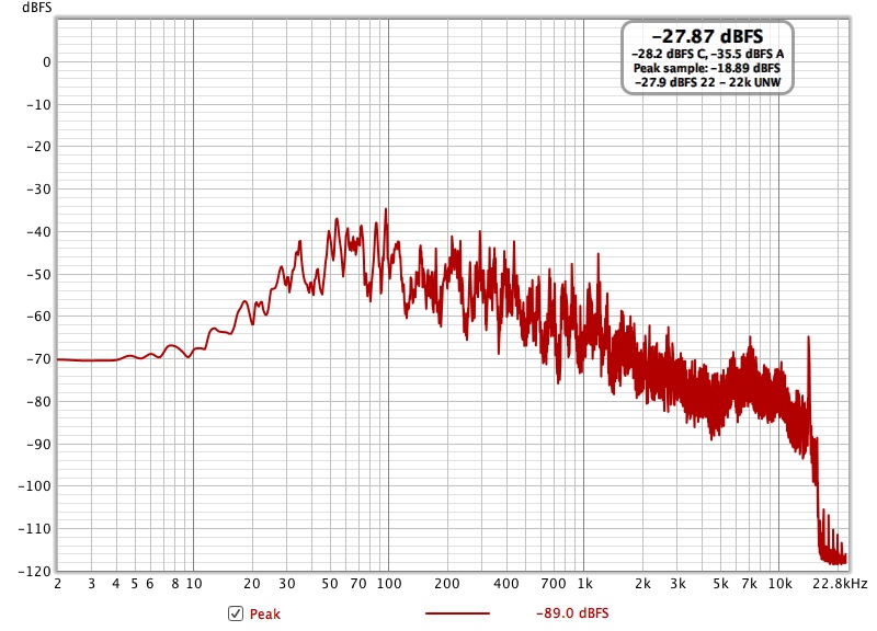

Here's a a French organ piece I like for bass. That note at 16 Hz is real enough if not loud and it is a great thrill when the pedal just peaks through in background of silence at the end of the movement (and shakes my window panes).

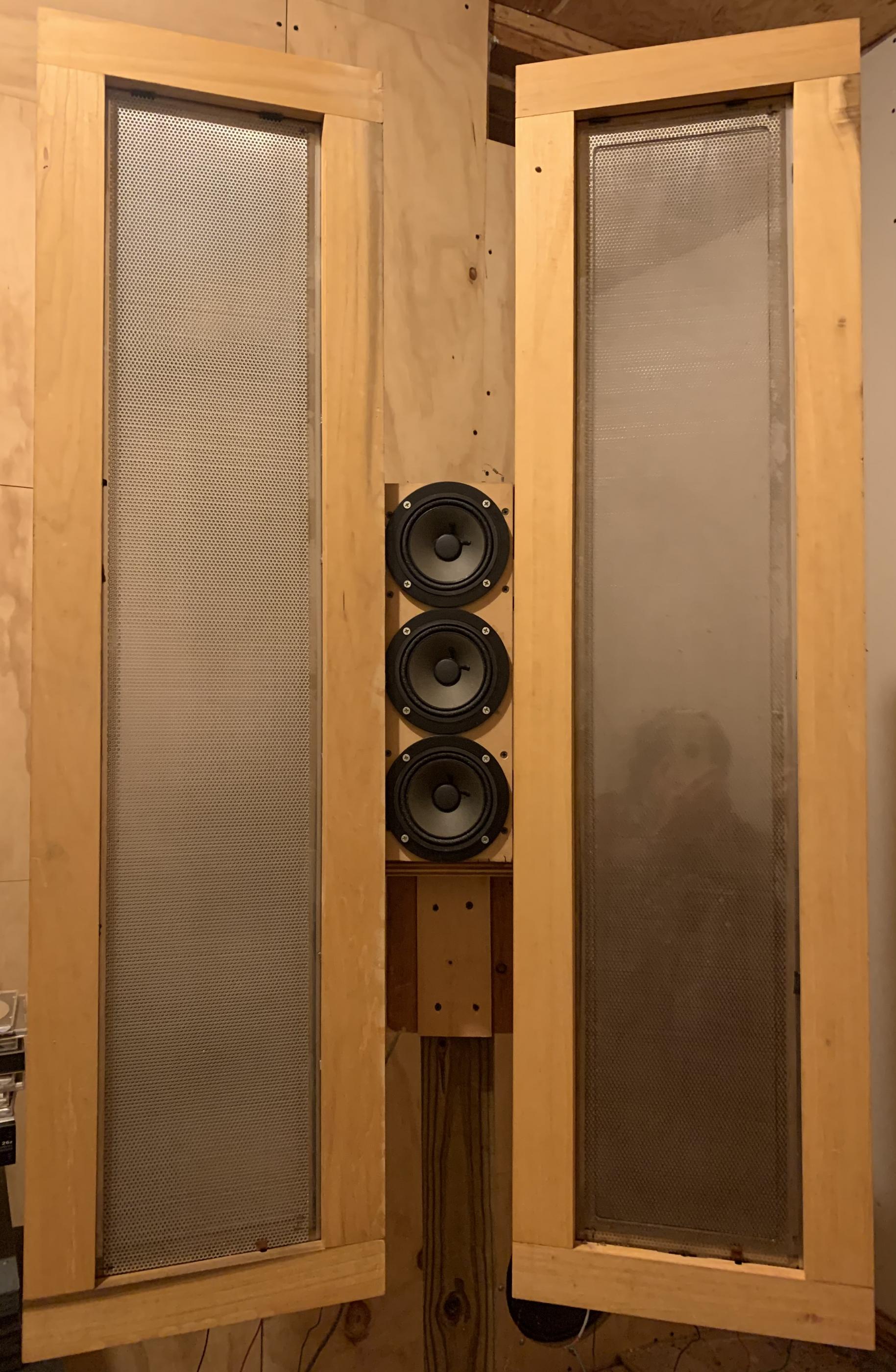

Finally got a pic. It is just the right channel side. 2 of the panels died from spacer shrinkage, (I've had this happen more than once, acrylic spacers shrinking on exposure to heat or sunlight) They are standard Sanders laminates. I was using the 2 that survived (barely) one on each side when I got onto other things. The hinge spacing was slightly different so it was a trick to move the left panel to the right for the picture. The panels are about 48 inches, with an active diaphragm area about 44 x 7.5 D/S .070'' Crossover at 600.
I spent some time at your site. Very impressed. Really beautiful work and so much good information there. Now I get the wire stator thing. I like how the dispersion could be easily changed. Bypass the resistors for laser beam focal point listening, then back to normal for guests.

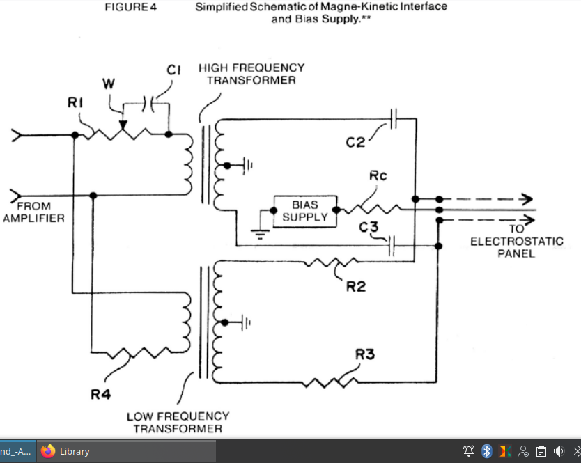

As Cookie Monster often said, "It boggles the mind." I'll have to study that some more. I found the paper: http://www.audiocircuit.com/A-PDF/AA-Brands/A/Acoustat-ACO/GEN-John_Strickland_-A-EN2-941-ACO.pdf
I was very interested in the 2 transformer interface. They claim it's better than direct drive amps. I know a few here who might disagree...
