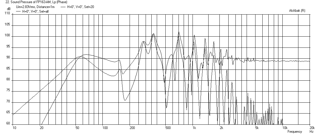

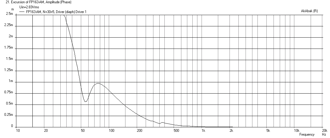

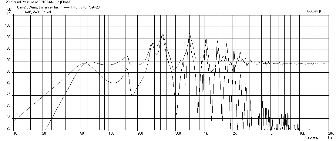

Here is a sim of the FP163 based on the geometry you provided me (sans first expansion and 20 cm wide). It actually looks pretty decent if you use a 8ohm & 1mH BSC to even out the HF's. You will see that the sim predicts a significant amount of mids & highs leaking through the horn and potentially causing a 230Hz to 450Hz and peaks at 700Hz, 1kHz, and 1,4kHz. To combat this, you will probably need to line the driver chamber with felt, and also the walls of the horn leading out to the mouth should be lined at least 2 walls with felt to reduce this leakage which will color the frequency response. It seems to have a pretty good 60Hz bass extension that is flat. The sim assumes corner placement with the baffle located 20in from the left and right walls. The height affects a floor bounce cancellation and two cases with the speaker sitting on a 24 in high stand and also just directly on the floor. You will need some sort of high pass to protect the cone if your music has much content below 50Hz.
Freq response in corner with 24 in high speaker stand:
Freq response in corner sitting on floor:
Cone displacement:
Good luck building it! Seems like a fine performer.

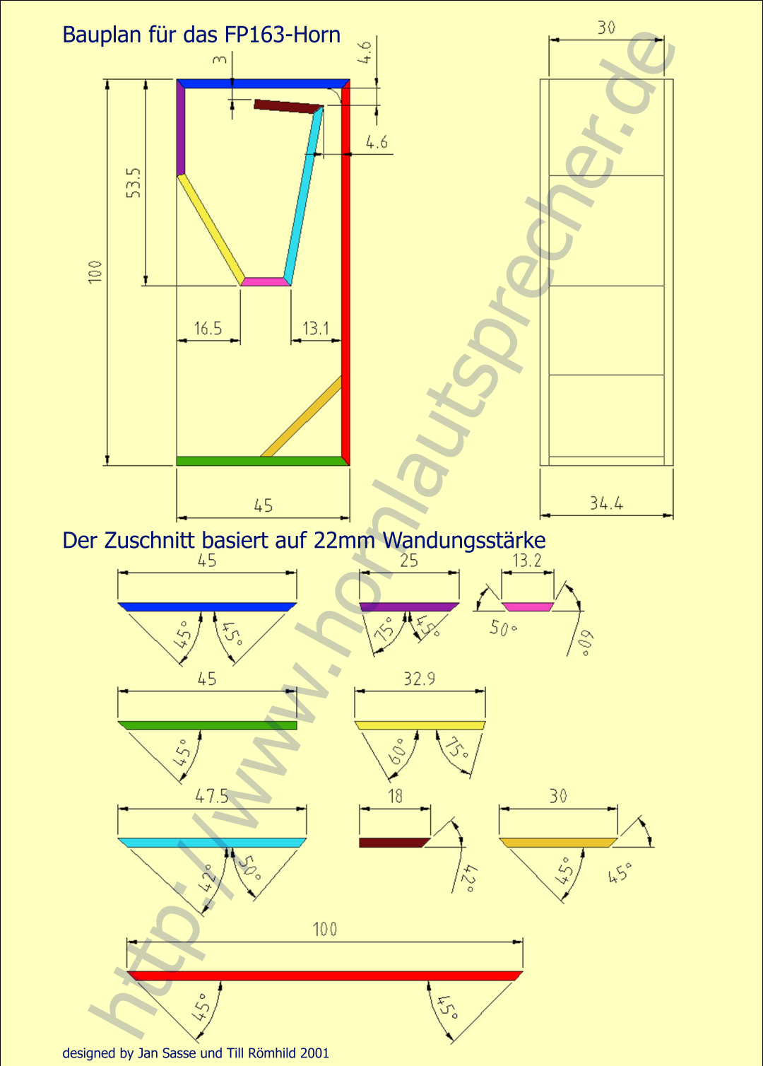

Geometry used (did not include effect of corners and folds):
Perhaps we may look at this one narrowed to 20 cm and leaving out the first (brown) section?
Code:
Estimated volume chamber is 18.8 liters (20 cm wide)
section 1 - start: 4.6 x 20 cm, end: 27 x 20cm, long:59 cm,
section 2 - start: 27 x 20 cm, end: 49.5 x 20, 18 cm long,
third and last section - start: 49.5 x 20cm, end: 70.6 x 20 cm, 25.5 cm long

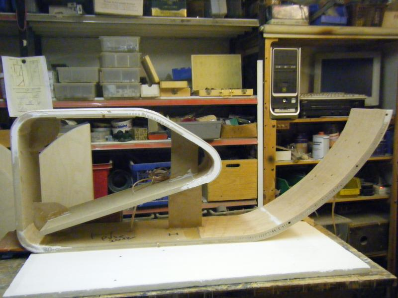

Are there plans for this somewhere? The design looks very cool in that I could use the general shape and way it is folded and rounded to make from a single sheet of foam core for the middle. I would redesign it for a smaller driver in the 4in class - maybe a 4FE35.

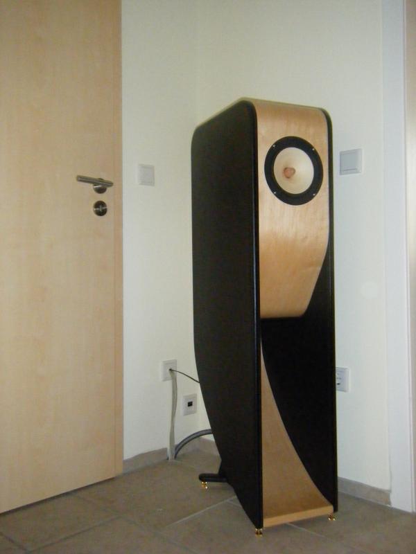

On that German website I saw this plan which looks like an interesting candidate for a FE167E:
www.hornlautsprecher.de - solutions in sound under "projekte" and then "horner" you'll find the different designs. On each design the plans are at the bottom - there are plans for different drivers, even small ones.
The picture shown is similar to what you modelled, except it is not using discrete pieces of material.

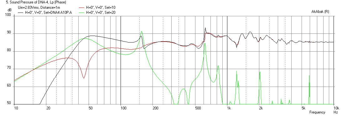

Has anyone considered the Mark Audio Alpair 10P-A as a replacement for the TB W5-1880 in the original DNA horn? The T-S parameters look to be similar. The MA has Fs = 42.4, Re = 6.2, Vas = 30, BL = 4.74, Qms = 2.43, Qes = 0.38, and Qts = 0.33.
I'm interested because my listening room has a large brick chimney at one end with a 14-inch high hearth that's 22 inches front to back. I figure I could put the speakers on the hearth on either sided of the fireplace. Thanks in advance.

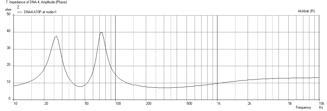

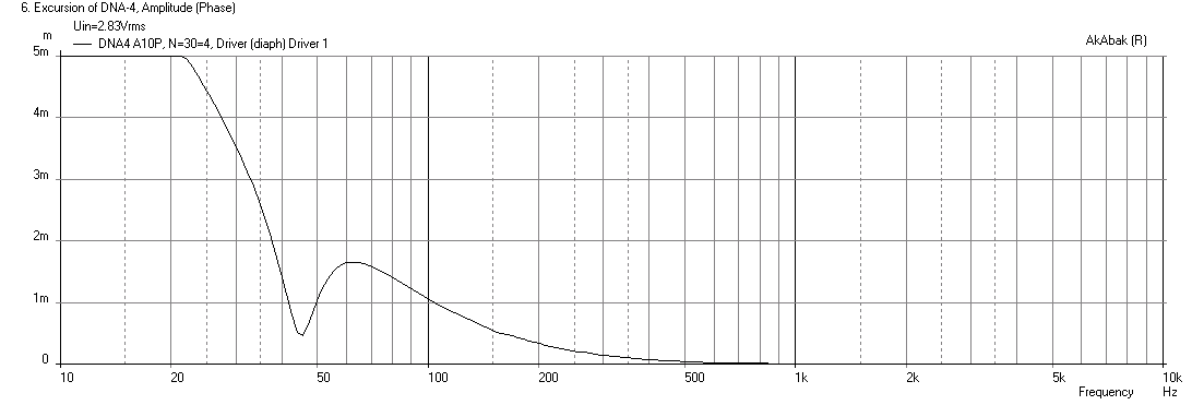

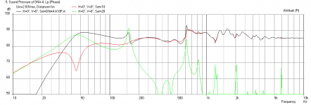

Good call on this driver for the DNA - it is a good match. The cabinet plan should be set at 10.5 inches wide just like the FE167E, but use a 1mH & 7ohm BSC.
Here is frequency response with speaker 24 in away from rear wall and sitting on 24 in tall stand:

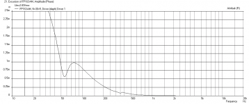

Here is cone displacement:
Here is impedance:
Thanks for the simulations xrk971. I'll have a closer look at the FE167 plans. If I decide to build these I'll probably go with line level BSC. That fits my setup better.

You are welcome. Line level BSC or XO is the way to go if you can. I think the plan is in post 1 (reverse engineered from web picture) and make it wider at 10.5in instead of 8.0in. If you follow the thread, Bcmbob caught a few dimensional inconsistencies that I had by hand sketching.you can always buy the plans.
