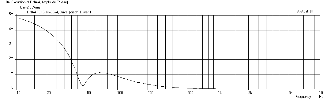

PS Any idea what cone excursion will be like?
You are welcome. I will take a look at the excursion when I get to my AkAbak computer. As I recall it is about 0.5mm at 2.83v around 40Hz and goes into runaway below that. If your music doesn't have sub 40Hz content and you use small amps should be fine. The horn loading is not so great as this is a hybrid reflex BLH with a rather large driver back chamber.

Here is the excursion for the FE167E at 2.83v - as long as you don't have content below 40Hz you should be OK:

I won't be having deep bass, I am not into head banging or movie explosions but am concerned about xMax. Hence that I started to look at horns, e.g. the BK-161 (later version of the BK-16 with larger coupling chamber) but those have some large SPL (20 dB +) swings in mid bass which will be audible.
