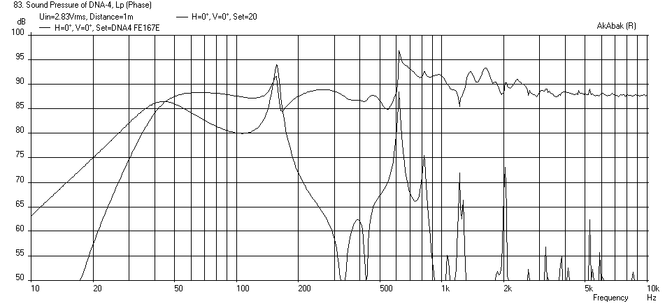

Concerns that the DNA box may be a little small and that the bass gain from the horn may not be enough are true. However, it is not totally a lost cause if you are willing to use the DNA in a corner and use a BSC to sacrifice some sensitivity. I made the internal width of the whole speaker wider by 2.5 inches (10.5 in wide internally) and added a 1.2mH & 10ohm BSC. This is kind of a small speaker and it helps to raise it off the floor on a 2 ft tall stand which places the driver height at about 40 inches and helps to reduce a floor bounce cancellation. Also, add light stuffing in the channel immediately after the round throat, and a light amount in the horn channel at the bottom 'gooseneck' where it goes down up and down. No stuffing in the long passage from top to bottom or the mouth area. Line 3 of the walls inside the driver chamber with batting or fiberglass.

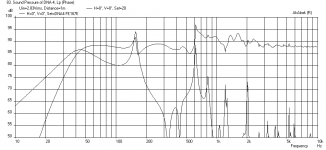

Here is the predicted response situated in a corner of a room (driver face 20 in from left and right walls) sitting on a 24 in tall stand, with moderately absorbing walls and floor:
I think it looks pretty good with 42 Hz (-3dB) bass extension and about 88dB sensitivity. It takes it down from the native 95dB sensitivity of the FE167E, but for some applications with more than a fleawatt amp, should be OK.
After widening the cabinet to 10.5 inches, it fits easily enough and is no longer shoehorned in. I think that gain in bass could be better if a larger box was used, but for such a compact enclosure, 88dB and 42Hz may be acceptable for some people (I would like it, for one). It was easy enough to mod the original model to sim this. The biggest reason why one would be interested is someone already has these drivers in-hand and has been looking for a home for them.

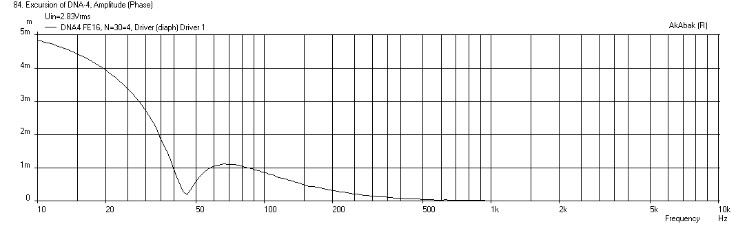

Here is the excursion for the FE167E at 2.83v - as long as you don't have content below 40Hz you should be OK:

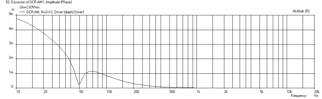

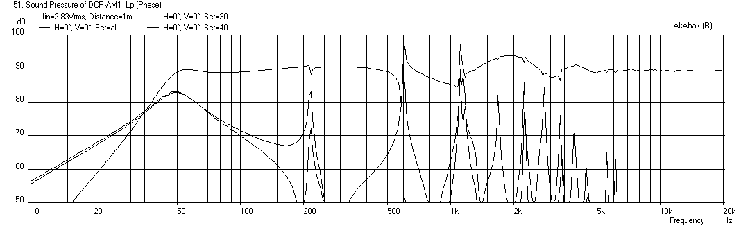

A more compact cabinet with a decent response can be had using a dual chamber reflex (DCR). Here is a 31 liter design for the FE167E that is 8.5 in wide x 14.0 in deep x 18 in tall (internal dims not including exterior walls or middle divider). The divider separates the volumes in a 2:1 ratio with the larger one on top where the driver is located and the lower one on the bottom. Each chamber uses a 50 mm dia x 114 mm long vent that is rear facing, the inter-chamber vent is a 50 mm dia hole cut through the 12 mm thick divider panel. Bass extension with this design is about 44Hz (-3dB) with about 90dB sensitivity. It requires a 1mH+7ohm BSC circuit to tame the baffle step loss. In reality, the stuffing or damping in the chambers will significantly reduce the mids and HF's from leaking out and causing those peaks at 600Hz and 1100Hz - so ignore them. To get an idea of what this speaker might look like, check this thread: http://www.diyaudio.com/forums/full-range/252627-viva-la-vifa-curvy-cabinet-dcr-tc9fd.html. A curvy cabinet will help reduce resonances but is not mandatory.
Here is SPL vs Freq at 2.83v:
Here is cone excursion at 2.83v:
