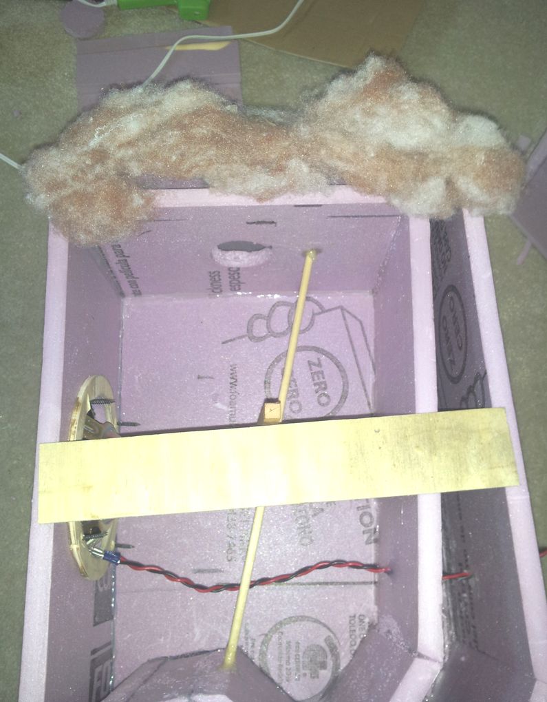

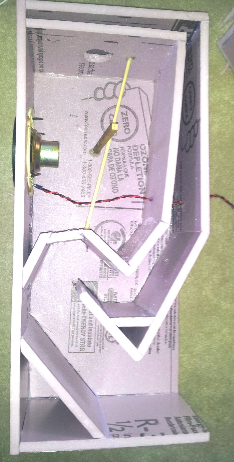

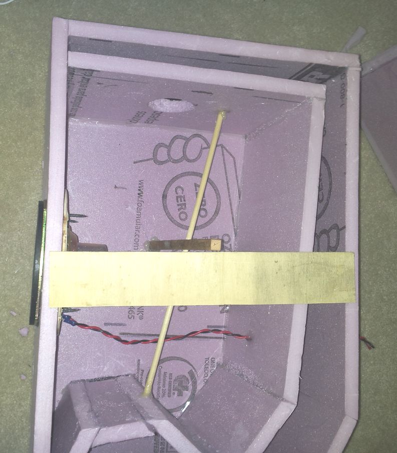

O.K. I'm back in. The second box was a bit easier to do as I used a couple squares to keep thing at 90 degrees where the internals meet.
There is one side to side brace that will attach to the plywood plates on the outside. One small dowel that connects both top plates and the more stable bottom of the chamber. I didn't brace the back with wood but put a small thin FC wing for a short distance.
I'm ready to close it up but am open to any suggestions. The stuffing represents the amount I put in the first section last time - More....Less?

Bob,
Looks good. Maybe a few more dowels in main chamber in different directions. Use Foam struts if needed don't worry about losing volume. I would also brace large side area in main mouth side to side with a dowel or foam strut.

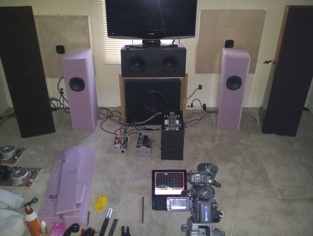

The results are very impressive. Stereo fills in a lot. I'm doing some testing now and will have some pictures/charts to show either late this evening, in the morning or just when I figure out what I'm doing. 😕
With two DNAs there is a good amount of room shaking near 30hz. SPL is decent and I believe somewhat better than the cornu. Still not happy with the top end of these drivers but always thought they would need help.
Using this app (iPad version) and a video camera. Be back soon............

Yes, it's good to have the second one done. These take much longer to build than the cornu - matching angles. Still not that bad, around two hours for the FC and another two for driver/bracing/final gluing.
The bracing did a lot for stability. Still have to do the mouth but much more energy is coming through. That's a Honey Badger clone (6 power transistors per channel) in the liquid cooled case. Extremely nice sound, no leaks and temperature stays just above room temps. F5 being reworked with new design. Haven't hooked up the ACAs yet but will tomorrow.

Just to let you know .... Not getting usable results from the equipment and software I'm using. I've been trying to pass some sine waves through three sets of speakers to display freq. and db comparisons. Both the iPad and Android apps track quite well till I get below 80Hz and then all kinds of overtones take over. Looks like I'll have to find an inexpensive calibrated (calabratable) external mic... I needed an excuse 😉 I have some more professional programs and hardware but won't try that route till a get a better mic.
The little music I've listened to mostly confirms what I've already reported. The Cornu/Vifa combination has the best presentation across the spectrum. The DNA has a cleaner/tighter bass - a lot more physical vibration but less body in the low notes. It's like amps, each unit has it's own character... I'm having a hard time with the top end of the DNAs cause they are sitting next to the Sunflowers which have exemplary highs. Hopefully I'll have time to plug in those tweeters tomorrow.

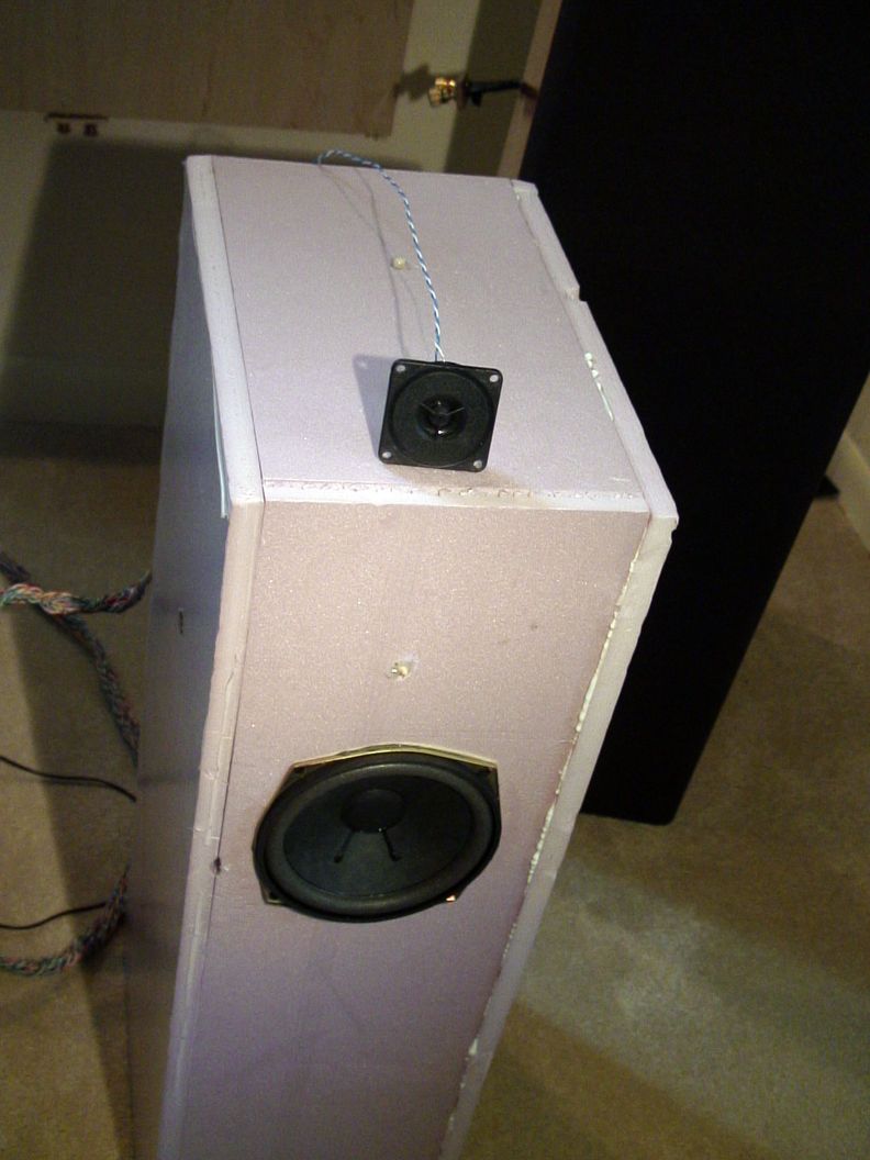

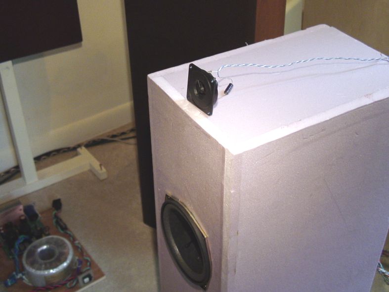

Tweeterdom Rules ! Now I can hear cymbal shimmer and stick hits. There is audible air in reed instruments and voice/instrument placement is better defined. I'll call it a definite and needed improvement.
However,,,, more still needs to be done. I simply placed a 2.2 uF cap on the positive of the tweeter. A full 12dB highpass ( add a .46 mH coil) has no determinable effect. The added tweeter seems to bring out some honkiness at the top of the midrange that I hadn't noticed before. I have several larger tweeters (inc. PE RS28AS-4, Vifa DX25TG09-04) and trying to get more of the mids on those might be a possibility.
