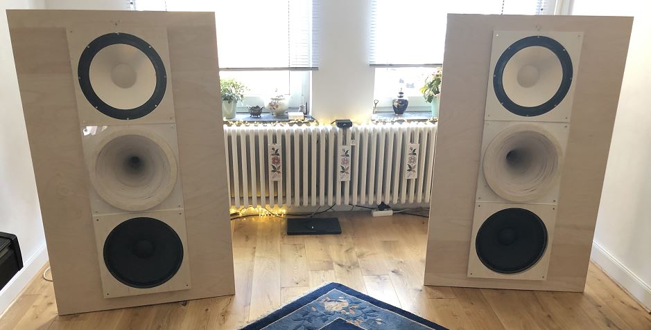

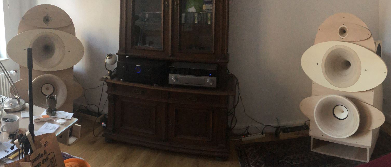

Hi there,
even though some of my findings can be found in other threads here i want to summarize my findings here. I have tried a longer time ago this here, now i changed to this here:
The directivity for the high range frequencies lets say from 3 to 20 kHz did not work for me in the first attempt, with such a large horn mouth you will have a laser cannon for the high range regardless of the driver you use - for me it worked only after introducing a small horn for the high range - but good luck anyway!
- Stefano

Hi, yeah beaming highs is not ideal.Hi there,
View attachment 1218894View attachment 1218895
L
- Stefano
I gotta comment that horn mouth has nothing to do with high frequency coverage though. It's the throat diameter and shape of the waveguide/horn profile that determines high frequency directivity. You could keep mouth size constant and have complete freedom to change directivity of the device on high frequencies up until throat diameter frequencies just by adjusting profile of the horn/waveguide, depth and curvature. Above throat diameter wavelength the responses is more or less chaotic, could be optimized as well if you knew shape of the exiting wavefront from the driver. Mouth size determines how low in frequency the directivity is controlled, and shape would determine diffraction.
