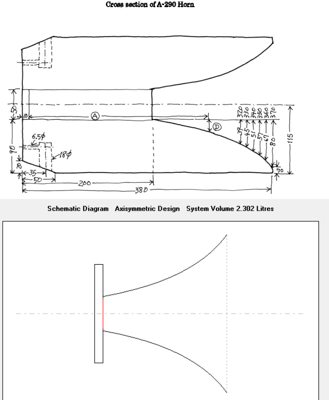

I've got my heart set on a pair of these A290 Yuichi clones from Athos. Unless something else significant catches my eye, these will likely be the best option for me while keeping my wife happy concerning looks. She normally doesn't say much about my speakers, but I'd rather keep her happy than push my luck further, as she did approve the money I plan on spending on this build. We'll see what else comes along.
Yes, I'm aware of the huge 2360 beung an absolute monstrosity. My wife would never go for that in our living room as accepting as she is with my hobby.
The K402 is much friendlier looking, but still not as liveable as the A290 clone I'm considering. The all wood construction makes it the most attractive looking horn, plus the performance is great with a larger driver.
I already talked with Athos about my specs and will likely pull the trigger on a pair of his A290 clones as pictured above.

I think Diggy was actually suggesting you reach out to me. The Athos is an excellent clone of the A-290, quality is very high. I have the standard A-290, not the FL (which has no vanes)
A good approximation of CD EQ will be required whether you do that actively or passively, above the driver mass rolloff you need boost @ 6dB/oct. I am also using EQ below the mass roll off - works well.
This is not the horn for a small room. My room is too small at 3.25m wide and 5.8m long, ceiling height is just over 2m. (basement lab and man cave.)
I have spent a lot of time learning about room treatment as this horn lights up most of the surfaces in the room. Interestingly there are no polar plots of this horn that I have been able to find online. Initial measurements indicate it is probably over 100° in the horizontal plane, I have no verticals, but I will guess between 60 - 70° based on in room behavior. These are not reliable numbers as I don't really have a clue what I am doing quite yet.
If you have a room at least as large as mine and preferably larger the horn can be made to work, the larger the room the better it will likely work IMLE.
I have 9 acoustimac absorbers on the walls in here, a couple behind the speakers, several on the walls just forward of them, and others in various points the room. I have 4 bass traps and various things to diffuse sound, the room itself is rather full of stuff. I am just about to start treating the ceiling in specific areas.
It now sounds better than the 2380A without room treatment, but only just, and it's been quite a lot of work. Further improvements are coming and I am happy with the current result and will likely find other room improvements pay off.
I think it would be a good idea to stay away from the FL unless you have a much larger room than mine.

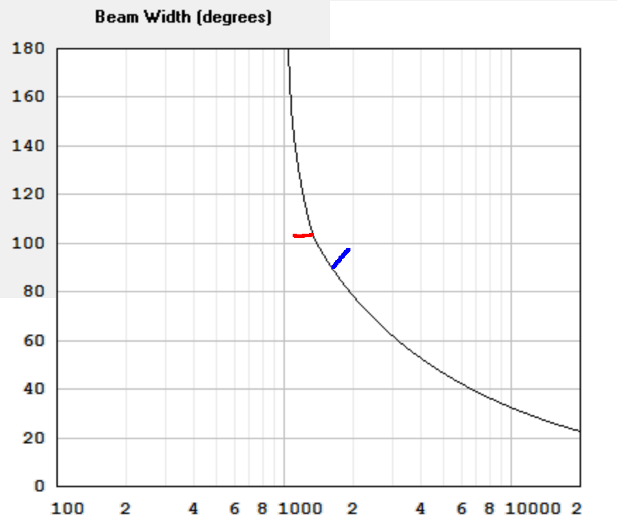

@kevinkr - how do the vanes change the horizontal and vertical behavior of a horn like the A290 compared to no vanes at all? I thought the vanes were acting as a phase plug of sorts and helping/modifying vertical wavefront expansion? I would think not having vanes would hurt both horizontal and vertical dispersion.

I made an attempt using the original Yuichi plans to create a hornresp simulation of the vertical beamwidth. (measured data would always be preferrable)
Reactions: 1 user
Wow, it really takes off under 1k. I see now why this horn can be a challenge to use in a smaller setting. Luckily my ceiling is high and textured, so I have an advantage. That can also be corrected with the appropriate crossover slope, plus steering the overlap lobe down with an offset LP slope to delay the LF. Of course that sim may be off as well, so I may be the first to measure beamwidth for this horn. Thanks for the research!
Yes, I saw that thread a while back. As I said before, the loss of pattern control vertically can be steered by the xover away from the ceiling to some degree in the overlapping xover region.
You can use the phase response of the driver you're crossing with to your advantage by creating an asymmetrical radiating lobe down to the neighboring driver with the inherent delay on that driver. It requires that driver to have extended response an octave or so above its intended xover for best results, otherwise the narrowing dispersion will allow the WG with its widening vert pattern to prevail and some amount of linearity in power response will be lost. That scenario above creates a "mouthy" sounding system off axis and even on-axis if the room is very live in that range (which most will be).
An MTM driver arrangement can be beneficial if a vertically loose WG is used in a room with low ceilings. That requires the WG xover to start rolling off with a stepped / mixed slope to compensate relative phase + amplitude, reducing off axis WG redation through the phase cancelation when the cone drivers + WG combine in the overlapping region. Delaying the HF further narrows the vertical dispersion around the region the drivers share response, but it only works if the driver spacing is less than 1/2 wavelength of the highest frequency in the overlapping xover region (preferably 1/4 WL). Combing can take over if this isn't managed carefully and you also loose potentially precious lower octave output from the CD, so its not that practical if the driver has limited low end response to start with using lower xover frequencies. That doesn't leave alot of wiggle room with driver or crossover selection and isn't so practical with driver combinations most people would use. It can however work wonders if you've tried and failed with other approaches and room treatment isn't pratical.
Using a larger MTM 2 way system to achieve this method of pattern manipulation would require very linear smaller duameter cone drivers with shallow cones that have wider off axis behavior. Its sort of counter productive when designing a system from scratch,.mainly because you could have selected the proper WG to start with.
I realize this approach isn't going to be practical most of the time, but even on a simple large 2 way system it can improve audio quality in compromised situations if you have comprehensive control over your xover parameters ie with DSP. Steering the combining lobe away from reflective surfaces can be the only (and easiest) thing in your power to change under these circumstances. It does require some time and patience to get it right along with a bit of math if you want to speed up the process. This is mainly a pro sound type of solution, but it could be implemented in a hifi setting as well if done carefully, to eek out the last bit of performance.
