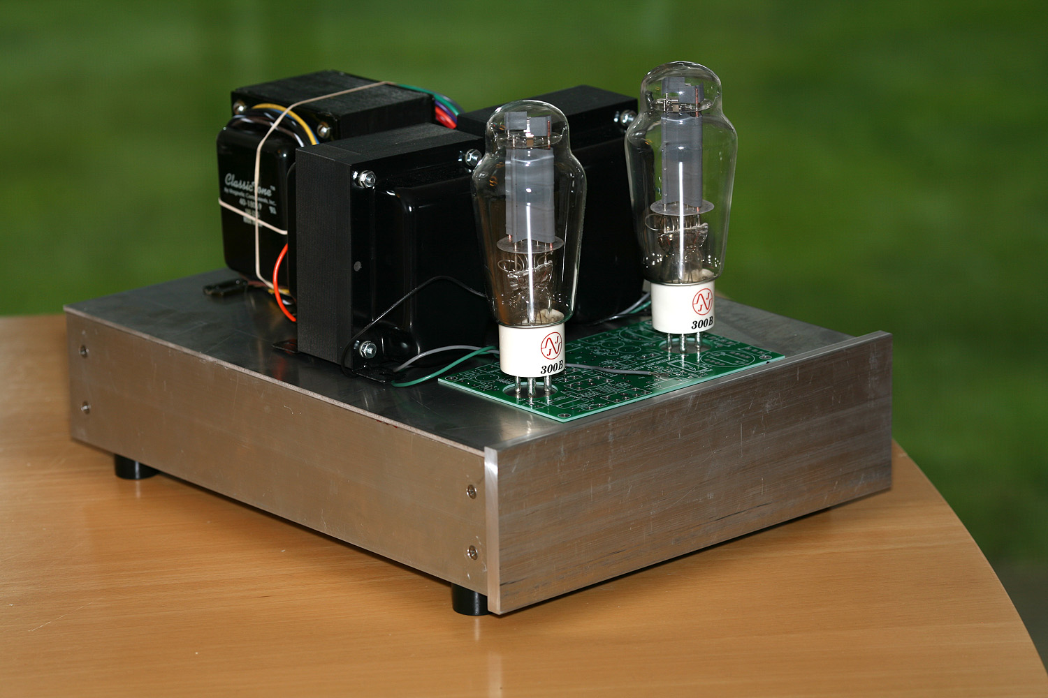

Funny you should ask. I just started on the metalwork for the chassis today. I completed the plans over Christmas so this is not exactly a fast process... But I decided to take this week off from work so I could get some headway on this project. The circuit description of the 300B amp is also slowly taking shape on my website.
The amp is still sitting in "DeathTrap" mode in my living room. Playing Dire Straits right now... /me like.
~Tom
~Tom
The chassis is coming together. As attached image shows, it's work in progress. But you get the general idea. The chassis measures approx. 11x15 inches. The sides are 3" tall, 1/8" thick architectural aluminum channel, the top plate is 1/8" aluminum sheet, and the front 3/8" extruded aluminum rectangle bar stock. I could probably have used thinner materials, but I like having enough material thickness to be able to cut threads so I went with 1/8" thick aluminum.
The type and position of the feet is not finalized. I would prefer them to be less visible.

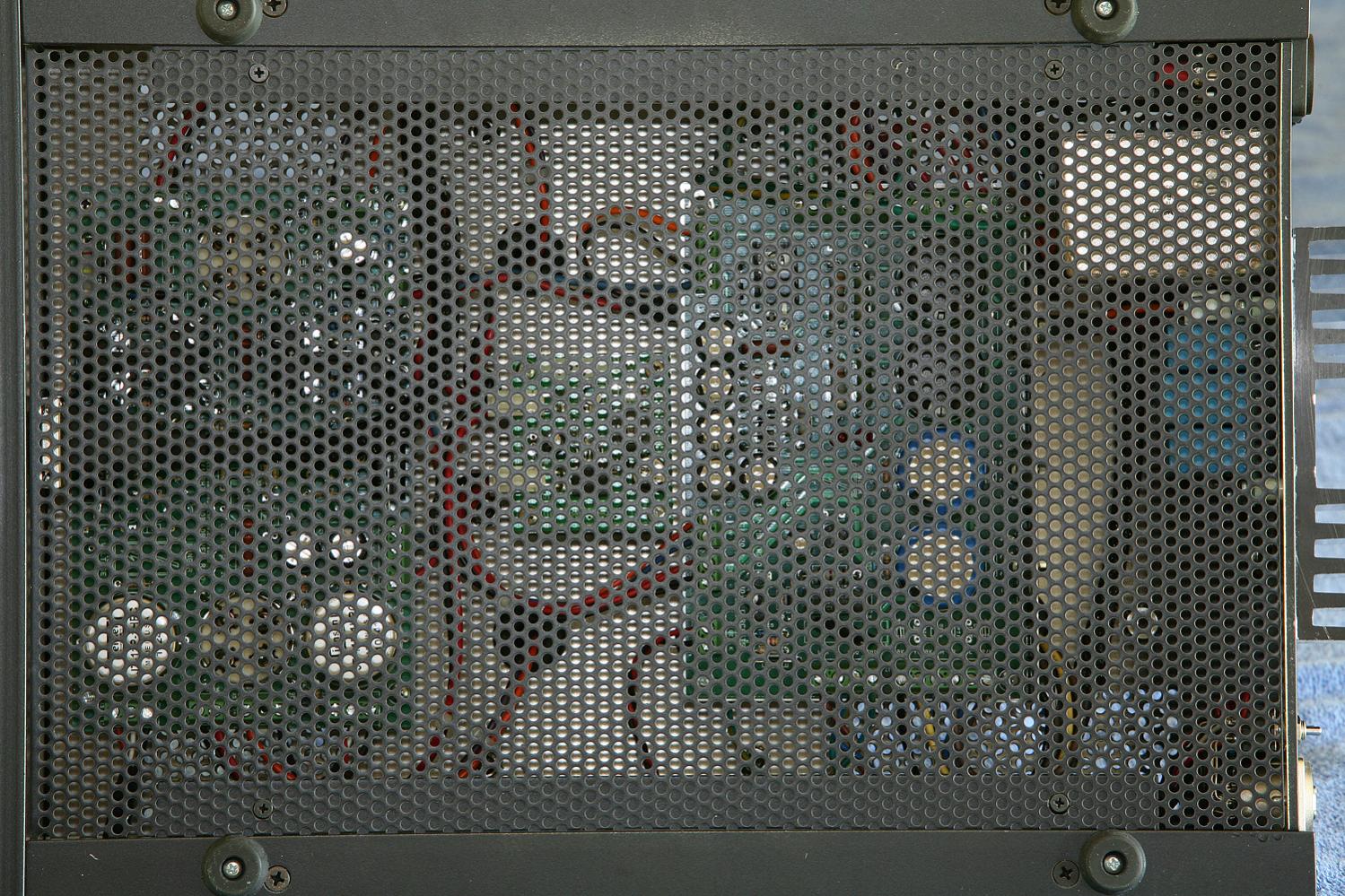

Thanks! No CNC here. The bottom plate is perforated sheet. The 546 vent holes (per chassis) on the top plate were drilled by hand (using a drill press, obviously). As were all the other holes. I used a stepped drill for the big holes.
For the vent holes, I made a jig from a piece of perf plate and a scrap piece of plywood. The perforated plate was used as a drill template. I held the perf plate, top plate, and plywood together with three brass pins. It worked like a charm and turned out really good.

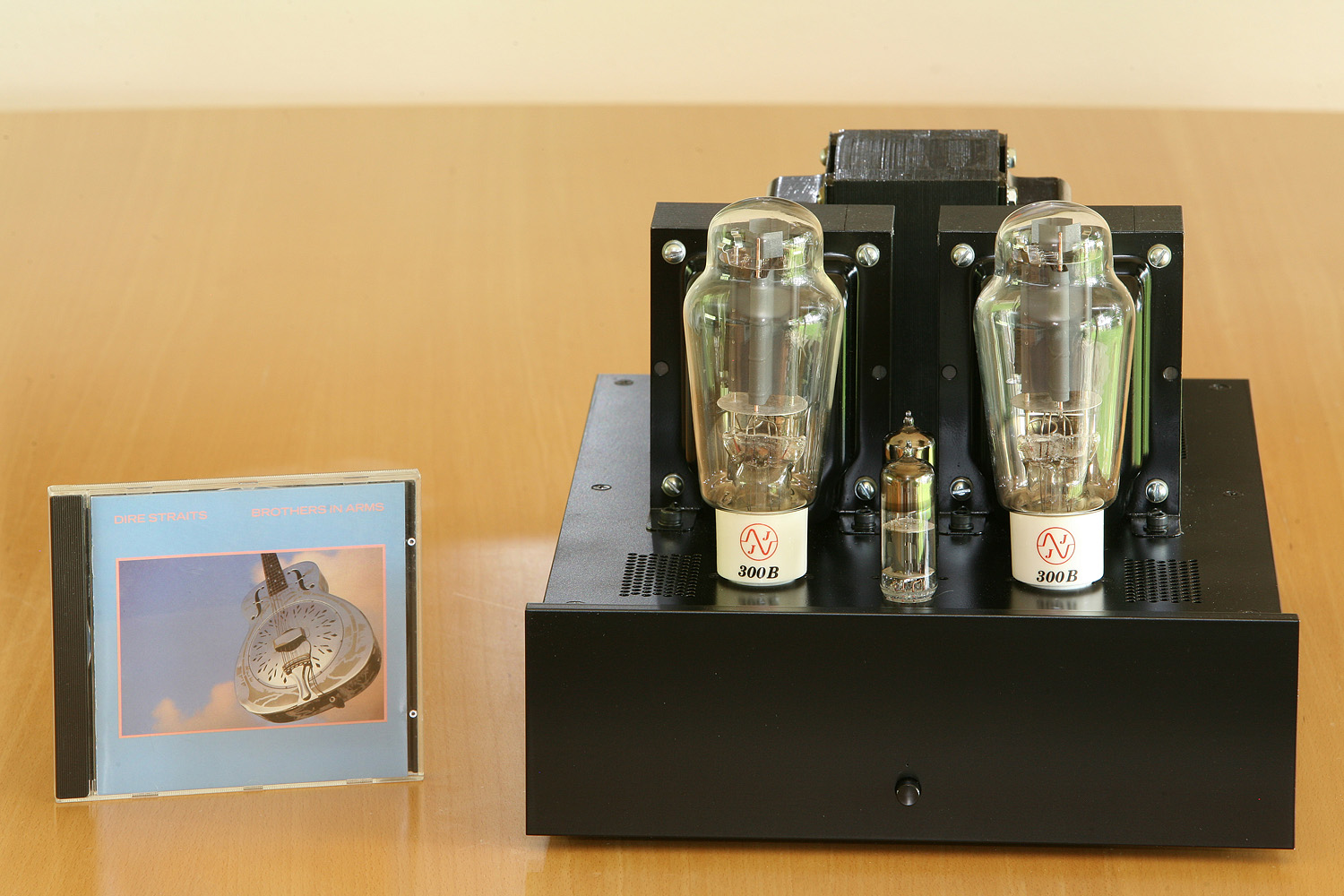

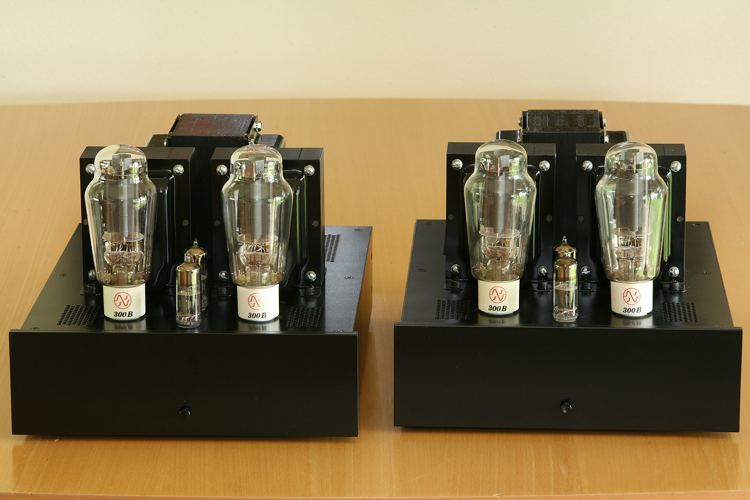

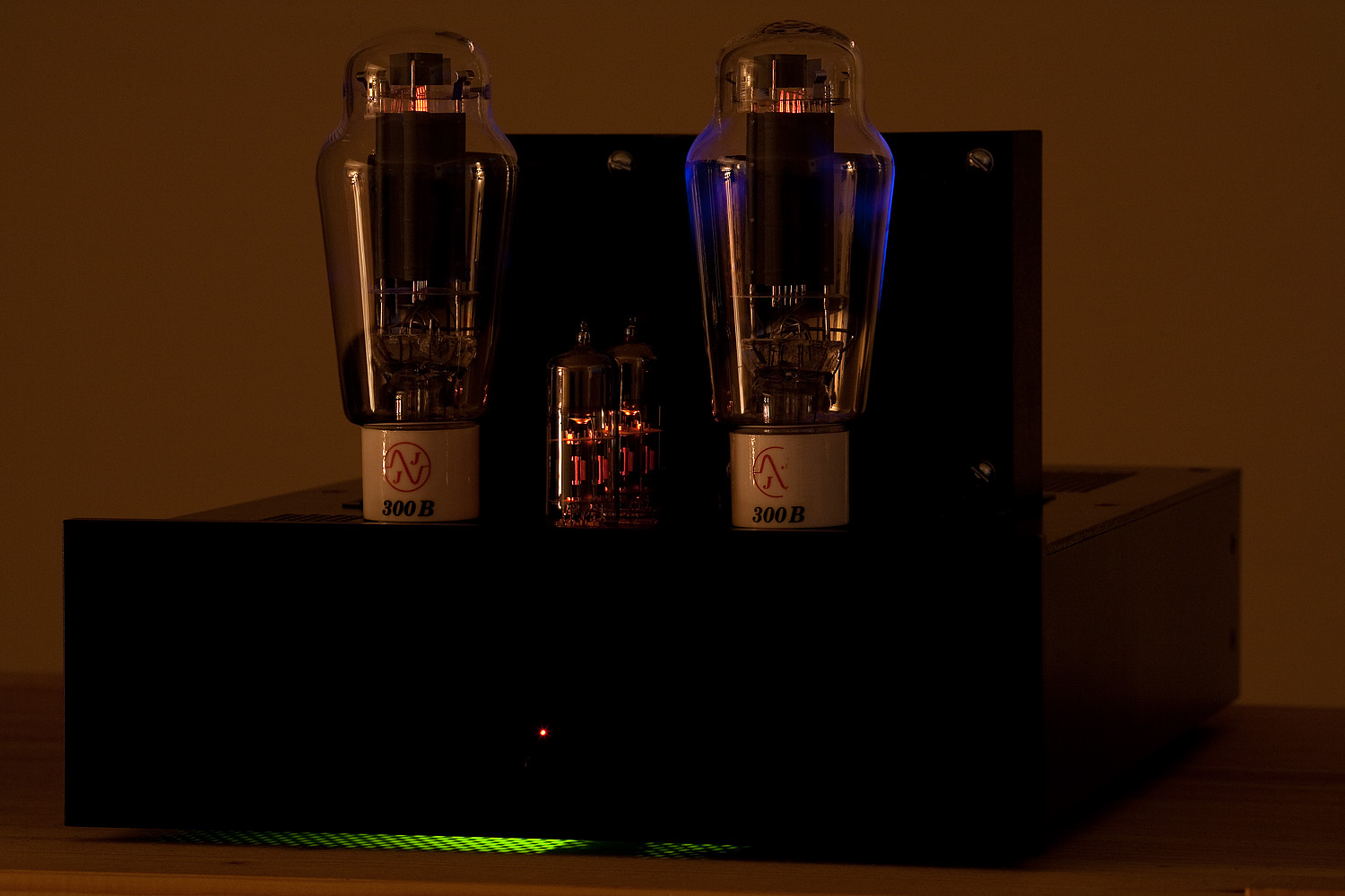

This project is finally drawing to a close. I've enjoyed the ride, but am glad to finally see the fruits of my hard work and allow this project to enter "maintenance mode".
I'm really pleased with the results. The sound quality of this amp is quite remarkable. I'm finding new detail in recordings I thought I knew inside and out. But the biggest surprise has been the sound stage. The imaging, width, and depth of the sound stage is unlike anything I've experienced before. I really like it.
I started this project over three years ago and it has spun off two side projects; the 21st Century Maida Regulator and Universal Filament Regulator.
The final amplifier uses three of my circuits:
- 21st Century Maida Regulator for B+ regulation
- 3x Universal Filament Regulator (stacked, 15 mm between boards in the center of the chassis)
- 300B Driver Board
I ended up using JJ 300B tubes and 6N6P drivers. I'm getting about 0.2 % THD (1 kHz, 1 W) and 10 W (3 % THD, 1 kHz). I'll follow up with more measurements at a later date.
Dimensions & weight: Approx. 30 x 40 x 25 cm (W x D x H). 17.3 kg.

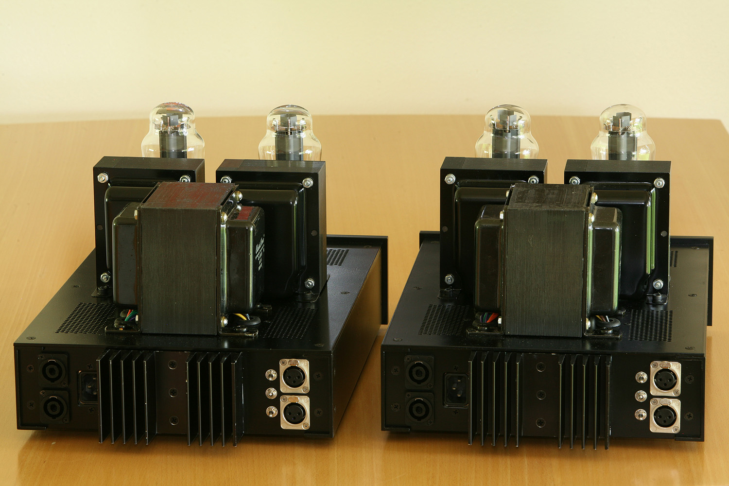

Very nice!

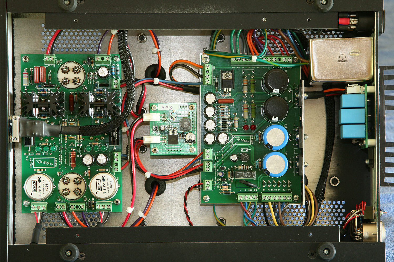

I noticed the three switches next to your input sockets. What are you switching between? Give me about six months and I should have mine finished.
The toggle switches on the rear: The one in the middle is the ground lift. The other two are phase invert switches. They swap XLR pins 2 and 3. This is quite handy when you're using electronic crossovers and play with the filter order.
I used 4-pole speakON connectors for the output. Pair 1 is 4 ohm, pair 2 is 8 ohm.

Putting together the 300B power supply. I noticed that the ferrite bead touches pin 2 of Q1. Is this of any consequence?
Jim
Jim
The ferrite bead I specified is not conductive. You can verify this with an ohmmeter. So it should not be an issue that it touches the drain lead of the MOSFET.
I had the same concern when I put mine together, actually. But after measuring the resistance of the ferrite, I concluded it wasn't an issue, and my two amps have been running fine since.
~Tom
~Tom
The Nickel-Zinc ferrites generally used in shield beads have high restivity. However, the Manganese-Zinc ferries used for power applications are conductive enough to cause trouble. It's a good thing to check and see which one you've got, as there are a few bead types made with the Mn-Zn material, and they all look superficially alike. I just checked a random E core from my desk detritus (Mn-Zn Philips 3F3 material) and measured about 56k resistance with a DVM. The resistivity is a non-linear function of applied voltage - I've had cores that accidentaly bridged line voltage AC turn red hot. At any rate, this is not an issue with Ni-Zn material.

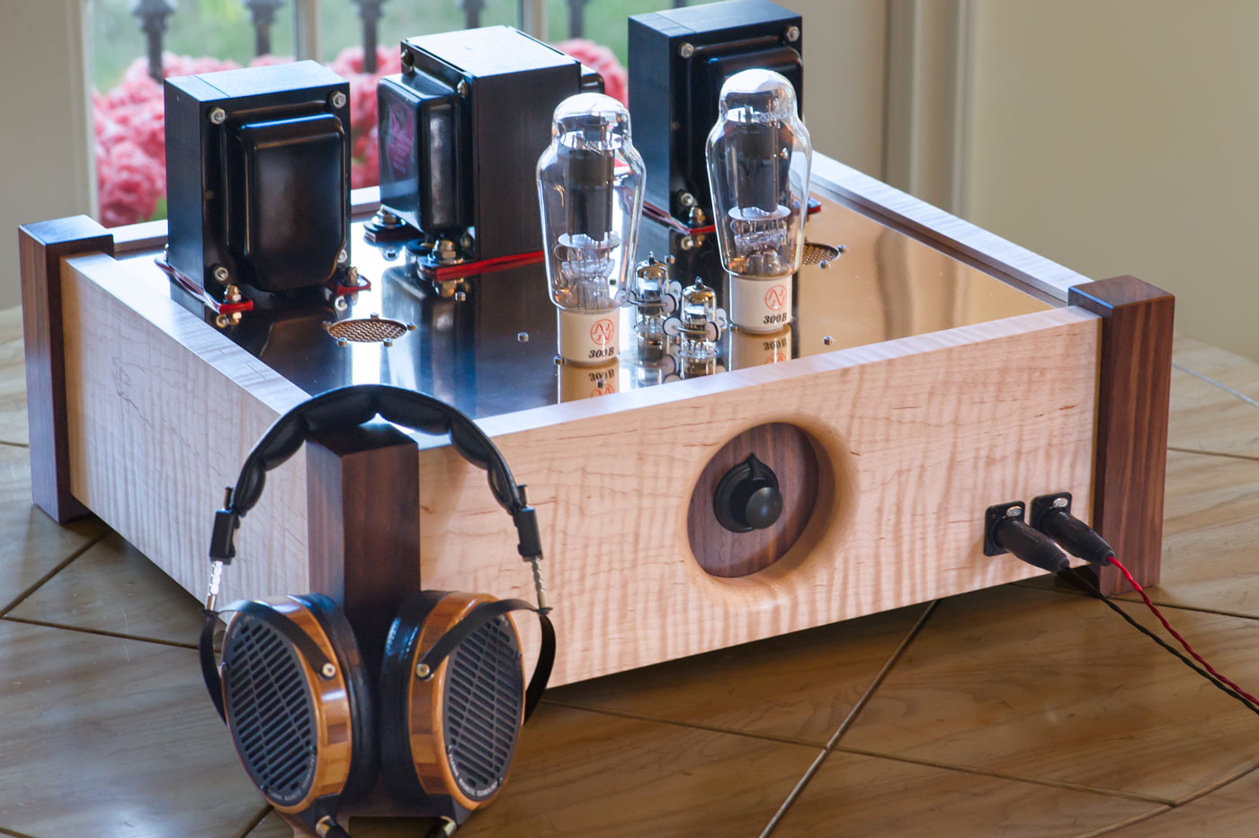

'Sceleratus' from Head-Fi.org was kind enough to share some pictures of his build. Polished bronze on burley maple with walnut corners. Bravely done! He's very pleased with the results of his efforts. He's using my 300B amp design to drive a pair of Audeze LCD2 magnetostat headphones.
