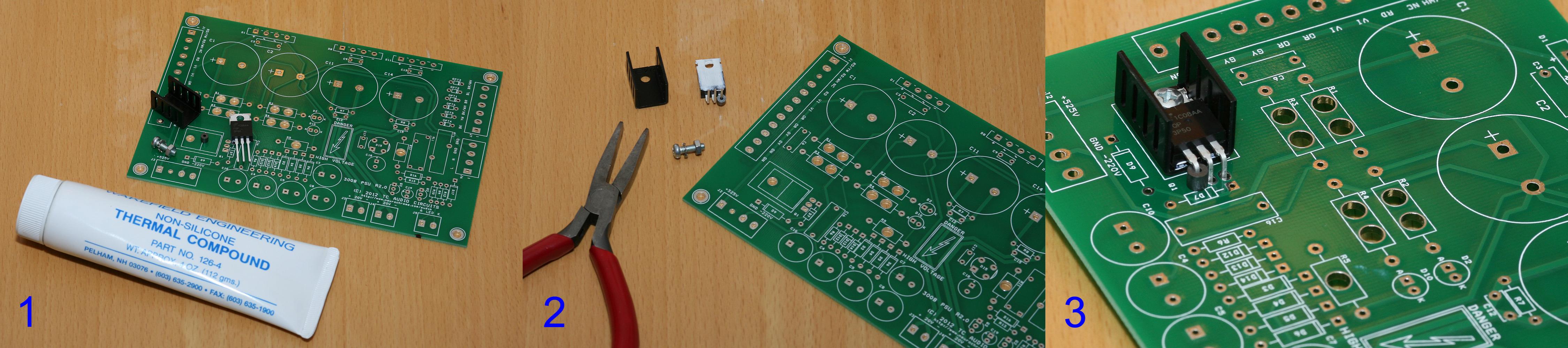

I promised pictures of how the ferrite bead mounts to the gate of Q1. See attached.
1) Gather materials: FQP3P50, machine screw (M3x8 or #4x3/8 is probably ideal), lock washer, nut, thermal goop, heat sink.
2) Using pliers, bend the leads on the FQP3P50 to a 90 degree angle such that the mounting hole and the pins line up with the respective holes on the board footprint. Apply a thin coat of thermal compound to the FQP3P50 and drape the ferrite bead onto the gate lead.
3) It requires a bit of skill and patience, but it is possible to get the FQP3P50 onto the heatsink and the combo aligned with the footprint on the board without losing the ferrite bead. Tighten the screw until the lock washer bites into the board. Cut and solder the leads.
Note: For the ultimate gory detail in the picture, right click on it and open it in a new tab.
~Tom
