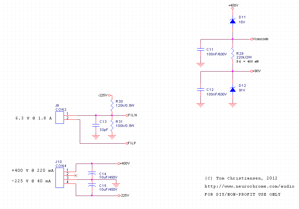

1) Vcascode - I take it that this is set at around say 30V less than +400V rail to limit the voltage across the LT3092 to less than its max 40V rating. Is that correct?
2) I haven't seen that MOSFET + CCS Chip style CCS before. Have you tried anything simpler for the CCS load (A Buddha CCS or something similar). I have no experience with CCS as anode loads but have used them a lot as diff amp tails and have never managed to get any better performance than a cascode bipolar transistor arrangement. Past a point device/lead capacitance becomes the limiting factor (at the high frequency end).

I've attached the "supply" portion of the schematic. This amp is fed from a +400 V regulated supply (I use my 21st Century Maida for this). The -225 V is generated by a string of zeners with a MOS follower.
Sounds like a good start for a project... 🙂
That's exactly right. I use Vcascode = 15 V less than B+, but you could use 30 V as well. You'd have less headroom for the input valve, but that's mostly of academic value. The circuit has more than 100 V of headroom. An extra 15 V isn't going to make much difference.
It's a standard IC-based CCS with a MOS cascode. There's nothing mythical about it. It just works... 🙂 And it's actually pretty simple. R1, R2 set the current. The LT3092 provides a current that is very stable with temperature. In addition, it's a quite low noise current source. C2 further rolls off the noise, and C1 provides HF compensation to improve the transient response. Q2 is there to keep the voltage across the IC to a reasonable level - it also dissipates all the power in that circuit. Heatsink needed!
I looked at a handful of CCSes before I settled on the LT3092. But most discrete CCSes are very temperature dependent and I don't like the idea of bias points shifting around as the amp heats up. I designed a couple of temperature compensated current sources, but they were all of higher complexity than the IC + a few passives and still required a cascode to survive the voltage. So I went "simple is good" and let Linear Technology worry about the temperature compensation... 😛
I did try the IXYS 10M45 CCS. That'll work too, but I like the sound of the LT+cascode much better. I speculate that the improvement in sound is because the output impedance of the cascoded CCS is much higher (orders of magnitude) than that of the 10M45.
I'm not familiar with the two circuits you mention. If you have a schematic, I'd be interested. I'm curious...
BTW, I intend to get some PCBs made professionally for this project. I'll be selling the excess boards from my website. I'm hoping to get the project done before Christmas, but would prefer to not make too many promises regarding availability date. Just letting you know it's in the pipe...
~Tom

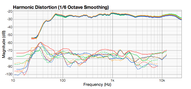

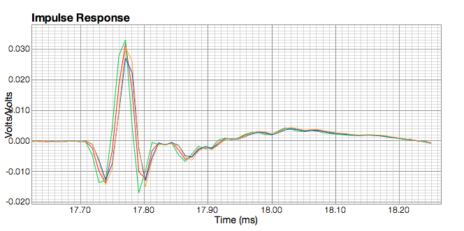

Folks,
I've tested d3A, ECC99, 6N6P, and 12BH7A as driver tubes in my 300B driver design. Attached are my end-to-end measurements (amplitude, H2, H3, impulse response).
RED = 12BH7A-300B
BLUE = ECC99-300B
YELLOW = 6N6P-300B
GREEN = LME49811-based sand amp for reference.
Measurements of the THD of the amp with resistive load reveal the following:
12BH7A: 0.39 % THD @ 1 W; 4.8 W @ 1 %; 9.7 W @ 2 %; 10.2 W @ 3 % THD.
6N6P: 0.16 % THD @ 1 W; 9.7 W @ 1 %; 11.4 W @ 2 %; 11.8 W @ 3 % THD.
ECC99: 0.18 % THD @ 1 W; 8.9 W @ 1 %; 9.6 W @ 2 %; 9.8 W @ 3 % THD.
The input tubes were biased as follows: 12BH7A: Vgk = -11.2 V; Ia = 12 mA. ECC99: Vgk = -6.0 V; Ia = 12 mA. 6N6P: Vgk = -6.2 V; Ia = 15 mA.
The cathode followers were running at 4.4 mA. For the cathode followers, Vak was roughly: 12BH7A: 230 V; ECC99: 125 V; 6N6P: 170 V. These voltages were chosen for optimal THD.
I'm surprised that the 12BH7A distorts so much. I wouldn't have thought that from looking at the plate curves. I'm guessing it has to do with the source follower. 12BH7A is not a very good candidate for a source follower due to its low gm. And I suspect it isn't entirely happy at the 4.5 mA I'm running through that source follower. I did try upping the current, but that made negligible improvement.
I'm thinking that the 12BH7A is probably better suited for 300B amps with the anode of the input tube (12BH7A) connected directly to the 300B grid (via a cap if necessary) rather than through a cathode follower. Maybe a source follower could improve the THD, but I have decided to not use a source follower as I prefer the sound of a good cathode follower.
Listening tests:
To my ears, on my system, the 12BH7A sounds a lot like the d3A. It's a nice tube. No question about it. It reveals a lot of detail, but to my ears, it's a bit fuzzy in the highs. The lisp on hard consonants is more pronounced. And at higher SPLs I found it kinda straining to listen to.
The ECC99 is nice as well. I don't find it as revealing as the 12BH7A/d3A and perhaps a bit harsh, but for a current production $15 tube, it's pretty damn good! This tube was my favorite until I was led to the 6N6P.
In my opinion, the 6N6P is the best compromise between harshness and precision. My amp likes that tube.
The end result is the same as last time I posted. My board will support 12BH7A, ECC99, and 6N6P by configuring a couple of wire jumpers. One can wire in a pair of d3As in place of an ECC99 if desired.

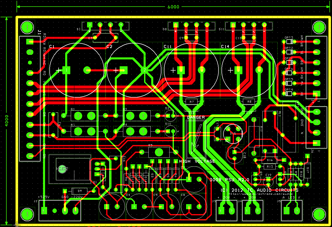

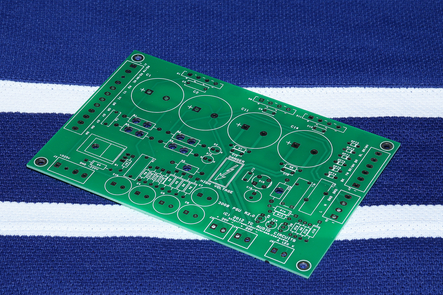

Pictures
Pictures of the supply board.
The supply board is intended for use with the ClassicTone 40-18069 power transformer available from Triode Electronics.
The board allows for selection of the following mains voltages: 120 V, 230 V, 240 V by moving a couple of wire jumpers. A soft-start circuit ensures that the inrush current is kept under control during start-up.
The output voltages are: 525 V (unregulated) for B+; -220 V (zener regulated) for bias; 2 x 20 V (unregulated) for filaments. In addition, an output for a POWER ON indicator LED is provided.
Now, of course 525 V and 20 V are too high for use directly. However, they're just about perfect for use with my 21st Century Maida Regulator for generating 400 V B+ and my Universal Filament Regulators for generating 6.3 V and 5.0 V. I run the two 5.0 V regulators from one 20 V output and the regulator for the 6.3 V off of its own 20 V output. Works great.
For those who wish to use lower B+ voltages, two wires can be swapped on the transformer secondary, resulting in an unregulated voltage of roughly 450 V. This would be quite suitable for regulated B+ voltages in the 340~380 V range.
The board measures 4.0 x 6.0 inches.
I'll follow up with a schematic and design notes in a bit.

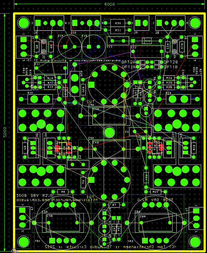

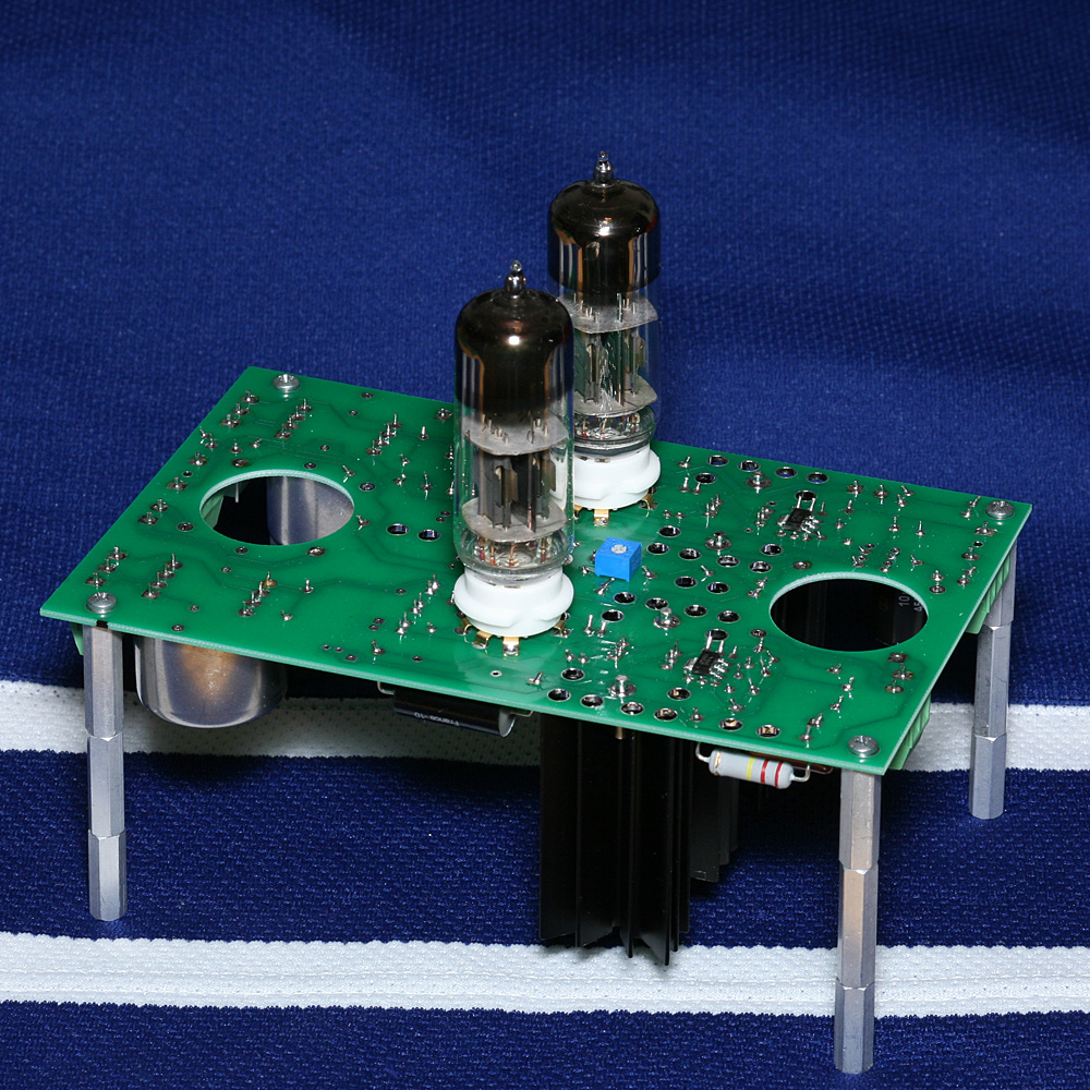

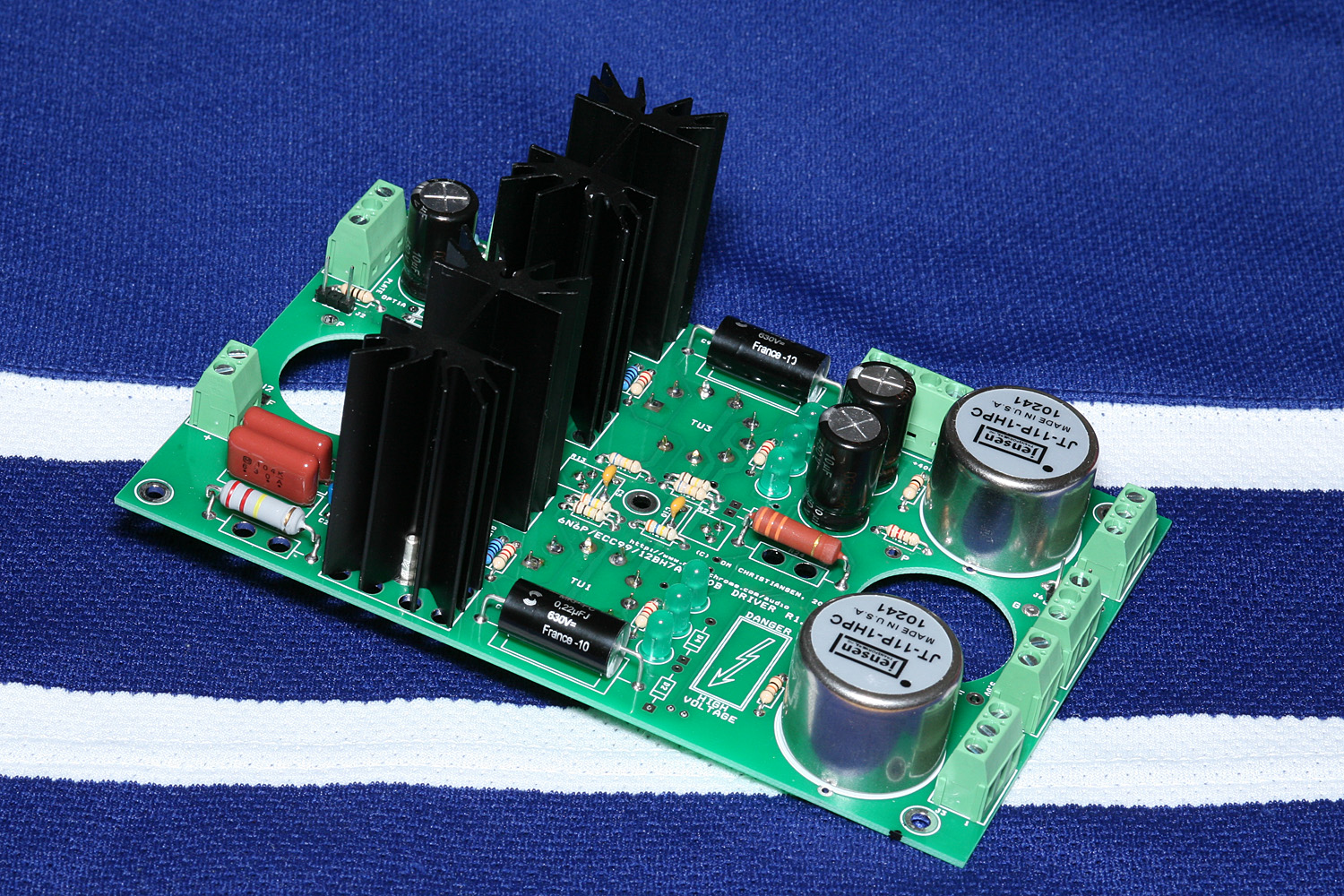

More pictures
And now for pictures of the amplifier board. Note that the tube sockets are mounted on the back side of the board such that the tubes can poke through the top plate of the chassis. The large cutouts are where the 300B sockets go. The sockets will be mounted to the top plate of the chassis and their pins will poke through the cutouts in the PCB. The pins will be connected by short lengths of wire to holes in the PCB.
In addition to the sockets, I've chosen to mount the bias pots on the back side of the board as well. That way, I'll be able to adjust the bias through a hole in the top plate of the chassis. You can mount the pots on the component side of the board if you prefer adjustment from the bottom of the amp.
All holes for components or screws that will poke through or require access through the top chassis panel are laid out symmetrically. This was actually a bit of a challenge, but I think it'll result in a really nice looking top plate on the chassis.
The 300Bs are 4.5 inches apart. The two driver tubes are two inches apart and centered between the 300Bs. It's a pretty neat and compact layout.
The board allows for use of a Jensen JT-11P-1HPC input transformer. If you would prefer a single-ended input, the board supports the use of an input capacitor instead.
The board has direct support for 6N6P (as pictured), ECC99, and 12BH7A. Switching between tube types require swapping a couple of components and wire links. The board may also be used with d3A tubes, though, this will require some creative wiring to connect two d3A pentodes to a socket that's intended for use with a dual triode. I've done it with good results, though.
The board measures: 4.0 x 6.4 inches. The cutouts for the 300B tube sockets measure 1.15 inches in diameter.
~Tom
Boards available for purchase on my website: http://www.neurochrome.com/audio
For a stereo amp, you'll need:
One (1) 300B_PSU_R2p0 300B Supply Board
One (1) 300B_Driver_R1.0 6N6P/ECC99/12BH7A 300B Driver Board
Three (3) FILREG_3P2 Universal Filament Regulator Boards
One (1) MaidaReg_1P0 21st Century Maida Regulator Board
I'll follow up with the remaining design collateral over the next couple of days.
