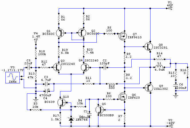

Well, I was not aware of this design until a week or two ago, for, as soon as I see words "gain clone" anywhere in title, I am skipping that for sure. This time I was wrong.
Interesting modification of very recognizable old Walker's Current Dumping concept. That has inspired me to investigate some further possibilities, but that doesn't necessary mean they are improvement, even thou some of them might turn out like that. Here are a few ideas as a humble contribution to respectable Widowsmaker's efforts. Please note that they are still JUST IDEAS and none of them has been built and tested by me yet! But some will be!
My thoughts were mostly oriented around three issues:
1.Good quality, very linear and low noise small signal BJT-s should perform at least equally well in differential amp stage, and they are more readily available (and affordable) than good quality JFET-s. That could make life easier for most DIY enthusiasts.
2.I am not very sure about sonic qualities of 78L15 in that position, which shouldn't be taken as my disrespect of otherwise quite clever idea to solve elegantly two functions with one component!
3.More chance should be given to the Class A stage to process and provide power for a first few watts, because up to a moment when Class C dumpers "jump into the game", amp is practically working as a pure Class A. Many people are praising importance of those "first watts" hence, it might prove beneficial to let them to be processed by Class A stage.

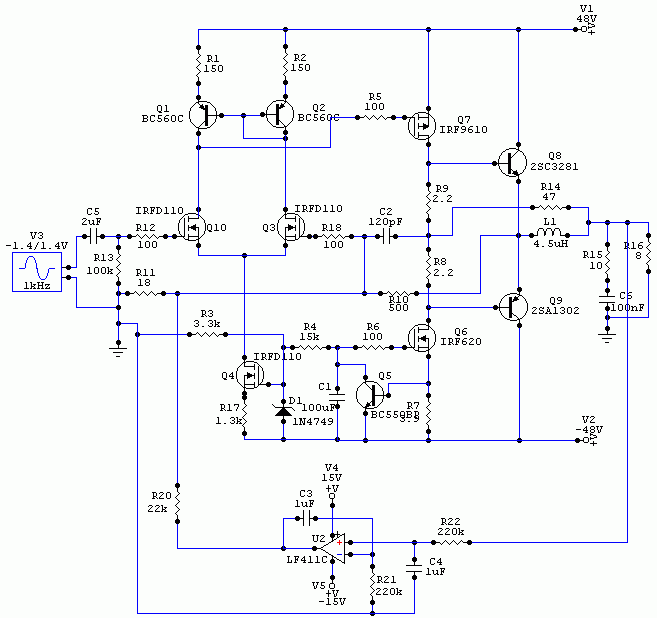

I like the second proposition 🙂
Somewhere in the beginning of the thread I suggested the use of small MOSFETs (like IRFD110, 120, DS107, BS170) instead of the input FET pair.
They may have higher noise (but should still be very small in this application!) but being enhancement devices, it is easily possible to increase their gm over that of the FETs by increasing the tail current of the LTP, subject only to thermal limitations.
This has a twofold advantage:
1) higher gm increases OLG in the first stage (a good discussion why this is interesting can be found in the 'simple killer amp' thread), in fact, it would even be possible to increase it sufficiently to degenerate the MOSFETs some and linearize the LTP.
2) Higher tail current also means higher current available to drive the MOSFET 'VAS' stage. This is quite important as the LTP + current mirror sees the whole Cgs of the MOSFET, PLUS the Cgd of the MOSFET subject to miller effect! Both are quite large even using a IRF9610.
I have used small MOSFETs in amp input stages a few times with great success, I think this could be a very interesting alternative to the FET input pairs.
I also happen to share Bora's misgivings re 78L15, although I have to admit without reserve, the setup is clever! LM317L may be one alternative, but even it is not close to a good discrete CCS.
Finally, having first constructed my own variant of the Walker circuit some 14 year ago, I have to agree with Bora that bringing the output stage closer to class B or even into class AB has benefits. Many who have built QUAD 405 clones know this as one of the proposed mods. The problem with this is, however, implementing it simply 🙁 but splitting one leg of the bridge (C2, R14 in Bora's second schematic) into two parallel components and putting a Vbe multiplier between them, may be one way to do it. That being said, the amp loses it's appeal of having no adjustments, that way...

ilimzn said:I like the second proposition 🙂
1) Higher gm increases OLG in the first stage

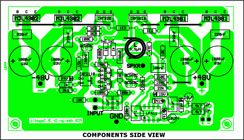

I believe to have ready PCB for a version with my modifications in a day or two, and I will post it here for everyone, without any charge as usualy! As far as I know, original PCB's by widowmaker has been already posted here ?!
No! As I stated before, I haven't tested that yet but now that I developed PCB it will happen in a few weeks. I have no doubt that it will work properly, for, I can see no obvious reason why shouldn't it. Frankly, I believe it should work even slightly better by all means, but, am I too optimistic or not, we will see!?

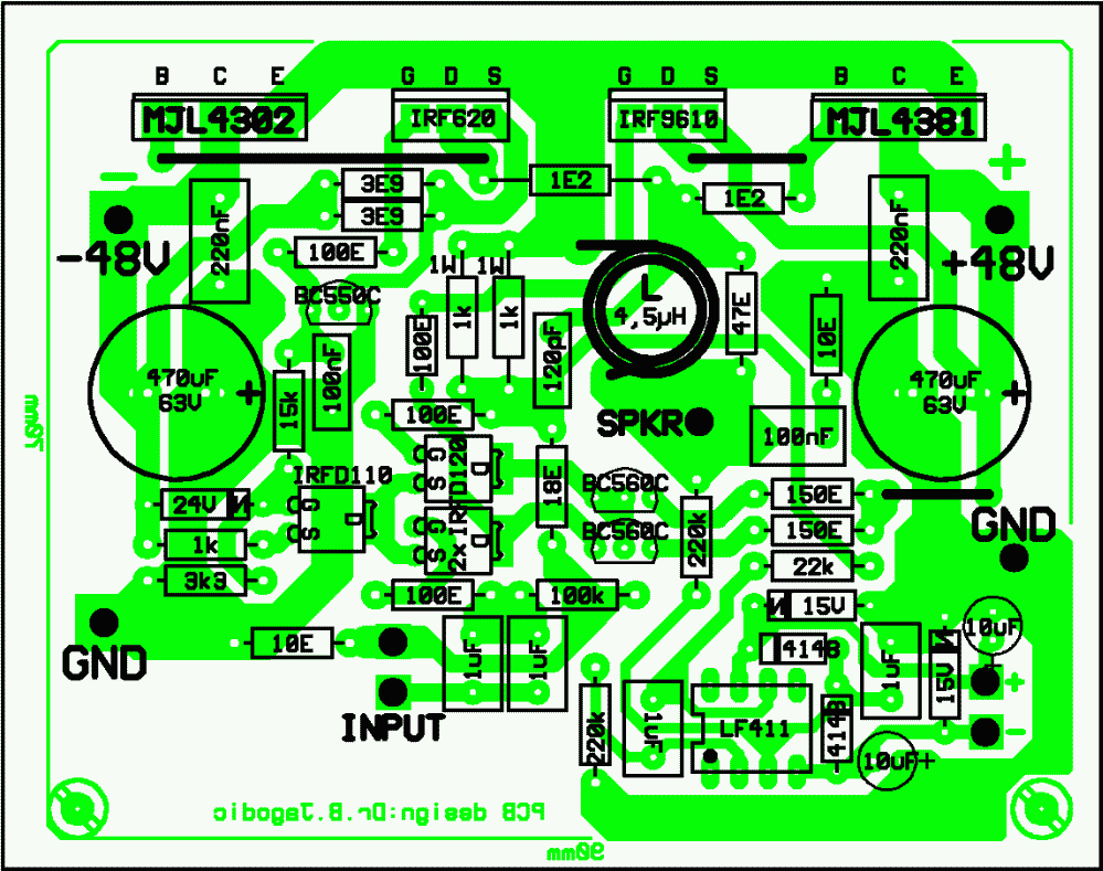

Knowing that sooner or later some younger, always power hungry enthusiasts, will come to idea to ask for mod's to reach higher power levels, I've done another PCB to accommodate 2 pairs of output BJT's. Layout drawing will come soon... maybe even today!
I hope that widowmaker would have no objections for my intrusion into his design, for there were no other intentions but to make one really good design maybe slightly better if possible!
Boraomega, you may have a problem on the 4 BJT version - even with a CD configuration, you still need emitter resistors for proper current sharing. 0.1 ohm would probably already be enough given the MJL BJTs gain characteristics.
Thanks ilimzn. I was thinking about that issue, but on the other hand, I presumed that someone serious and determined to make really high quality amp will (to my opinion) at least try to obtain well matched output devices, for there are sources-suppliers this days that will match on demand, components in your order for some reasonable additional charge. Your point is still more than valid for all others attempting to do the amp without matched output devices! They will have to have emitter resistors to avoid disappointments and costs! Therefore, they will either have to do modifications of that PCB by themselves or, if there is any higher demand, I will do that and publish it here, again free for everyone.
