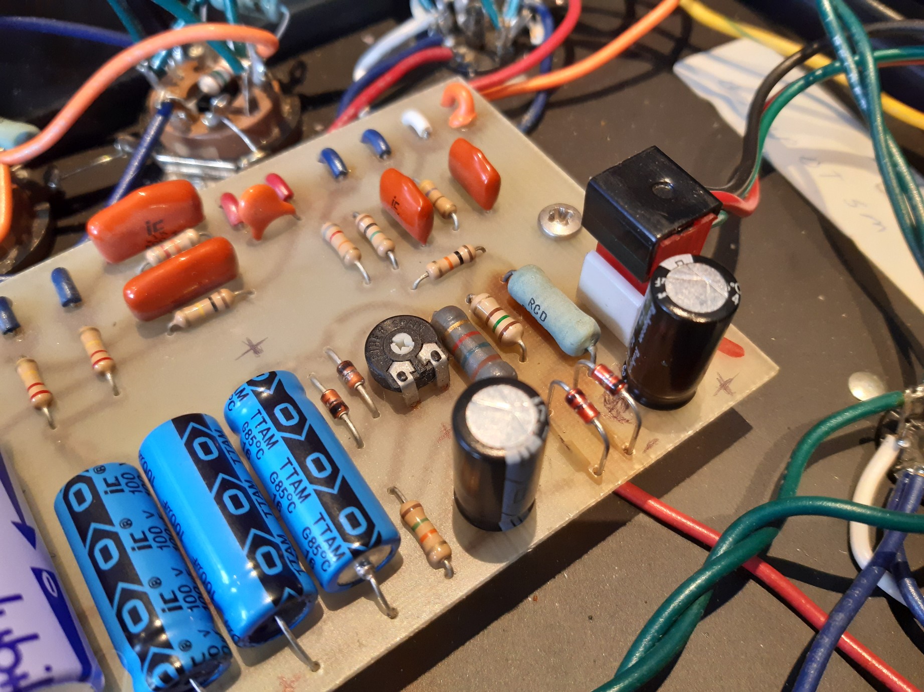

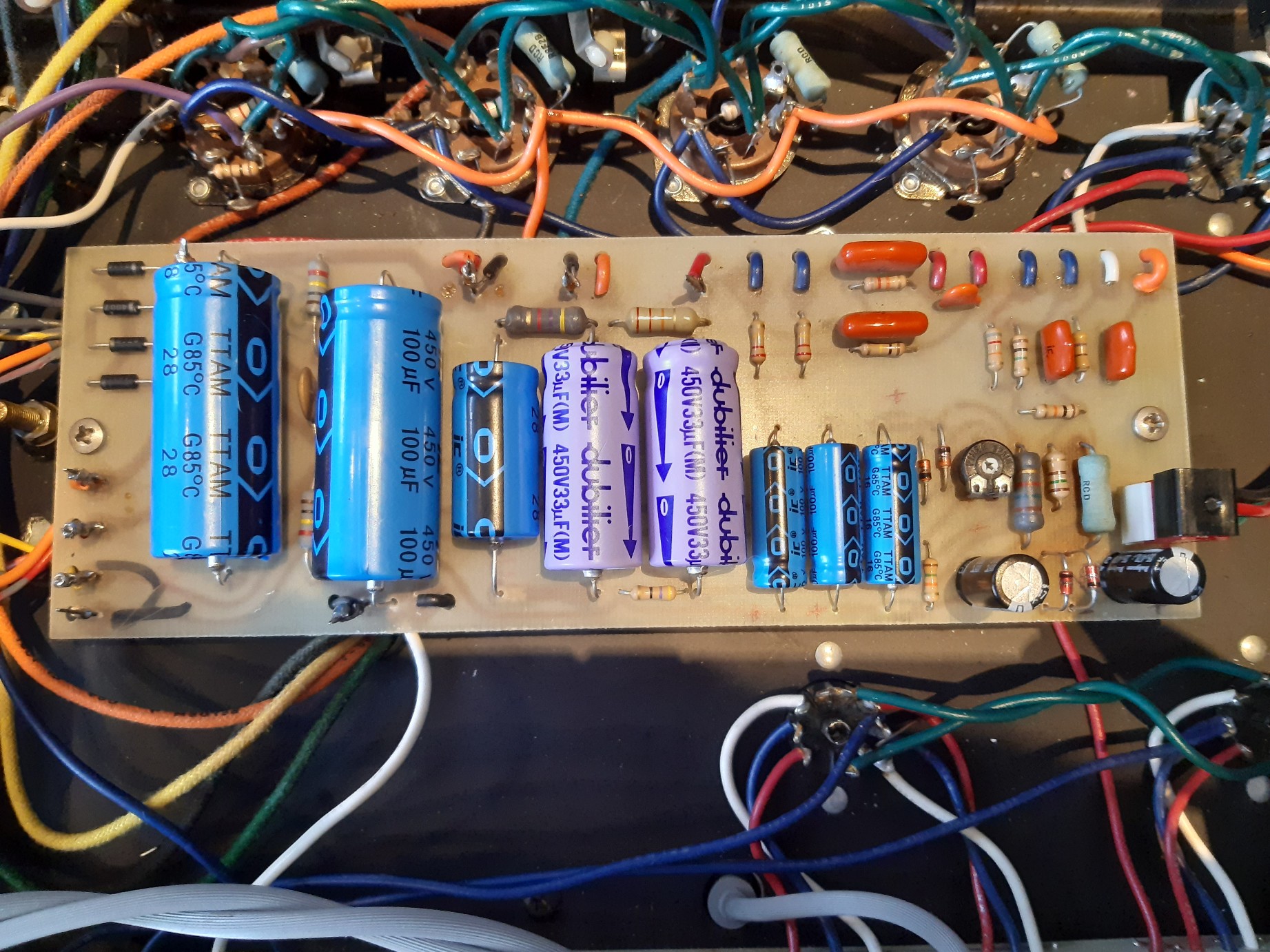

1. 18V zeners replaced with 18V BZX85 1.3W (I have some 5W 1N5343 but I think the lead diameter will be too large for the PCB drill hole)
2. All PSU caps replaced including the low voltage radials (I could almost upgrade these, as the size reduction is quite significant).

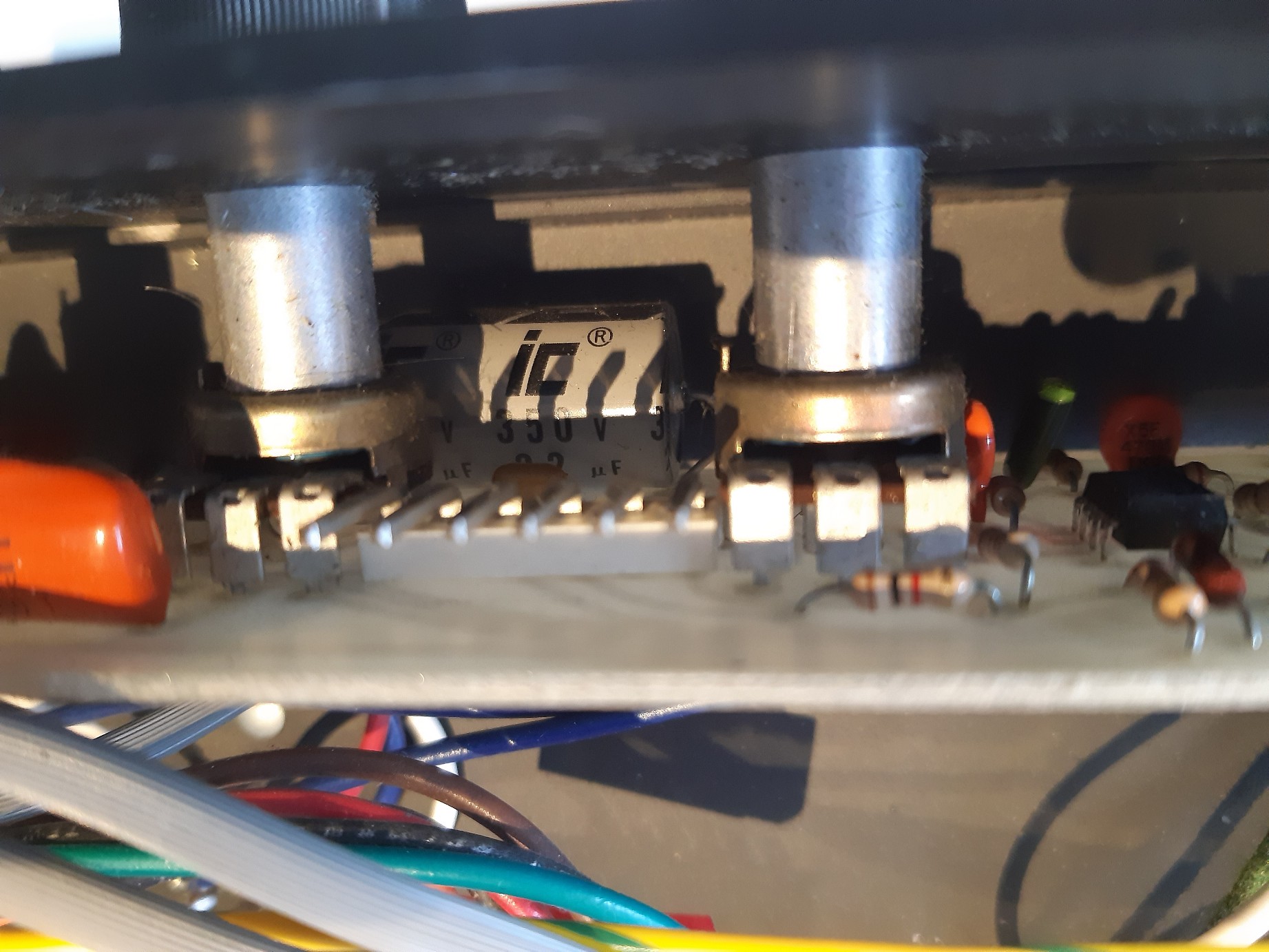

All caps except one I forgot in the preamp circuit (last pic) doh.
That's only 22uF 350V (rather than 500V) so a 500V 22uF Miec will go in there.
The two "warm" 1k6 2W resistors I've left until I get some to replace then with (I planned an order and yes I forgot to order the cheapest items)

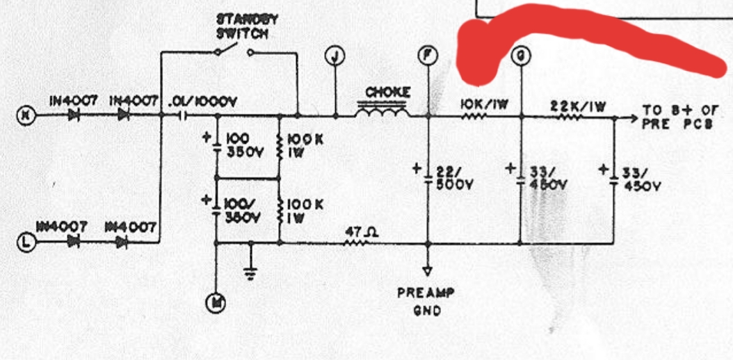

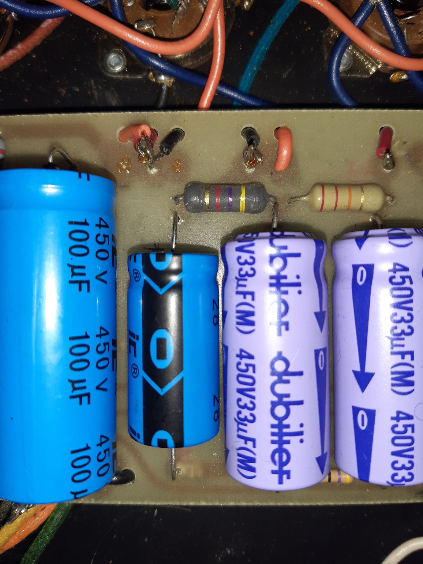

Eureka!
I think I have found something amiss after all.
Upon looking at the PSU board, the resistor between "F" and "G" voltage taps, is not the same value as the schematic for the CD120 (posted earlier).
The schematic value is 10k, and lo, I have 4k7.
I initially thought that maybe it was 10k for the CD60 and then 4k7 for the CD120 amplifiers, but I'm not 100%.
Now I dont think it'll do a lot for the higher than usual B+, which maybe due to a replaced power transformer earlier in its life, but it may affect the preamp stages in particular.

BTW, mine has the 4.7K 2W in same location in the power rail as yours. I believe that is the stock configuration for the T120-R. Also, the schema calls for 1.6K 2W for the +/-18V rails, mine also has 1.5K 2W and 1.2K 2W in the same locations.

That's interesting that the PSU is your amp also has the 4k7 resistor... perhaps I might return it to 4k7 in that case....

Other things to look out for are heat damage to the right hand side of the PSU PCB. The zeners near the bias trimmer, are prone to getting hot, as are nearby resistors.
No doubt this was worsened in my example amplifier, as the voltages were all high. I havent found original voltages, nothing is noted on the drawings that I and others have submitted to this thread.
