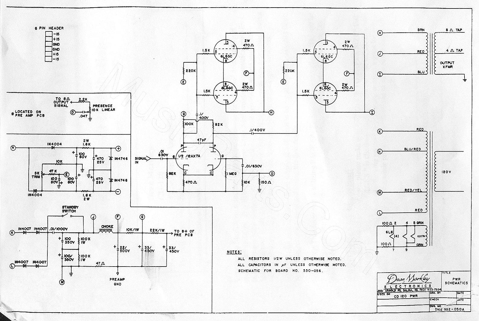

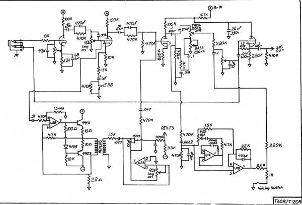

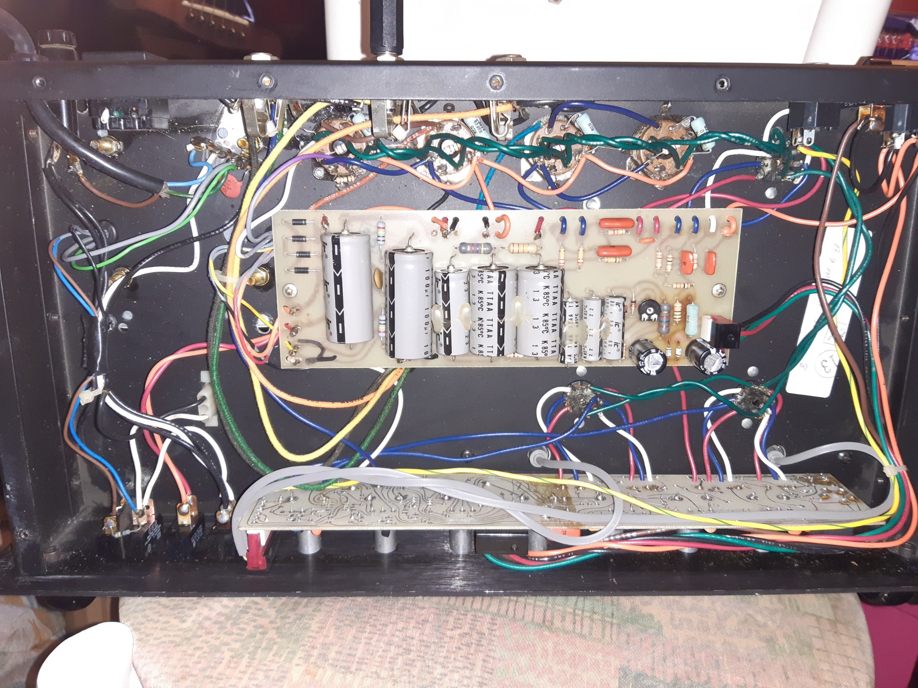

Here is some photos and what schematics I have, the original links in this thread are probably dead.
Shown in the photos:

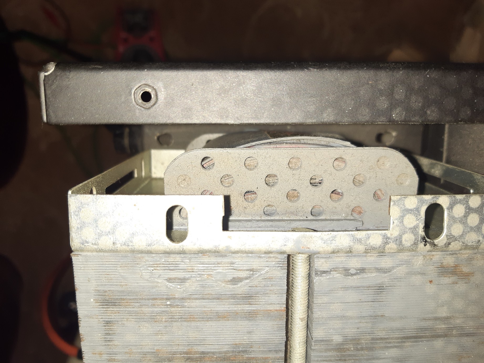

It appears, that the power transformer has been changed at some point, though curiously the QC date is 1985. There are extra holes drilled the the chassis. It's taken years to notice that...
So in really need to measure voltages at all stages, although there are no hints of correct voltages on the schematics, I'll have to apply some common sense....

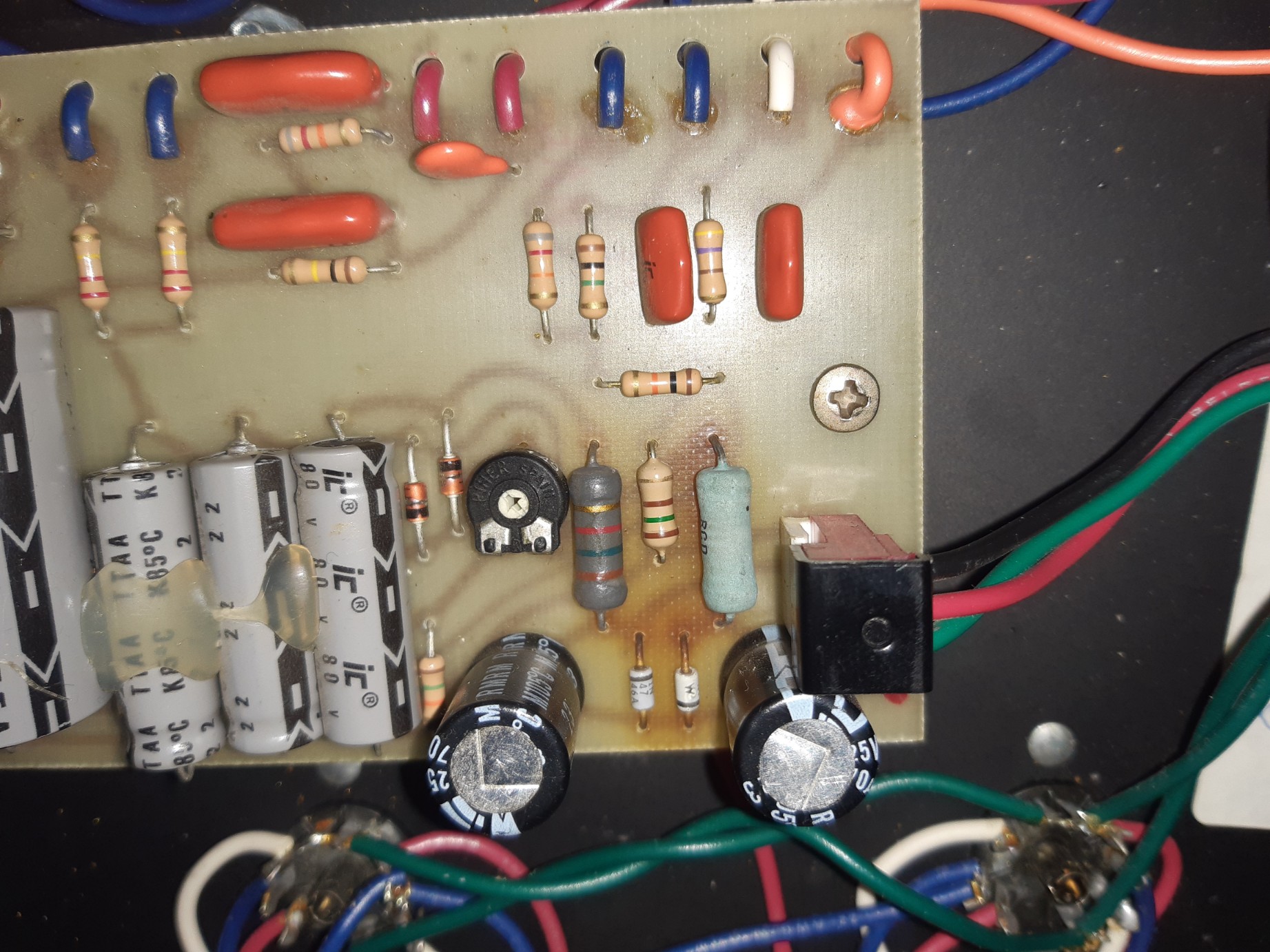

Also you can see the somewhat shoddy heater wiring, or wiring in general if I'm honest. I'd like to tuck that heater wiring up around the outside of the chassis, out of the way.
Also the browned board area is shown. This board is serial 550 056, which is referenced on the CD120 schematic

It looks like the 1k5 2W resistors are dropper/filters for the semiconductor analog electronics. They are likely to each pass about the same current (ie. voltage across them). If a semiconductor part fails then they could be heating up excessively, or the mains supply is a bit higher. Either way, best to raise new resistors off the pcb so that air can circulate, and the solder joint and pcb traces won't be at as hot a temp. Certainly make sure you reflow all the solder joints near that heat stress, as old solder joints that are heat stressed could cause problems.

I plan to lift both these two resistors (marked 1W) and 18V zeners (again 1W), and replace with 2W devices, and elevate from the board surface as you suggest.
As far as the mains input, and suspected power trafo replacement at some earlier point in time, I have a couple of ideas for the future:
Use amplifier with isolation transformer (0-230-15: 230) to drop mains voltage to 230V average (my mains runs at 245V quite consistently)
Insert longer series chain of diode at the AC input to the PSU board (currently the amp uses 2 1N4007 in series, why? Do we need the PIV?) So it's possible I can lower the B+ a few volts this way and bring everything back into check (voltages UNDER the rating of electrolytics!!!)

Yes originally the DM site had a support section, which lead to a repository of their amplifier schematics (its some time ago, so this is perhaps a flawed recollection)
At the time I couldn't find a schematic matching my amplifier, when DM support put me in touch with a contact, who informed me that these were developed from the CD60 CD120 and Spectra amps before that.
This chap pointed me to the schematics I have now. These got lost in several HDD failures, but a couple of hours googling and I found them again.
(Seems my original thread may have helped proliferate the schematic throughout the interwebs! Good thing for me or else I'd be stuck guessing)
