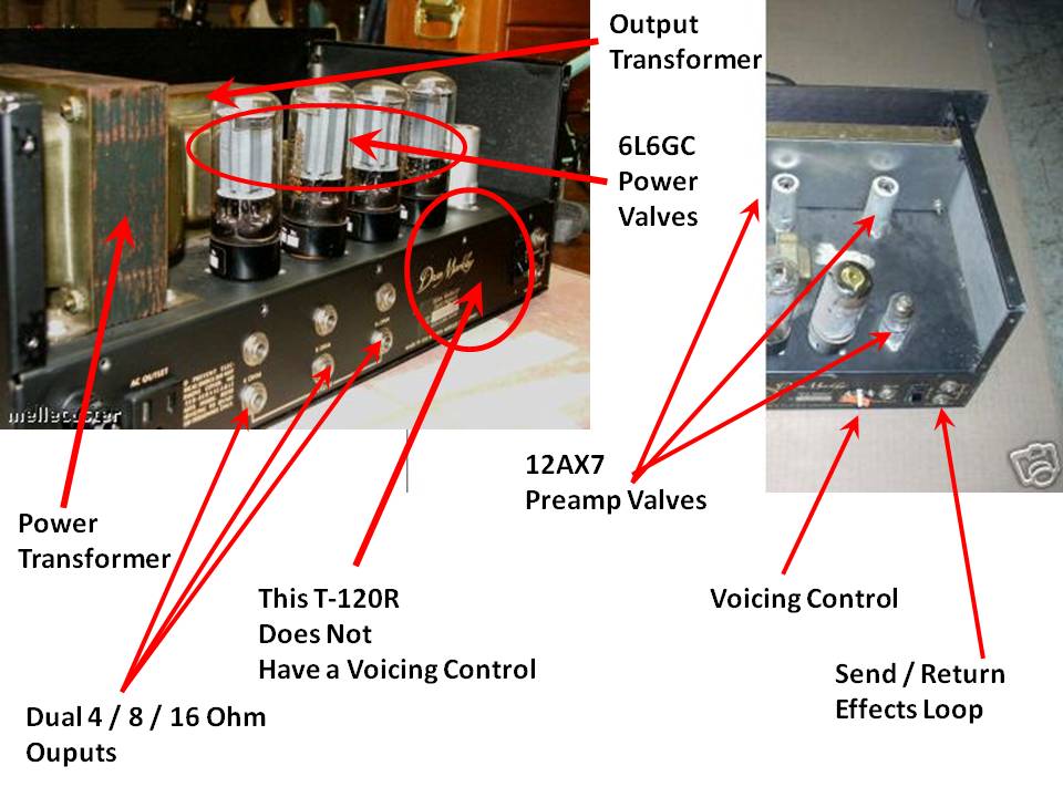

The next photos show the output valves. All of the valves in general seem fairly old, though not really smokey.
The writing on all the output valves, as well as the pre amp ones is very hard to read. The pre's are all " GE 'Electronic *something* " 12AX7, The left pair of output tubes are " PM '6L6GC' ", and the right hand side pair read something like " PhillipsECG '6L6GC' ", and also the letters " ha AGX "
If you look closely they have radically different structures inside, and the Phillips ones look very interesting. I know little about valves but I look of them better.

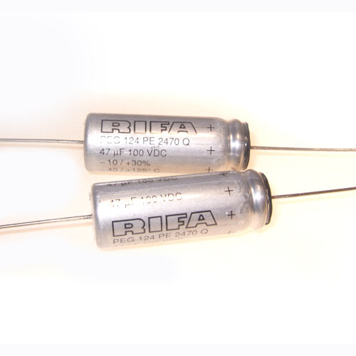

On my T-120R in the PSU section I replaced the electrolyic capacitors with RIFA brand. They are one of the few that are high voltage and appropriate quality. While I was upgrading the amp I had started to build a duplicate using a form of tag-boad construction. The idea was to end up with a Dean Markley clone. Ideally it would use turret board or eyelet construction. Also I would add any improvements the the clone amp. It is much easier to clone an amp when you have an original amp.
Your left hand pair of 6L6GC power valves look like a 1st generation Chinese type because of the coke bottle shape. Mine came with 4 Sylvania 6L6GC. Philips 6L6GC are also original quality type. When I retubbed after studing all the available new 6L6 types I ended up using Winged-C (SED). I wanted a tube that reproduced sound accurately and that was had good bass reproduction, since I occassionaly played bass through the amp. I found the Winged-C also handled the mids and upper frequencies well. I was especially impressed with the top-end frequency tone. It outlined the 2nd-order harmonics with a sweet sound but not cutting edge glassy. Almost a floating bubble 3-D effect. Mine also had GE 12AX7 in the reamp section, which would have been the original valves.

To replace electrolytics you can use Illinois Capacitor, which is original and still available or swap out where possible most of the values for a higher quality cap.
1 x 22uF 500V
.....Evox Rifa Peg124 is not available in this value
.....Illinois Capacitor 22uF 500V axil is same as original and still available - common in guitar amps
.....F&T Capacitor (Germany) 22uF 500V axil is a bit higher quality option
2 x 100uF 350V
.....Evox Rifa Peg124 Series is not available in this value
.....Sprague Atom 100uF 450V should work
2 x 33uF 350V
.....Evox Rifa Peg124 Series 33uF in 400V or 450V or equivalent
3 x 100uF 80V
.....Evox Rifa Peg124 Series 100uF 100V or equivalent
2 x 470uF 25V
.....Evox Rifa Peg124 Series 470uF 25V or equivalent <--- I've put an axil value here but was thinking this might be a vertical mount cap? I forget...

An interesting technical fact learned from this sale is that JJ 6L6GC are too tall for this amp. The current owner then describes how the protective grill that covers the top and back has to be left off. He then goes on to say that he read that many people leave the grill off and it is only needed in a rack-mount installation. I've never heard of this before and more than anyone I have trolled the Internet for info on this amp. Quite simply one shouldn't use JJ 6L6GC tubes if they are too tall to fit inside the DM T-120 enclosure. He should have returned the tubes to the supplier and purchased another brand of tube. Personally I wouldn't have selected JJ tubes even if they fit.

1 of 1uF 50V (radial) RUBYCON|50ML1MEFC4X5|CAPACITOR, 1UF, 50V | Farnell United Kingdom
1 of 22uF 350V Buy Aluminium PEG124 axial Al electro cap, 22uF 450V Evox-Rifa PEG124YH2220Q online from RS for next day delivery.
Since I work in power conversion, (commonly converters use 690VDC in DC link feed, and required Cap filtering) I may ask some of the purchasers, for a source for the 500VDC 22uF, and 350VDC 100uF, just to see if they know any other vendors that I am not aware of (RS,CPC,Farnell are about all) with any luck I may find something suitable. Pity they HAVE to be polarised, since I could get hold of PP caps for these values very very easily
1 of 22uF 500V A right royal Pain to find!!!!
2 of 100uF 350V VISHAY SPRAGUE|53D101F400JL6|CAPACITOR, ELECTROLYTIC, 400V | Farnell United Kingdom
(bloody expensive! only other options involve paying £15 swhipping charge per order from US!!!)
2 of 33uF 350V Buy Aluminium PEG124 axial Al electro cap,33uF 450V Evox-Rifa PEG124YJ2330Q online from RS for next day delivery.
3 of 100uF 80V Buy Aluminium PEG124 axial Al electro cap,100uF 100V Evox-Rifa PEG124PF310VQ online from RS for next day delivery.
2 of 470uF 25V (radial) RUBYCON|25YXF470MEFC10X16|CAPACITOR, 470UF, 25V | Farnell United Kingdom
Your selection of caps does closely match mine. I like the Peg124 better than Sprague but as we both saw they don't make that one value. I thought that 470uF 25V was a radial. I bought my Evox Rifa from RS Components in Australia. I think I also used the Rubicon radials in those values.
After I soldered the axil capacitors in place I then put a dab of clear silicon between the caps (at the top edge) to add stability.
yeah the originals are hotmelt glued together, and I have a glue gun so may well go with that.
