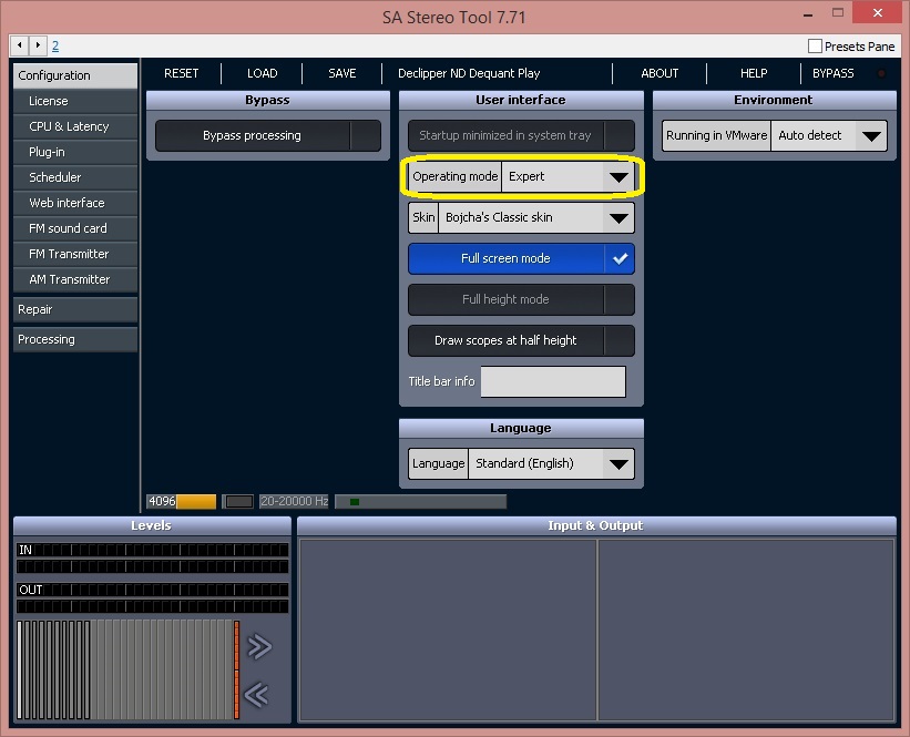

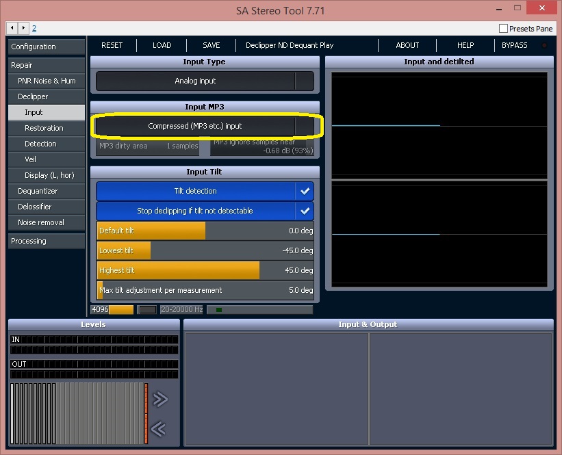

De-mastering smashed recordings with Stereotool (Loudness War)

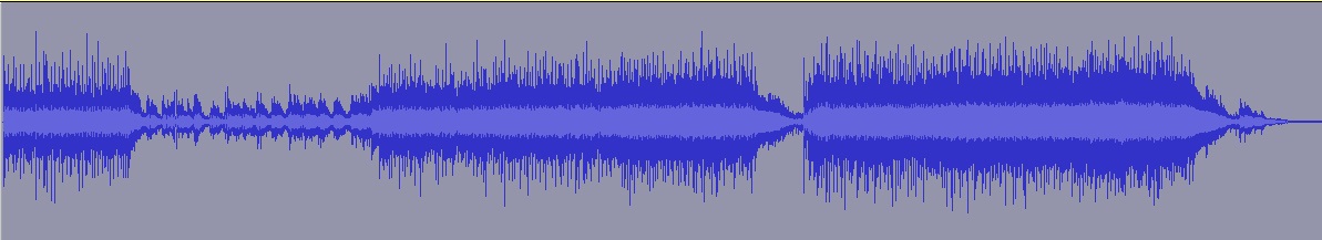

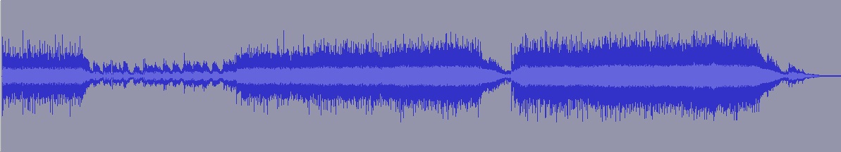

This last one is more interesting because it shows a multiband brickwall in action.
Bass content is clipped but some high frequency content is preserved.
attachment.php
So I have no idea what a declipper does to signals that weren't clipped but actual soft limited. Your are using an effects box.
Sorry, no... a declipper does nothing on soft limited waveforms... it tries to reconstruct the clipped part of the waveform based on various tecniques like interpolation, spectrum analisys, surrounding unclipped data.

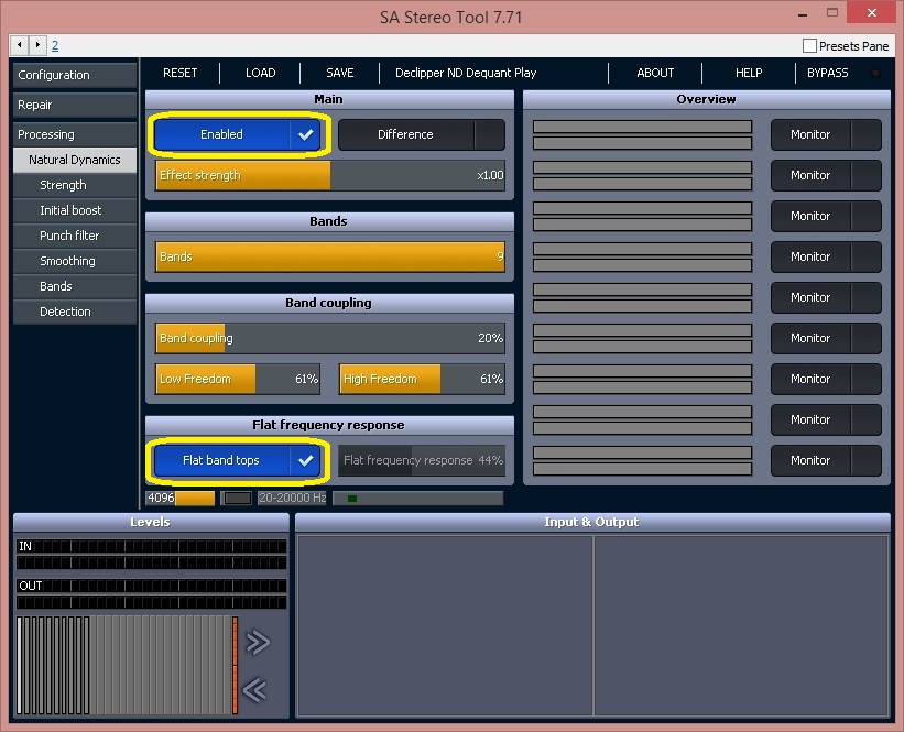

The Natural Dynamics filter it's indeed an 'effect box', a very smart one though.
BTW the whole world of audio engineering is made of effect boxes, to name a few:
Equalizers, Compressors, Limiters, Exciters, Reverbs, Dithereres, etc.

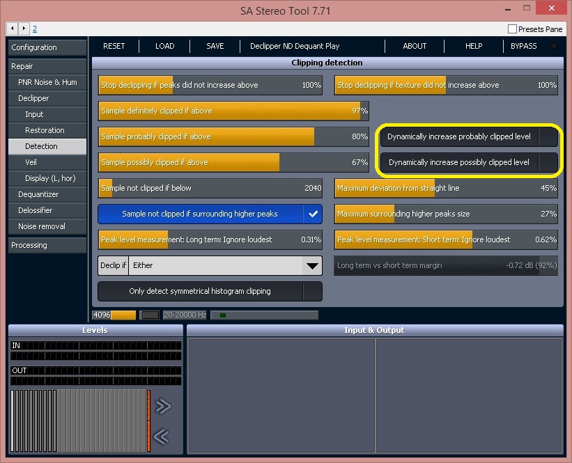

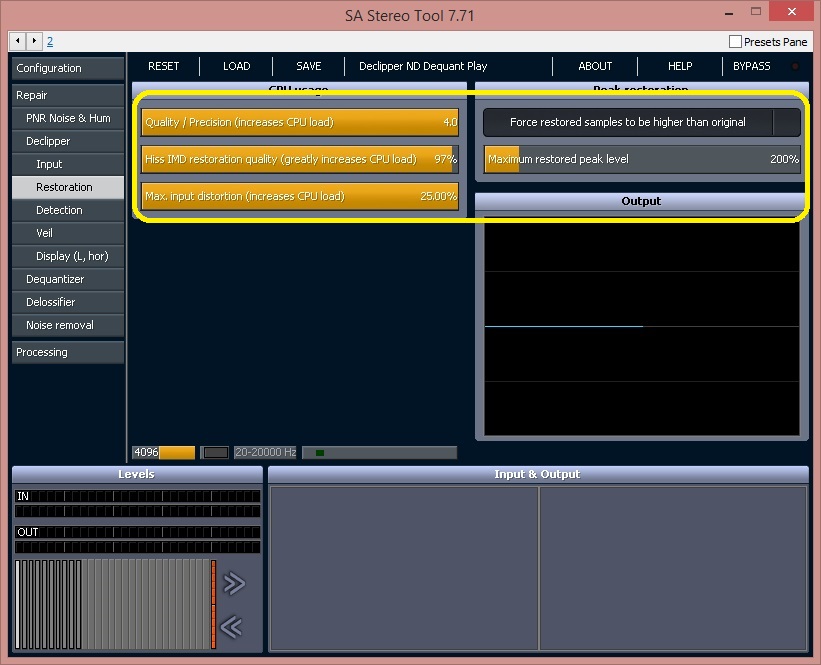

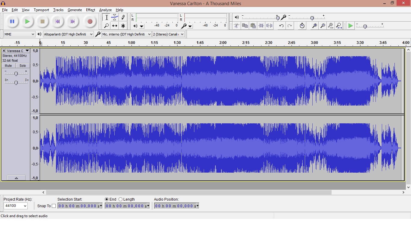

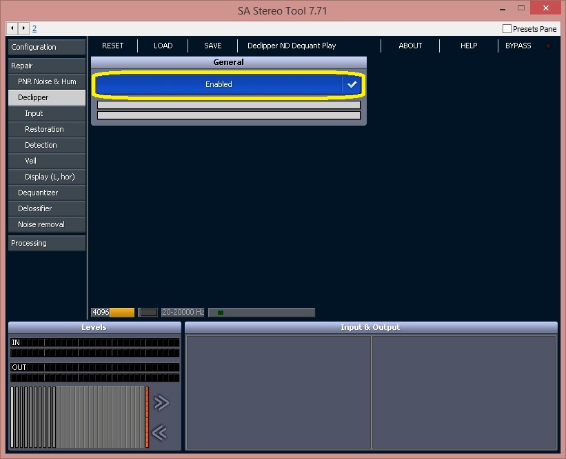

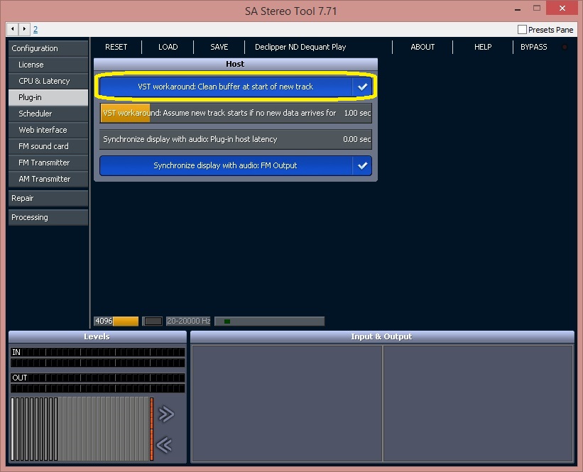

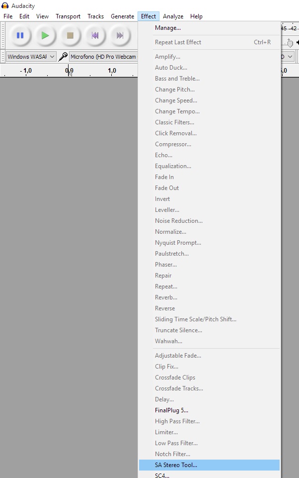

We agree that we can't recover completely the original waveform before the crazy mastering 'best practices' of the last 20 years but something can be done to reduce distortion and recover some dynamics.
The result is not an 'effect box' but a waveform which is less distant from the original and more enjoyable to listen to.
Maybe you should try and tell us your opinion after. 😉

So far we didn't lost resolution since we worked at 32 bit resolution but the output, usually at 16 bit, will loose some details.
The waveform can (and should) further be optimized maximizing the waveform to 0.1-0.3 dB ceiling and applying dithering so to loose less details as possible.
StereoTool Clipper do a nice job but Wavearts Final Cut do better and have a professional ditherer too.
Also we should apply some soft-limiting (1 to 3 db under the max peak), the software don't necessarily recover all peaks.

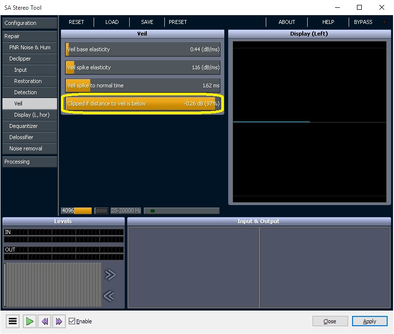

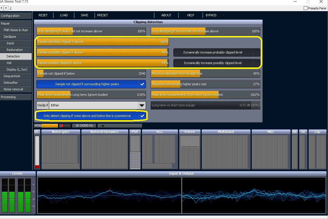

Sometimes I get a weird distortion bass sound after declipping (specially in bass heavy songs) or found some samples that clip AFTER the declipping that were not clipping before. Do you know any way around this or why it happens? 🙁
Mhh, regarding that weird distortion would be nice to have a screenshot of a waveform which does it, or a song name so that I can try too...
Regarding the clipped waveform after declipping, it depends on declipper paramters and after declipping you should apply some sort of limiting to remove excessive peaks.
More info, please 😉

BTW looking at the waveform it seems clipped and high pass filtered so that it became 'tilted'... adjusting tilt values could help but only if you already set 'detection' settings like this:
Can you share the Stereo Tools settings you used?
