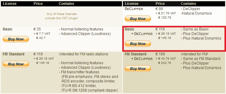

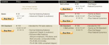

Don't use the registered version?
Ah! You meant which license!
attachment.php
I have the basic+declipper version.
The only needed version you'll need is the Declipper license, it will work for StereoTool too but you'll miss the Advanced Clipper, which can be useful for the light limiting after declipping the waveform.
Obviously you don't need the Advanced Clipper if you use another plugin for limiting and dithering, like WaveArts Final Plug 5.
I'll post later some suggestions for external limiter and dithering plugins, both free and licensed.

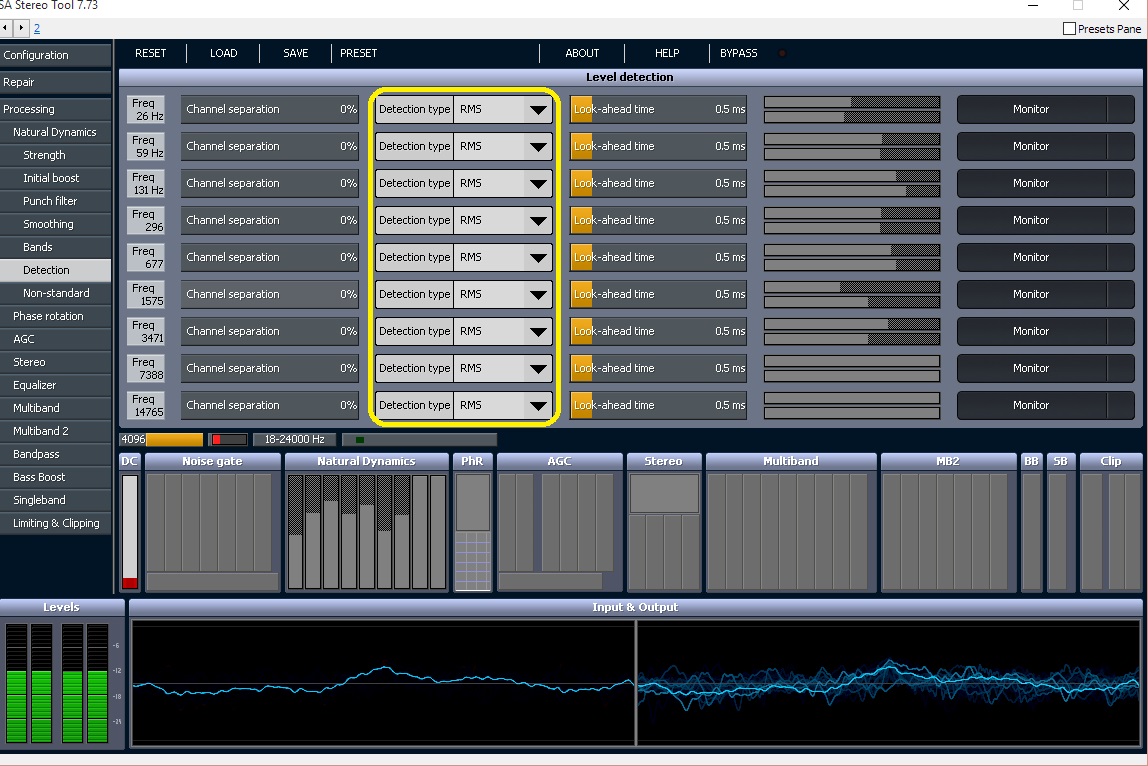

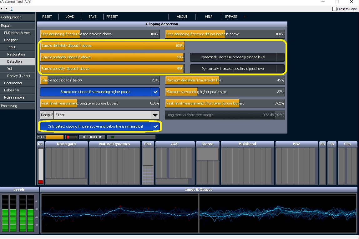

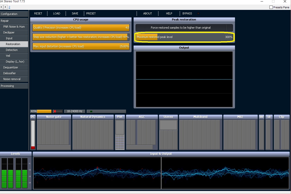

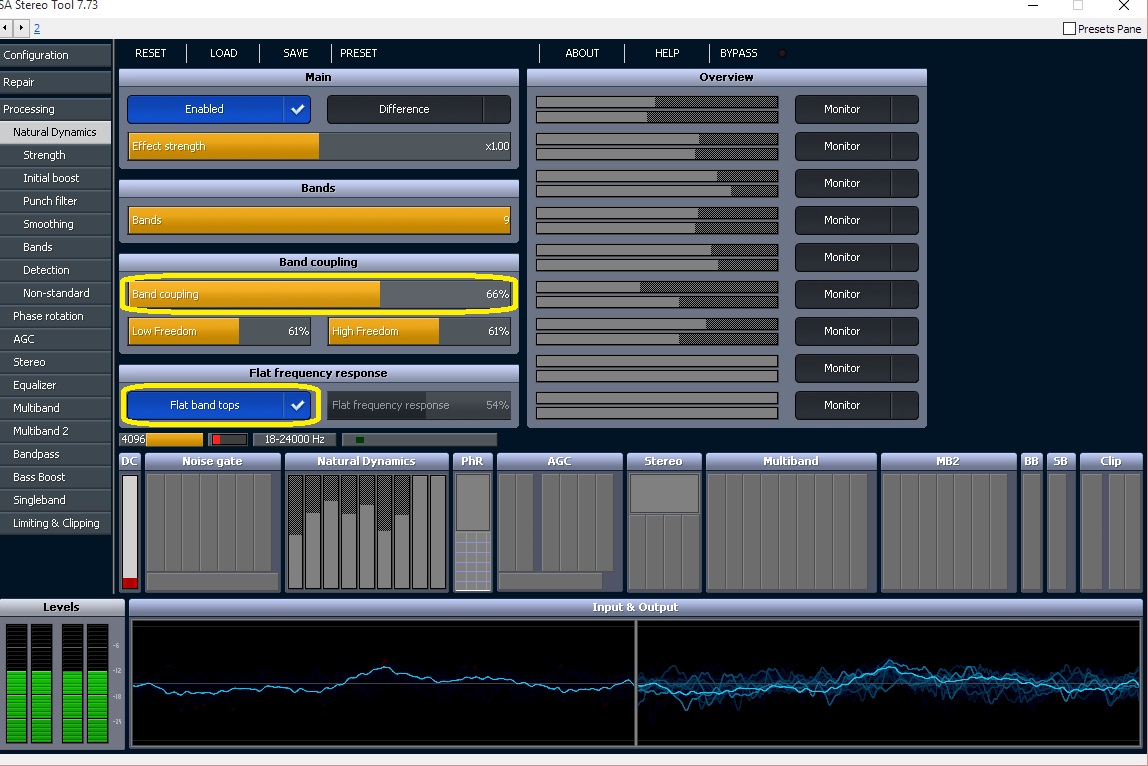

Fine tuning
While playing with limiters and ditherers I'm also further fine tuning settings of the declipper and, most of all, of natural dynamics.
Default settings for natural dynamics are a bit too hard making recordings too much 'snappy'.
Interim (experimental) new settings:
attachment.php
attachment.php
attachment.php
Natural Dynamics new EXPERIMENTAL settings:
attachment.php
attachment.php
I've also attached my settings file, just change extension from txt to sts

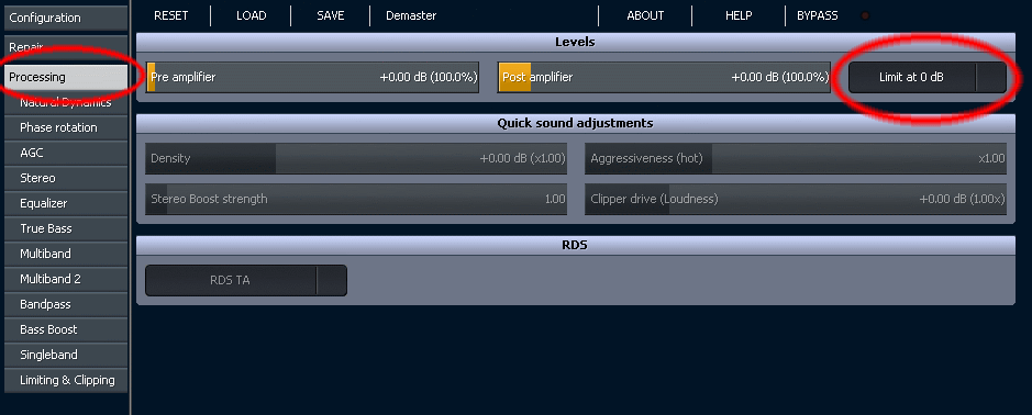

Looking through your tutorial made me wonder why attenuate the waveform while working in 32-bit floating point "environment", as Audacity does by default...
After fiddling with Stereo Tool for a while I found the "switch" for limiting the resultant waveform to 0dB, [Processing] -> [Limit at 0dB], which is "ON" by default. By switching it "OFF", you get above 0dB which you can normalize to 0dB or save 32-bit float for further processing etc..
Now I've got a lot of testing and learning to do with this piece of software, as many of the new HD download "remasters" have awful amounts of clipping (like Clapton releases in 24/192kHz), which is real pita to declip manually using "repair" in Audacity, which I've found quite good in that job, but as I said it is painstaking...
-a.kiuas
You're right I've 'discovered' it after the last post, when using Audacity there's no need to reduce waveform amplitude before declipping, it can be done after using limiting.
Nevertheless tutorial's goal was to illustrate a process that could be used also with other tools, for instance when using Foobar 'Convert' function waveform must be reduced before declipping.

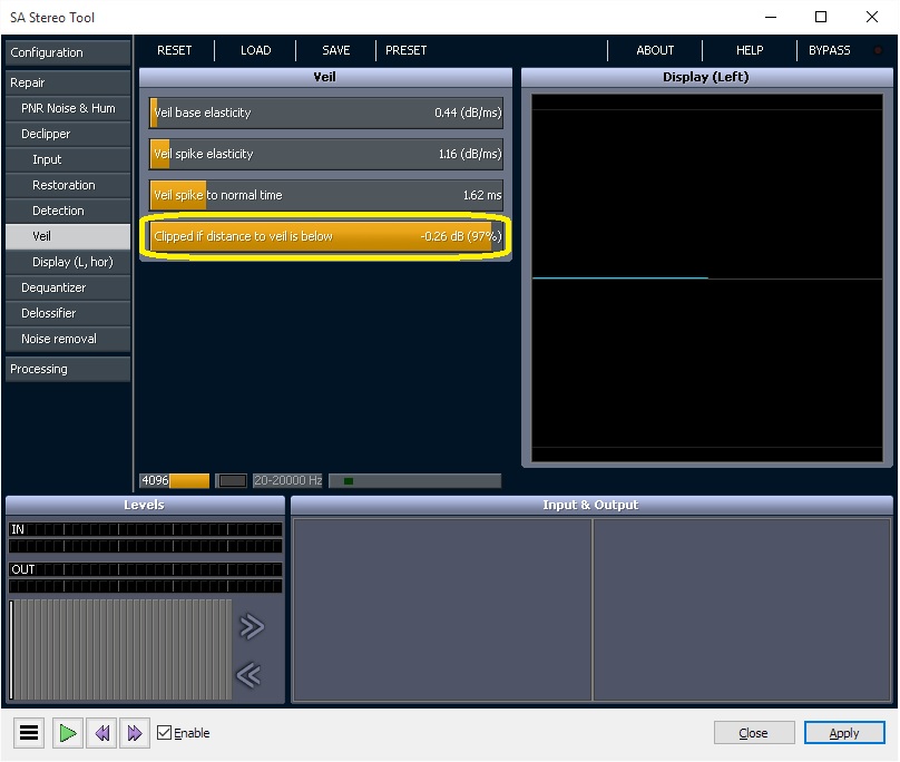

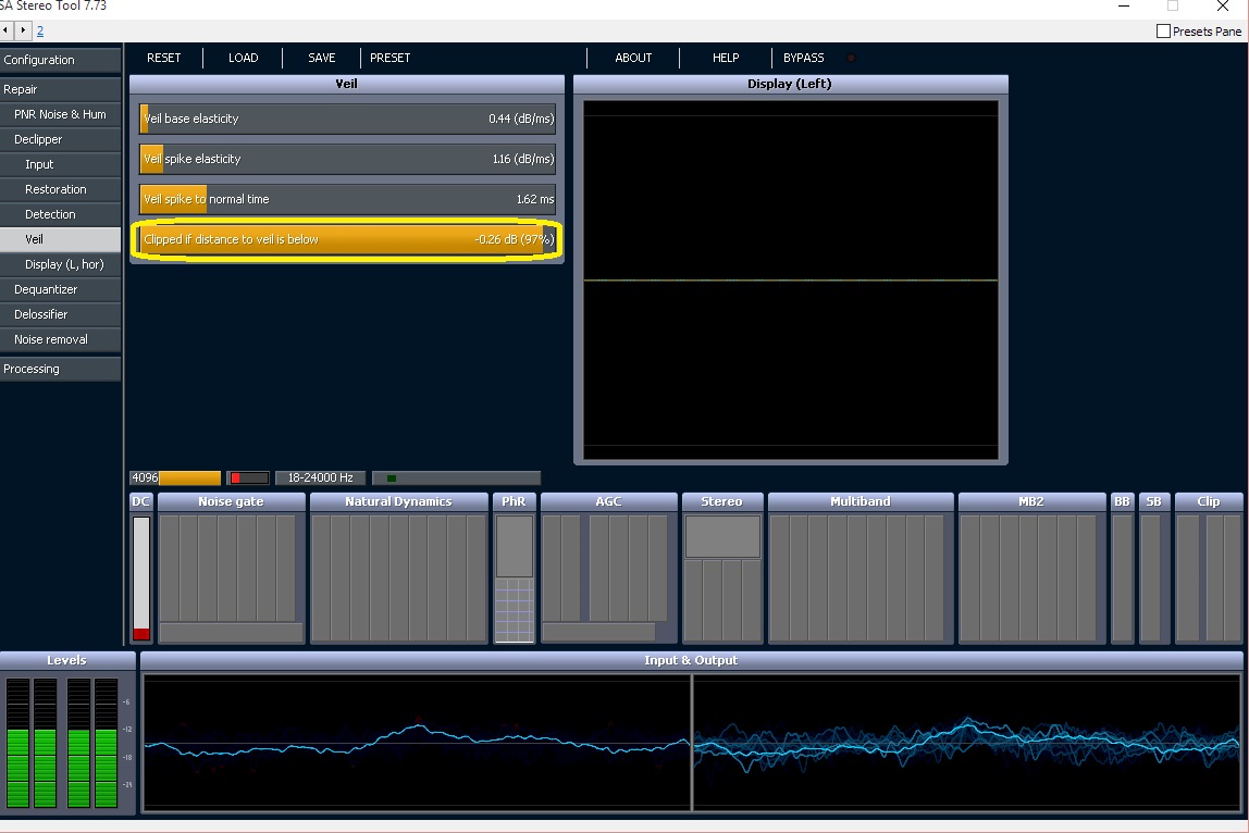

Just one thing... in post #17 I've recommended a tuning of one parameter:
499400d1440004158-de-mastering-smashed-recordings-stereotool-loudness-war-immagine2.jpg
That recommendation is wrong, keep the default value.
