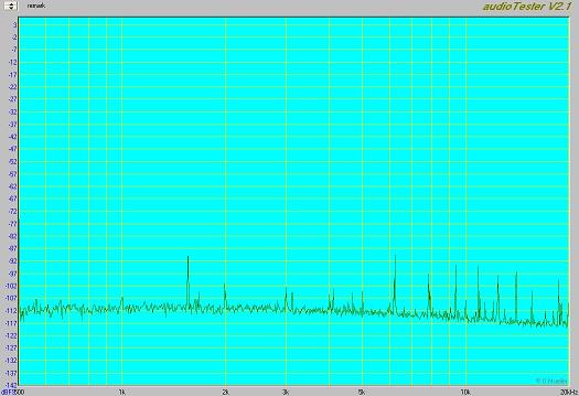

I got one of tents PLL:s aswell...
Here is a measurement taken of the errorsignal from said PLL when driven by a PCM2902 playing regular music trough a spdif interface you would probably recognice....
I can hear no readily recognisable signal modulation of the errorsignal when i listen to it with a battery powered headphoneamp.
The measurement is taken with a regular soundcard (averaged 10 times).... But compared to the spectra of my Cdplayer I dare attribute most of the spikes to the pcm.
ofcourse a comparision to the clock comming directly out of a pcm27xx would be better...but in the meantime..
