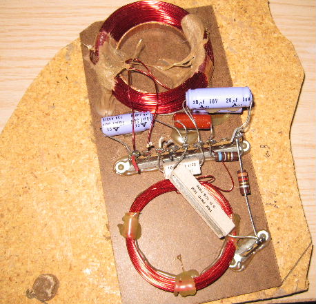

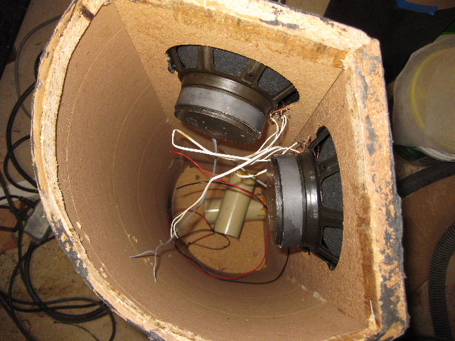

I just bought my first pair of TWs, and was thinking about recapping. I found the photos and schematic for the TW 1A speakers online , and they are indeed a step up from this original design. Cleaner plus more sophisticated. If anyone can tell me what is up with the square chunk of aluminum tubing inside one of the TW1A coils, I would appreciate it. Im guessing it increases the inductance and saves wire, but being non ferrous, has zero hysteresis like Fe would have ? Close ?Never seen that trick. So, do the 1As sound any better than the 1s ? Opinion anyone ? In the originals....Large air coils are good, like Polks...but several very old electrolytics. Upgrade ? Seems logical .
I do that for all my acquisitions. Buttt..... Im wondering if I really want to destroy these beasts in order to open them. Saber saw looks like the only way in. Also, does anyone have a schematic for this original crossover ? Thanks in advance.
dear AMT...thanks for the schematic.
I have been looking high and low for one. The TW 1 and 1A have the same cabinets,different drivers, and very, VERY different crossovers.I have seen photos of each. In the TW1, the coils are huge diameter (6 inch ) air core, no plastic formers used. Homemade with a piece of drain pipe, then slipped off, hot glued down....looks like. Polk uses the same concept on their M 10s, so all good. I do not pretend to understand the tweeter time delay, but wiring them out of phase with the woof gives a 180 delay, so I'm a'guessin the cap, coil, resistors give it yet another 180 to bring it right back in sync. The woofer has a 6db roll off, and the tweet has a fancy 12db/oct...via what I call C2. I call the woof coil C1. ( A guess...maybe 18 or 24...what does that 53 cap do ? ) to protect the tweeters. The 10uf cap is a HUGE value for a tweet, to get it to cross over down at 2,000Hz. If it is electrolytic, and in the signal path ( yes and yes), it has to go.Parts Express brand PPE filmcaps are superb. As for the 53 uf electro, which is a tweeter shunt, I would replace it with a new electrolytic. (But Hells Bells...the Labor to get into this damn thing...spend the $20 and get a PPE cap. Why not. ) If it dries out and becomes non conductive, more low freqs will go to the tweeters... two Phillips AD01624 T8, in parallel, thus 4 ohms. Poof. Might as well put a new PE 3uf PPE in there, I have read they "are better " than Mylar. These tweets are really padded down...looks like about 3 ohms in series with the tweets...no wonder they "roll off the high highs". Someone suggested unpadding the tweets by 1 ohm. Well, more current...just sayin. Hope this helps, 3 years late. I just got a pair, and I am learning the Mysteries of the Deep. Seems to me the only way into these babies..... is a full circumscision with a saber saw 1/2 way around the backside tube base, maybe 4 inches up, taking out a curved piece of cardboard maybe 6 inches high and maybe 12-14 inches on an arc...and hoping to miss any wires or crossover items... prying the crossover board up and out...or reaching in to solder new caps...then building a lip inside .. using thin 1x 1 pieces of wood paneling glued and clamped in place..... then replacing the tube cut out.... Has ANYONE EVER opened up and then recapped an original TW 1 ?
The easiest way to remove the top cap, without destroying the XO or damaging the cardboard is to use a Fein Multitool or similar. You will need several blades since you will be slicing though nail, particle board and adhesive. Carefully go around the perimeter between the cap and tube. Its slow but will allow the cardboard edges to remain smooth and intact. I replaced my caps with Oak ply with Oak edging and used a threaded rod, like the 1A to hold the cap down from the bottom cap. I used another piece of 1/2 ply, cut to fit the inside of the tube to keep the cap in place and sandwiched a tee nut in between for the rod attachment. BTW, I mounted my XO on the back so as to avoid conflict with the rod. The biggest PITA was removing the chipboard XO from the cap. They didnt spare the Liquid Nails on that attachment.

Time Windows (original model, not 1A).mod
Wow...that is a lot of work.Just curious........ what ya did to the crossover once you got access? I assume you have a schematic handy. My plan is to replace the 10 uf and 3 uf tweeter caps with PPE caps, and to bypass the 3 uf cap with a 0.1 uf cap. Gonna use a 3.3uf to get a wee bit more HFcurrent. I will then put in two 6.0 ohm Mills 12 W resistors to replace the 5,1.2, and 6.8 ohm resistors in series with the tweeter. This will drop Rt from 3.3 to 3.0, again giving a bit more Bright to the sound....unpadding the tweet bascially.Not sure what to do with the 53 uf tweeter bypass cap...So I could cheap out and use an electro, or pay maybe 13$ for film. Ideas ? Thanks for the feedback.You and I must be the only 2 people on the Internet who have actually done this mod.😱
I simply replaced the caps, rewired and make new top and bottom caps and added cloth speaker grill material. As to the schematic, I drew one up using the physical layout and then derived the schematic from that. (post 61). This is less complex than the A1 that is shown on posts 45/53.
