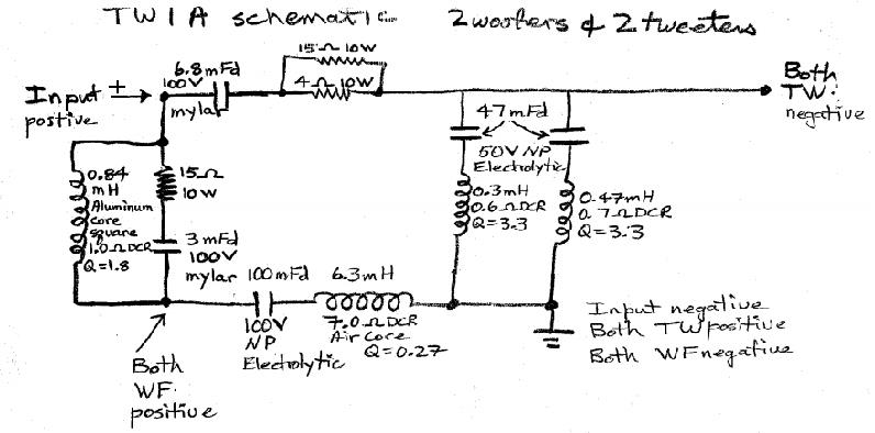

Well here is a schematic that was kindly emailed to be from the current DCM organization.
Im not sure what the various components do, but it is certainly engineered for the original drivers so I doubt general replacements will function as well.
My thoughts were to try using some single drivers to see if the basic sound can be replicated.
amt

Thank you very much! From what I've read around the net, the Philips drivers used in the TW1As were not all that spectacular, even for their time. Since I don't know squat about how one determines which drivers to use for a given enclosure type, configuration, and size, I'm not yet able to make any intelligent choices; more than that, the Time Window 1s and 1As were obviously ported differently and there's no way I can tell what the internal baffling in the SonoTube or the configuration of the port or ports, round or square might have been.

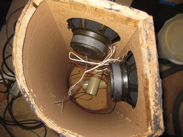

Having taken them apart, can you tell me what's inside the SonoTube and MDF enclosure, other than the XO on the bottom plate?
El Roi -- I hope you don't mind me using your photos for illustrative purposes (let me know if you do, and I'll take them down). What I'm trying to determine (among a LOT of other things) is what the internal configuration of this port was:
(I believe these are 1a's -- correct me if I'm wrong, but my original "1s," with the plastic "sock-holder" strip down the middle of the back, didn't have this port, it had the plastic port horns, as shown below. My 1s also didn't have the felt "eyelids over the woofers, or the mesh and damping foam over the tweeters, they looked exactly like the next image)
Or how far the throats of the port horns on (what I believe are) the "1s" below intruded into the interior volume of the enclosure:
or if there was any other baffling inside the enclosure (in this image, looking UP from the bottom baseplate to which the XO was affixed, all I can see is some batting):
If anyone has ANY more info on what was actually inside the SonoTube and MDF "arc-cylinder" enclosure of the Time Window 1s, or any other hot tips on its design, or why I have rocks in my head to think I could even come close to replicating the Eberbacher design, I'd be most appreciative to hear from you. Meanwhile, I'm still looking for a used pair, in pretty much any restorable condition (which precludes having been in a flood, as neither the SonoTube nor MDF take kindly to water).

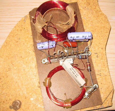

Dismantled...
Well I finally started to redo my TWs. I removed the top and bottom caps and cut the top of the speaker open with a sabre saw. If I didnt know the speakers were a commercial product, Id say they were fabricated in someones garage. Standard PVC, sonotube, Liquid Nails (lots of that) and a pretty ugly XO.
The pictures Ive seen of the TW1a and TW3 represent a big improvement in build and execution.
The crossover in particular is of interest since it appears nothing like the TW1a design. I will post it once I figure it out and draw it up.
amt
