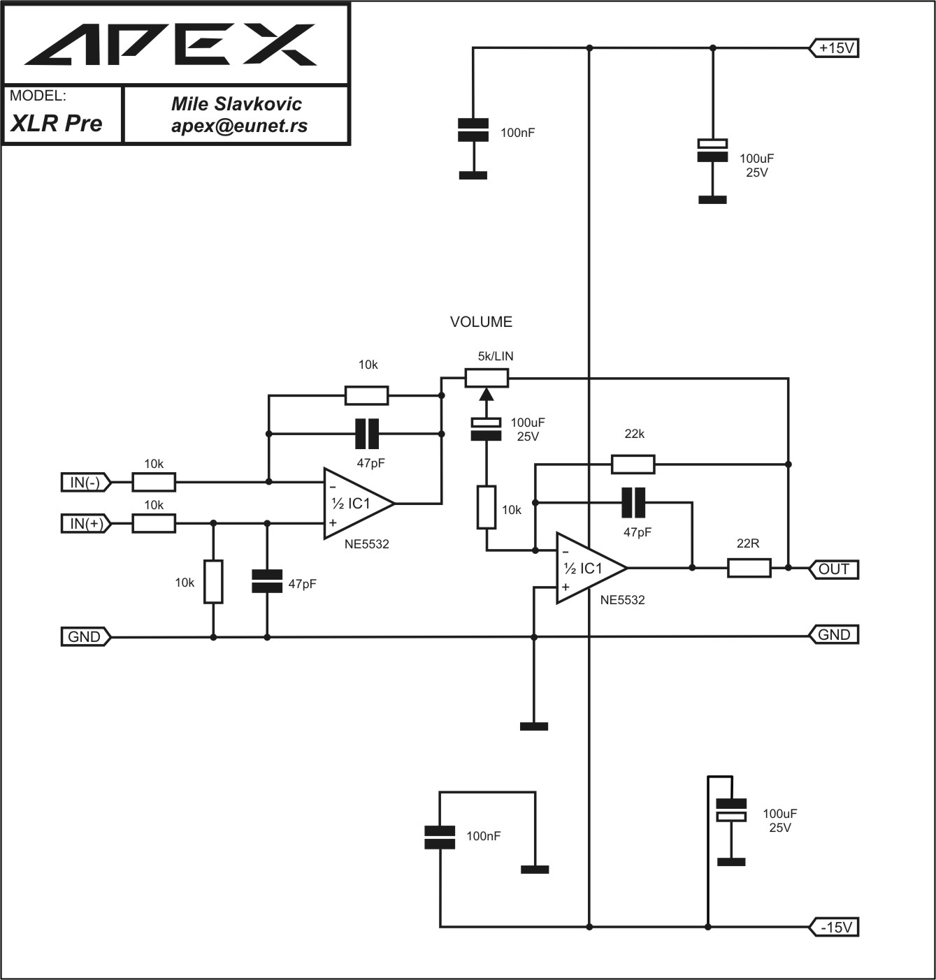

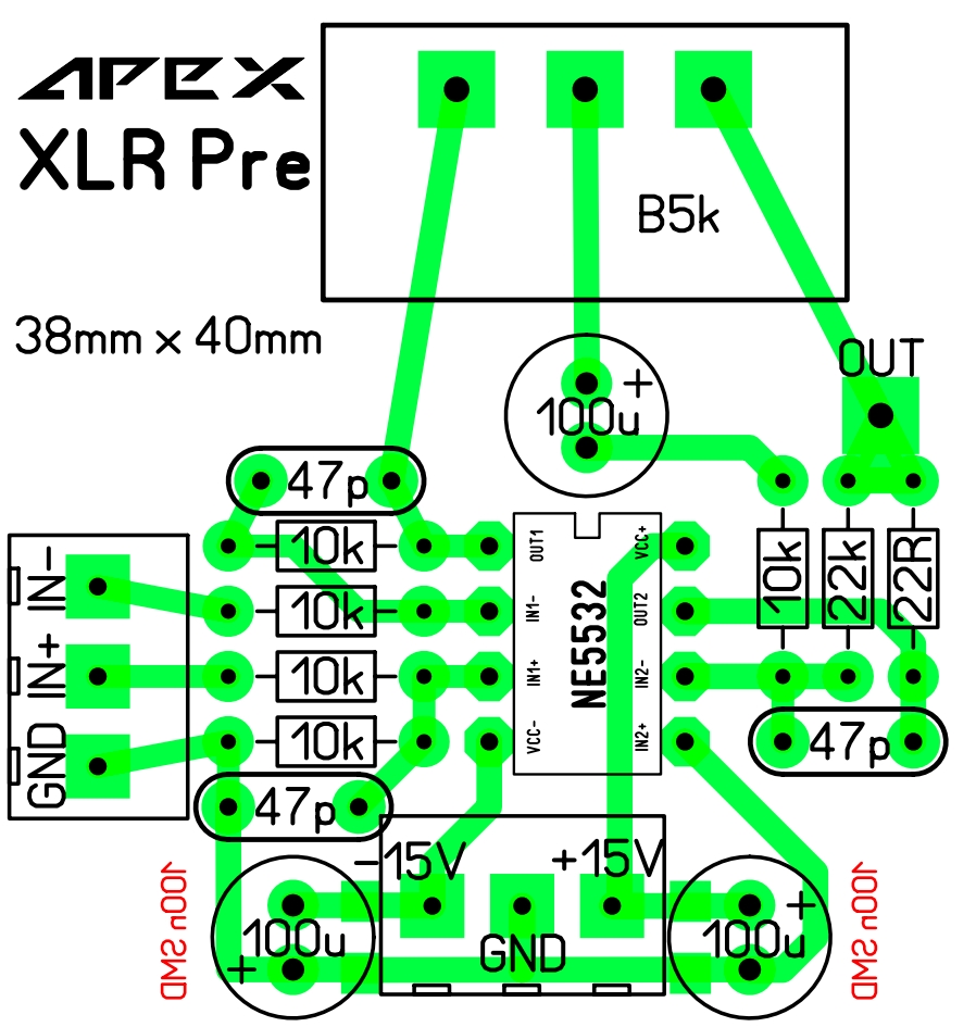

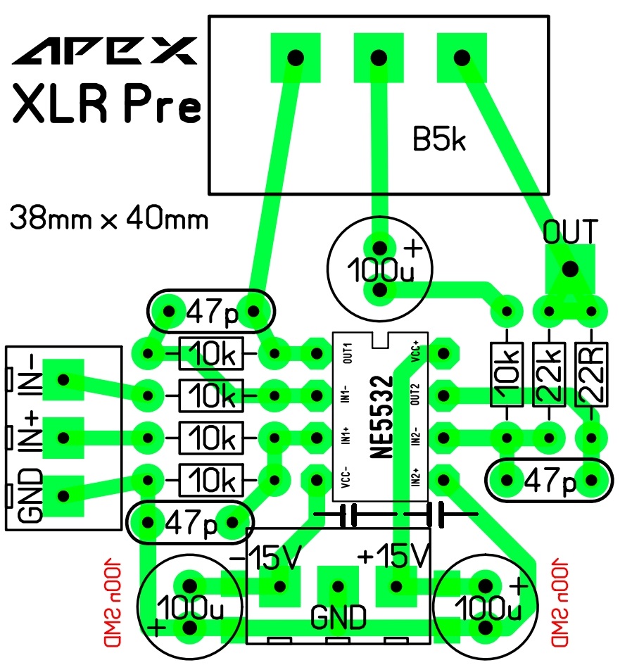

looks good.. 100N filter missing 😉
The 100n caps are SMD. Notation is in red and reversed because it is on the bottom. I guess I could move things over so I can add through hole parts too.

I took a stab at a layout for the balanced input. Please check it for accuracy.
Thanks, Terry
DO NOT!!! ne5532!!! BETTER ad843-5+ad817-811!!
Are you saying Mile's design is not good? Better to argue that in the other thread.

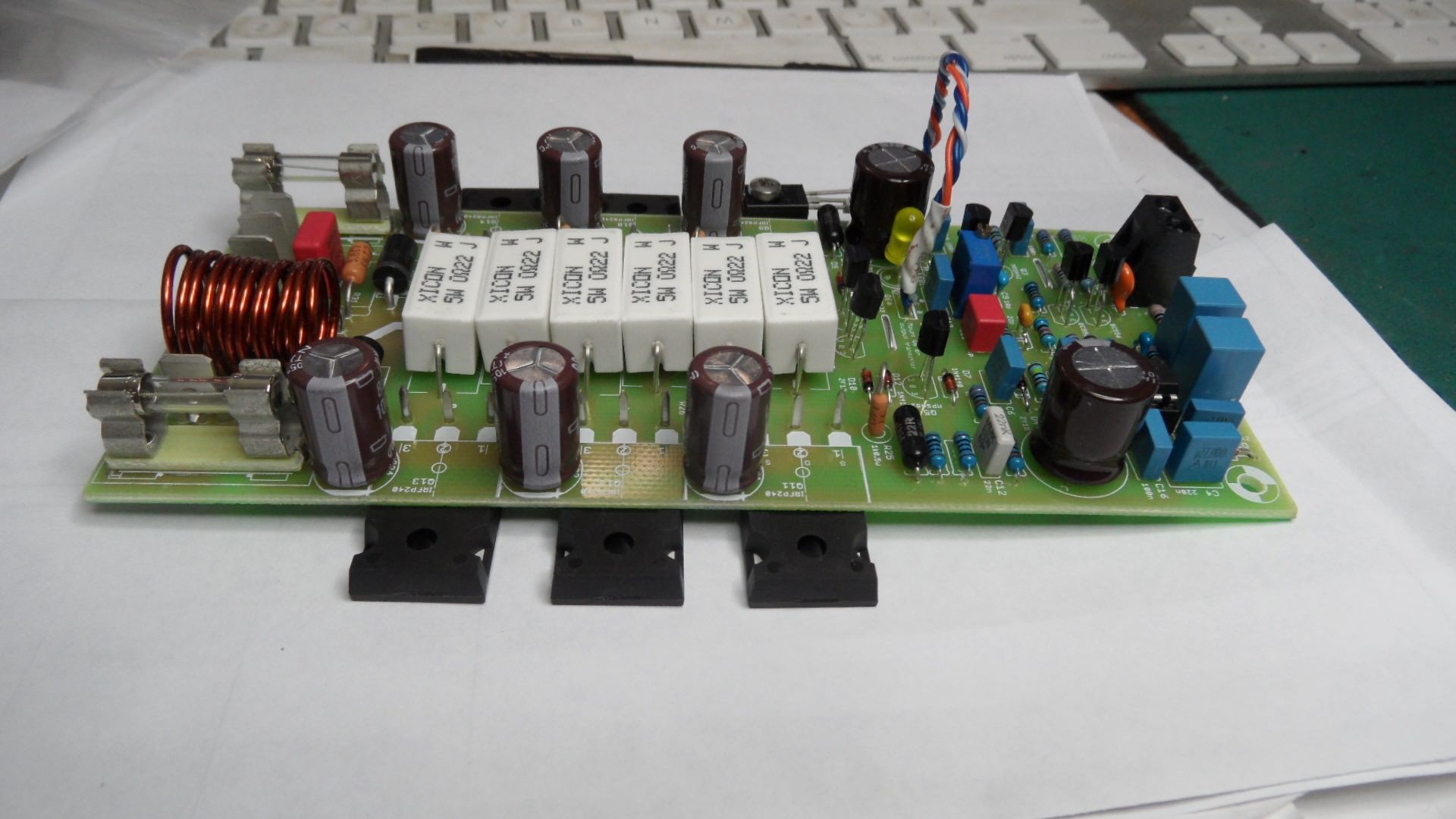

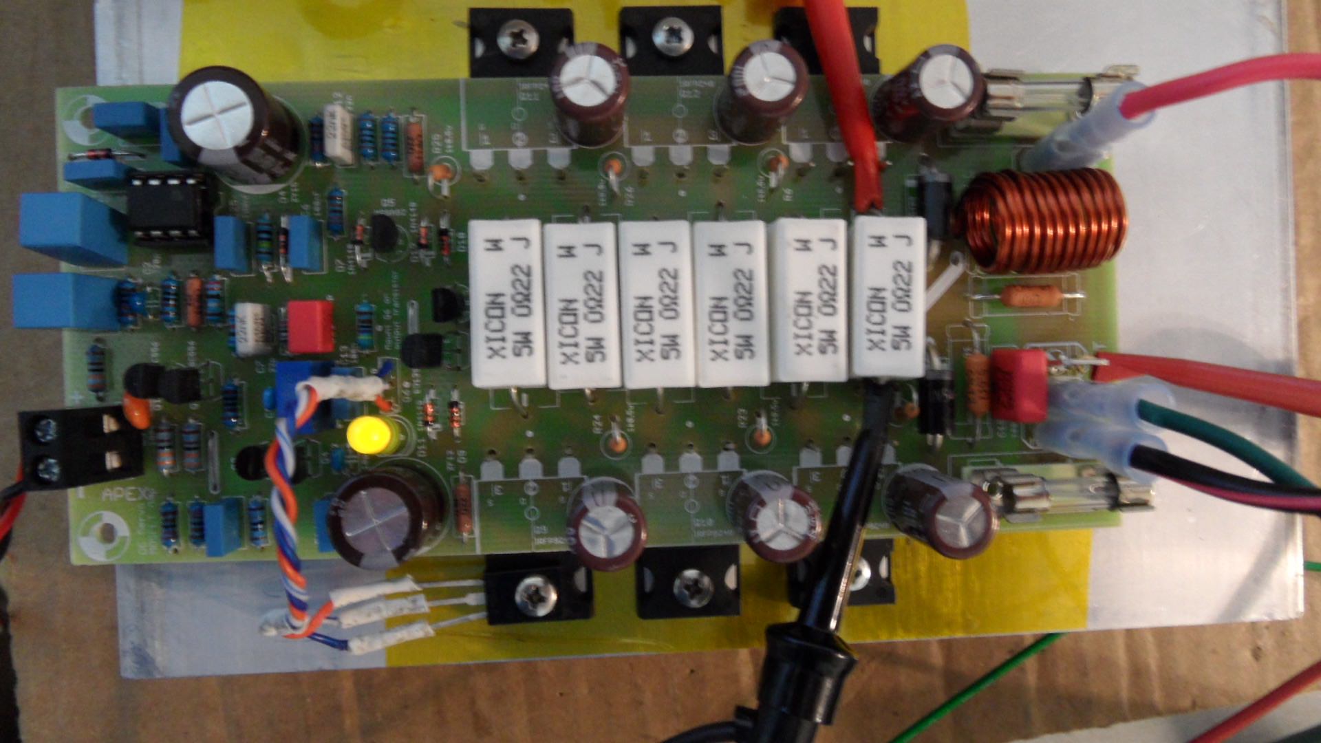

Prasi,
Got both of the boards up and running,+-55V. Still have to get proper heatsinks for them before i can give a proper listen to them. Thank you for the boards.
Rick
