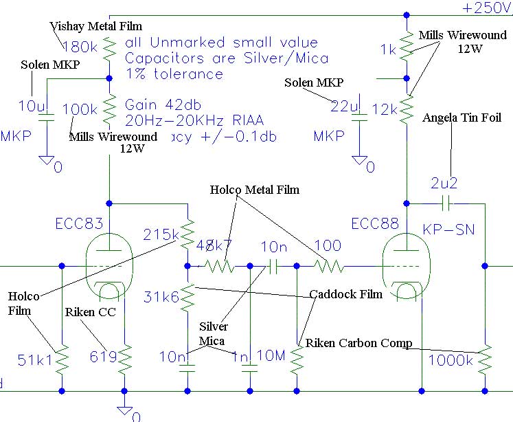

I broke down and decided to go wth the silver mica. Also went with the 1.5uF Angela tin foil. Hopefully that will do.
At the risk of exposing myself to be the schmuck that I am, I have attached the RIAA circuit in question and listed the parts I intend to use.
As this is a learning experience for me, I'd like to get some feedback on whether these selections will work together or if they will make me wretch uncontrollably for months. If the case is the latter, please recommend some replacements and ridicule me accordingly.

Koffi,
May I ask whether you plan on using this phonostage as a standalone unit to drive an amplifier directly?
If so, you may want to add a cathode follower to the output or use a different topology for the second stage in order to reduce the output impedance. It is a tad on the high side....
As for the components you chose, nothing wrong with it per se although I'm no fan of Solen polyprops at all, would it not be wiser to use ordinary components for the first built?
You may. The next stage will be a line amplifier, then 2A3 SET monoblocks.
Yes it would, only I'm not smart enough to separate the merely ordinary parts from the total doody. If there are some less expensive components you'd recommend that don't outright stink, I'd love to hear it. I'm only going with the parts that I saw recommended in this long, long post.
Long.
This has already been a learning experience and I certainly don't want to get ahead of myself by getting in over my head with components I don't need. Its hard for a newbie like me to determine which parts are worth going medium / high quality on and which can be upgraded later.
Please let me know your (collective) thoughts on this and thanks very much for responding!

Konnichiwa,
It will.
I don't see anything that is prejudicial to performance. But one or two notes.
Modern Holco's have no longer got any advantages over other RC55 standard resistors, sonically but are still sold at a premium.
The gridleak resistor and output resistor (10M & 1M respectively) do not require particulary high quality resistors.
Critical for sound are the RIAA Resistors, the cartridge load, the first stage cathode resistor and the Anode loads, in that sequence of impact.
Try making the gridstopper carbon composition, that is more important than the value.
The +B Dropper resistors are relatively uncritical.
I would recommend for all uncritical positions generic metal films of sufficient power rating from Mouser.
Mills on the Anode load of the 2nd stage is fine. For the first stage I think a premium grade low noise (Vishay? Caddock?) Resistor is indicated, the same might also be a good choice for the EQ.
Well, the output impedance is around 3K, not exactly low, but with 1nF cable capacitance (which is well past what I'd recommend - stick to low capacitance cables) the -3db point is still 50KHz.
I'd leave the cathode follower off if good sound is desired.

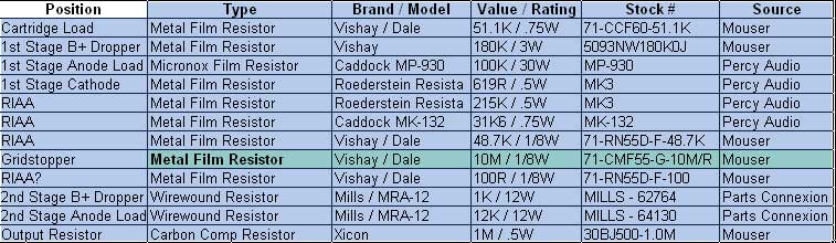

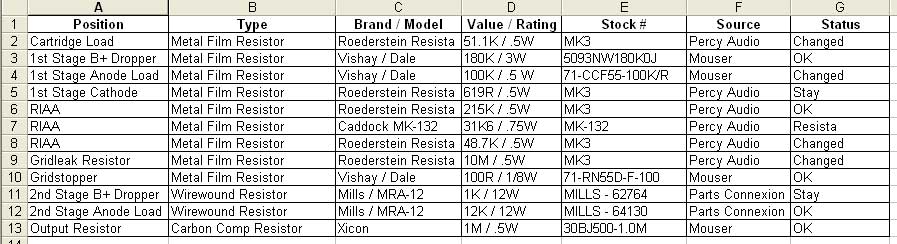

Thanks again for the advice!
Being eager to concoct an appropriate parts list, I have again modified my list of parts for the project. Being new, I probably blew it.
I swapped the Holcos for Vishay / Dales, but I don't really know if I'm any better off. I added a Caddock power resistor for the 1st stange anode load and I'm trying Roederstein Resista resistors for the cathode and an RIAA resistor position.
I had to try different makes since there are certain values of resistance by manufacturer that are either not carried or not available.
Anyway, if you would, please take a look at the attached .jpg of my current working parts list. I simply cannot find a 10M carbon comp resistor from my regular sources, so I went with metal film. If this will cause the UN building to explode when I turn it on, please let me know.
Also, are the Watt ratings OK for these?
Then after this, can you take a look at the rash on my leg?
OK, skip that. Just the parts list will do nicely.
Thanks so much for putting up with this. As a thank you, I have a few leftover "oil for food" dollars I can funnel your way, if you get my drift.
Kofi

I see some 12W, even 30W resistor on your list.....
I pinched myself in the arm but no, I am not dreaming.
Surely that must be a mistake? I can't see any reason to pick such high wattage resistors for anode loads in a simple phono pre where there's just a couple of miliamps flowing??
I noticed you have some Roederstein Resistas on your list.
These are great resistors, I love them, but I would not use them as cathode/anode resistors even though they'd probably work just fine.
Instead, if you want to keep your budget tight, I'd recommend as gridleak and for the RIAA correction.
For the anode/cathode resistor Dale (1W) RCN55 and similar should be O.K.
The gridstopper on the ECC88 is probably not even needed as it has the entire RIAA correction on it's grid already but it won't hurt either.
If you want a "no holds barred" version then I'd recommend the nude Vishay bulkfoils (if you can find them) for the RIAA section and cartridge loading and anything else directly in the signal path.
Keep in mind that some (actually most) MM cartridges require some capacitive loading on top of the one provided by the cable capacitance of the phono leads. If so, then that cap (50 to 150pF) is best put across the cartridge load resistor (51K?) and of the best quality you can find, silvered mica, polystyrene or polypropylene would be good.
For the 10M gridleak bias resistor I'd opt for a metalfilm type. I'm not sure how noisy or not these carbon comp resistors are but I've used Resistas in that position with good results in the past, so...
Anyway, I'll leave TL to fill in the blanks as he should be the more familiar with the circuit....
Cheers, 😉
P.S. Should you have a calibrated capacitance meter then you can put it to good use to hand select the RIAA caps so you can match values for both channels.

Konnichiwa,
The 12W are okay and actually suggested for the 12K. The second stage is run "low & hot" to minimise anode impedance.
Not really. The second stage anode resistor dissipates around 3 Watt.
Experience shows that the ECC88 likes to oscillate. Depending how tight the circuit is wired it will do that within this circuit.
Me too.

Konnichiwa,
A few notes. The Gridstopper is the 100R, NOT the 10M. The 10M is the gridleak resistor and the circuit is gridleak biased.
Power rating, all resistors are fine as 0.5W excepting the Anode Load and +B dropper resistor for the Output Stage. They needs to be 3W & 9W minimum, the Mills is probably overkill for +B Dropper and you could try one of the various TO-220 cased power film resistors (Caddock, Meggit, Vishay come to mind).
Sayonara

I currently have 6W for the 12K output stage anode load and 2W for the 1K B+ dropper, I'd better get a big 1K!

I changed the parts list to remove some of the ridiculous values (see attached), and I think I'll probably start with these and make changes as time goes on.
This is going to be a real learning experience for me, so I'll likely have more questions as parts arrive and I begin to think about the layout.
Take a look at my final parts list and let me know if I will be committing audio atrocities. Note that I could not find certain values in the recommended resistors, so I did the best I could.
Also, I can't thank you (collectively)** enough. I know you are stooping pretty low to help a nimrod like me and I really appreciate it.
Kofi
**[You know, I really wish we had a collective "you" in English as many other languages have. We have "youze" (Brooklyn), "youze guys" (Northern Brooklyn) and "y'all" (Alabama), but no grammatically accepted version.]
Looks O.K. except for the anode load resistor of the ECC83, the 100K should be 3W. (Check with Mouser, they should carry it)

Looks good, except there is absolututely no need for the 3W/180K, it can be 1/2". The ECC83 runs at 0.6mA. The 100K Resistor dissipates 0.036W and the 180K 0.065W.
I'd probably use standard (Mouser CCF55 Range) metal Films for all but ECC83 cathode, cartridge load, gridstopper & RIAA and of course the big resistors for the output stage. Mrs Annan should like the change in cost.
Sayonara
Kofi Annan said:I changed the parts list to remove some of the ridiculous values (see attached), and I think I'll probably start with these and make changes as time goes on.

Thanks again for all the great advice!
I've opted for Resistas (did Snoop Dogg name these?) for the RIAA, even though I'll have to add a 30K1 and a 1K5 to get the 31K6 value.
