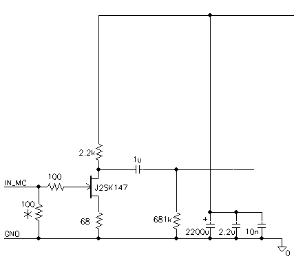

l'Audiophile MC Pre-Pre
<pre>
24 Volts regulated or battery buffered supply
4k7
|---------0.47uF-----out------------>
(drain) |
---in---------(gate)JFET 100k
| (source) |
100R | |
| 47R |
-ground--------------------------------------------------
</pre>
The basic topology is that of the second step-up amplifier by "Maison de L'Audiophile" of Paris/France.
The first 100R is the cartridge load, which must be adapted for the cartridge you use. Using a paralleled 1nF cap also makes the circuit immune against RF noise. The 47R resistor in the source is not necessary, if the JFET has an IDSS(on) of 2mAmps or less.

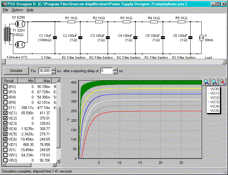

As the signals are very sensitive, the voltage must be very clean, a 100,000 uF electrolytic cap for blocking power supply noise, computer grade favourably, is advisable. (note - we used 2 X 2,200uF Elna Starget and a 1k Decoupling resistor.)
Suitable JFETS are 2SK170, 2SK240 (double JFET), 2SK97 (double JFET), sorry only these japanese types are suitable, the European BC264 and BF254 and so on do not work here (I tried !). All resistors must be big metall resistors, e.g. Beyschlag 1Watt, or tantalum resistors. No carbon resistors allowed here, tubes addicts.
The output cap is preferably polystyrene or polypropylene or paper-in-oil, as you like it, as they are different in sonic balance. If the load is lower than 100K you need to increase the capacitor proportionatly.
If you use a passive RCRCRCRCRC filter chain with 1k/100uF cells you will have 30mA X 5k voltage drop in the RC filter chain, namely 150V. Add to this the 250V +B and you need 400V. If you use a 6X4 or EZ80 rectifier valve and a 10uF reservoir capacitor you will be needing a 320V-0-320V Transformer with a DC rating > 30mA or an AC rating of at least 50mA or thereabouts.
I have attached the suggested PSU schematic for a simple and cheap PSU that is dead quiet, uses a valve rectifier and is entierly passive and hence should be pretty safe and reliable to assemble. The Electrolytic Capacitors can be quite inexpensive types but should be bypassed, the 10uF reservoir capacitor however should be a decent MKP type, to shortcircuit as much HF noise as possible.

GAK said:Can you exlain me why the raw DC after rectification and cap must be around 400V?Isn't it too much?
Thanks for the detailed explanation.I didn't expect total current of 30mA.
Can you tell me how much current needs each tube?

[Konnichiwa,
The ECC83 will draw around 1mA, the ECC88 will be (depending upon the specific valve used) around 14mA. With a "bogey" ECC88 & ECC83 each channel will draw around 15mA (=/-20%).
