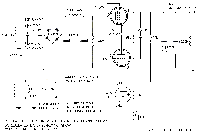

GAK said:Any comments-suggestions for the following PSU?
Looks on one hand a little overkill (a stereo chassis will draw around 30mA only) and at the same time not anywhere near quiet enough in terms of ripple rejection.

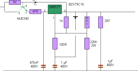

I would recommend a simple LM317 type adjustable regulator with a voltage limiting series transistor. This tends to work well enough, the original design was aimed to be used with that. Use a snubbered (Buddah style) solid state bridge made from soft switching diodes with 240V secondary.
The original idea was to use a pair 115V+115V : 9V+9V Transformers back to back, use the 9V+9V with a dual schottky diode for the heater supply and use the second transformers nominal primary as the HT source. Added RC or LC filtering for the raw voltage feeding the HT Stepup transformer is easily implemented.
A simple RCRC Filter after the bridge and an LM317 plus voltage boost transistor give a quiet supply. The RC decoupling per stage makes sure that the Signal current AC loops are closed through the local film capacitors and not the regulator.
I hope this helps to understand what was originally intended.

With the original circuit, the LM317 regulator output (AC - be it noise or reaction to the AC current demand of the output stage) is suppressed by around 23db @ 100Hz and 40db @ 1KHz. Doubling the RC circuits doubles that attenuation.
Also note that the RC circuit drastically reduces the current modulation on the LM317 in the first place. At 20Hz only 1/4 of the current flowing in the output stage feeds back as modulation of the LM317 output, at 100Hz it is only 0.072 times the current in the output stage.
Thus the single RC circuit after the regulator insulates the Signal circuit from any signal interactions with the regulator by around 45db @ 100Hz and much more than that above 100Hz, compared to feeding the circuit DIRECTLY from the regulator. So the solid state regulator only becomes audible at very low frequencies.
If you feel 45db down @ 100Hz is not enough, doubling the RC circuits up gets you > 90db reduction of signal related "nasties" from the "bad & evil" solid state regulator at 100Hz.... As always, it is less what you but how....

Constant voltage is not really an issue. I prefer a good quality cap to a gas regulator (tried). Please note that the LM317 is PRE-Regulator followed by an RC filter. For those paranoid enough - you can add another 1k/22uF section to the output stage and split the input stages 180k Resistor into 2pcs of 91k and use a pair of 10uF Cap's.

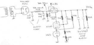

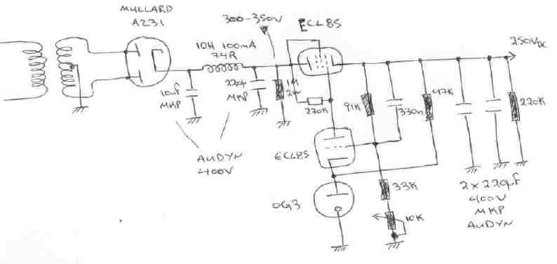

- With extended low end (soft suspension driver) speakers it is impossible for me to fight low frequency oscilations with all passive PSU.
I can't for the life of me see what the soft suspension has to do with anything. You may be experiencing a complex phenomena where ground loops interact with the PS over several stages to produce oscillations. The fact that a low impedance regulator stops the oscillations seems to indicate poor grounding. Of course i may be wrong 🙂 I don't experience such issues as i firmly believe in star topologies in both the grounds and B+ loops and as good as possible separation between separate stages PSs. Of course the best solution for sonics is a completely separate PS for each stage anyway.
The only part that may require some amount of fine tuning is the relation between the filtercaps and the choke(s) in an LC filter.
You'd be surprised how often I see resonance tanks passed on as power supplies....
You can get a pretty accurate idea by using a free proggie like PSUD II.
Of course no amount of sw simulation is going to tell you where the ground loop is...
With all the LF junk passing through I'm surprised the woofers have survived this kind of torture test...
No evidence of the problem with PSUD II.
A repeatable wrong practice in grounding ? most possible ...
This is where the "soft suspension" comes in.... I'm kidding.
I have no other way but "seeing" the oscilation.. Of course I power down immediately.

This is the schematic
The conclusion is to use four separate PSUs?One for each stage??
Too extreme for now.Let's make it simpler and if it's everything ok I'll try it in the future.
Why not to use one power xformer,rectification,p-filter and then split in two separate regulated supplies (tube or SS).One for each channel with an RC filter after each section.This for the PSU chassis.
For the circuit chassis ,an other RC filter for each channel and then Kuei's circuit as is in the schem.

The regulator as presented here serves a dual purpose ; it isolate the circuit from the mains to a great extend and it serves as a trickle charger for the reservoir caps behind it.
It has very low ripple and only regulates in the sense that the output voltage is kept constant which in this application is a breeze from the regulators' POV as current draw is constant most of the time: class A remember?
You can replace the Black Gate caps with cheaper caps, untill the budget allows for an upgrade, to either BG or good filmcaps, PIO or the ASC variant.
In order for the regulator to work properly you need to make sure that you have at least 50V more at the input compare to your target voltage. So if you want to have a well regulated 250VDC supply, you'll need at least 300VDC at the input.
More won't hurt but keep an eye on the heater to cathode insulation voltages of the pass device(s).
Cheers,😉
P.S. The regs using the ECL82 are still on the drawing board.
P.P.S. Keep in mind that you can't draw more current from the reg than the pass device can deliver.
EDIT: I just spotted the 30H 40mA choke in the PS. You can safely lower the Henry value and up the current spec if you need more current from the reg.
It was originally designed to supply a single stage, single channel.
Cheers,😉
Frank
Thanks for the schem.
I'm planning to use tube rectifier.I have done some changes to the schem.Any comments?
Some more questions
- The reservoir caps after the regulator is better to put them at the PSU chassis or at the circuit chassis?Or to leave them at the PSU chassis and put some other at the circuit chassis?
- I have some PCL86.I can't use them at the place of ECL85 ,right?
- what kind of cap to use at the place of 330n//91K?
- Vkf of ECL85 = 200V.I think I'll have a problem with 250V at the cathode of pentode.
Kuei
I won't do any changes at your schem.I'll leave it as it is.If you retain the RC decoupling as drawn in my schematic one regulator for both channels suffices. Do not delete these RC circuits unless you are very experienced in wringing good sound from circuits with loads of loop feedback and invariably poor transient response (regulator).
- I can't find silver mica bigger than 100V.Any source in EU?
- 2u2:Audyn KP-SN or MKP Hovland?Or sth else?
Konnichiwa,
I'm not frank, BUT, your input LC filter has very low levels of capacitance and inductance, meaning comparably little filtering.
Combine that with the regulator circuit shown (which fails in several areas to realise the maximally possible PSRR), which will have a lot worse ripple rejection than a LM317 you may very well find that the Circuit has too much noise.
To put this simple, the Output Stage of the circuit of my suggested Phonostage (which dominates the PSRR of the Circuit) is around is around 40db. If we assume a 2.5mV Phono cartridge and thus 250mV output from the Phonostage we would like a S/N ratio for the 100Hz PSU component AT LEAST 80db (1:10000) below this. In other words, the supply noise at 100Hz needs to be 40db below the expected signal level as the circuit with it's RC filter already rejects the PSU Noise by 40db.
In plain english, the noise applied to the Phonostage needs yto be 40db below 250mV or no more than 2.5mV. A typhical Valve based regulator does not display all that much 100Hz noise rejection, simply because it tends to have a rather low open loop gain.
The Series Pass Valve is a simple cathode follower. It's grid will receive an AC voltage that is a fraction of the noise on the valves anode (unless the gridvoltage is additionally filtered) determined by the value of the Anode resistor of the differential Amp valve and it's anode resistance. The cathode will attempt to follow this voltage but will experience additional pertubations due to the limited transconductance of the Valve. Combine that with a fairly high ripple pre-regulator the result may simply not be good enough.
I would move one of the 220uF cap's to the position after the choke (or both) and limit the capacitive load after the reggulator to what is needed for stability (usually 10 - 20uF).
You could even dump the Regulator and choke and use multiple RC circuits (Shindo Style), it sounds good and is very cost effective. Simply use a chain of 5 1k resistors and 5 100uF Electrolytic Cap's and make sure your raw DC after rectification and Reservoir Cap is around 400V. The 5 X 1k/100u Filter chain after a 10uF reservoir cap will produces a very low ripple DC (< 1uV 100Hz noise) quite cheaply and effectively.
If you retain the RC decoupling circuits shown in my schematic, you can all the stuff on the PSU chassis, also quality will be a lot less critical.
I buy 500V rated ACL made silver mica cap's from RS Copmonents UK (www.rswww.com).
My choice would Audyn/Mundorf/Angela KP-SN (they are all very similar). I'm not much of fan of the Hovelands or Jensen PIO'. You can always experiemnt later if you want a leaner, more clinical or warmer more cuddly sound.
Sayonara
GAK said:I'm planning to use tube rectifier.I have done some changes to the schem.Any comments?
GAK said:- The reservoir caps after the regulator is better to put them at the PSU chassis or at the circuit chassis?
GAK said:- I can't find silver mica bigger than 100V.Any source in EU?
GAK said:2u2:Audyn KP-SN or MKP Hovland?Or sth else?

GAK,
IMO the use of a tube rectifier is not going to bring any sonic or other benefit in this case.
You won't hear the difference, I tried this with this circuit several times and never heard anything in favour of the valve rectifier.
If you want to at all cost than so be it but as TL has pointed out you'll need some extra filtering as the rectifier is limited in the cap it can have straight in front of its output.
If it's the slowstart you're looking for, the regulator provides this plus it isolates the PS nicely from the mains, keeps B+ rocksteady and if you use one per stage IMD will be a thing of the past.
All in all extra expenses that can and are avoided by the BY133 Shottky rectifier bridge.
The regulator will reject alot of ripple but it is limited by its transconductance.
Regarding the 0.330µF cap, you can use an Audyn MKP here too, they're relatively cheap and sound fine.
The regulator as shown has served in a phono stage since 1985 and with a cascaded triode phonostage measured noise is -70dB for phono and -90 dB for line level.
Input sensitivity is 2.25mV into 51K (TL is not alone here) with 100pF in //.
You can put the caps behind the reg in the preamp chassis if you like but I'd add some more MKP caps locally close to the circuit proper.
No, not if you build it as drawn.
Re: PCL86, no, not without a complete redesign...Besides, you can make a nice little amp with those if you have a few of them.
If you need a more sophisticated regulator just let me know, it adds an extra tube and uses a cascode stage as an error amp.
A last remark, I doubt there's any benefit in using MKP caps in front of the reg so quite a few $$ can be saved there.

I think I'll build Kuei's circuit as it is and then I'll try different PSUs.
Then I'll have my own opinion.

If it's easy I'd like to see the more sophisticated regulator.

Can you exlain me why the raw DC after rectification and cap must be around 400V?Isn't it too much?You could even dump the Regulator and choke and use multiple RC circuits (Shindo Style), it sounds good and is very cost effective. Simply use a chain of 5 1k resistors and 5 100uF Electrolytic Cap's and make sure your raw DC after rectification and Reservoir Cap is around 400V. The 5 X 1k/100u Filter chain after a 10uF reservoir cap will produces a very low ripple DC (< 1uV 100Hz noise) quite cheaply and effectively.
