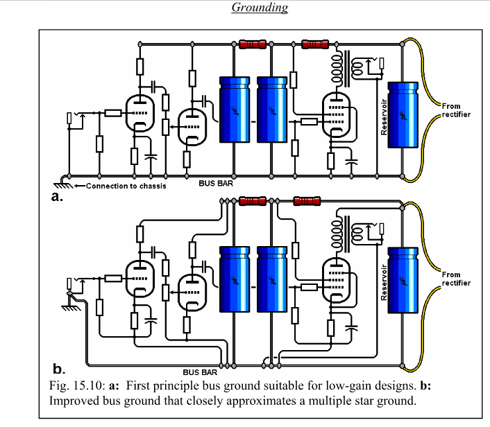

This is a bus ground, and I agree with cobretti that it can work just fine, particularly in a preamp, where all currents are small (just a few milliamperes.)...if all components are laid out and wired in straight line as seen on the picture I highlighted red, there shouldn't be a conflict with current flow.
Sometimes a few slight modifications to a bus ground - converting it more into a "star of stars" system - can help to lower hum, when higher current stages are included in the picture. (Bigger currents cause more noise voltage when flowing through ground wires.)
IMO, when it comes to grounding problems, the single worst offender in a valve guitar amp is the main power supply filter cap ground, and that one isn't shown in these partial schematics in this thread. (But Merlin Blencowe address it in his write-up that I linked earlier.)

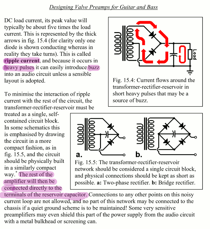

There are relatively big current spikes - up to hundreds of milliamps - flowing through that filter cap, and if it's grounded to the wrong point, that can inject considerable hum and buzz into the amplifier. (The situation is worse with solid-state amps, where filter cap ripple currents might be amperes rather than tenths of an ampere.)
That filter cap should ground directly to the main star point, and the preamp should arrive at that same star point separately, by its own wire. Never share a length of ground wire between the preamp, and the main power supply filter cap.

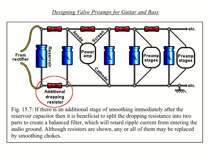

I'm attaching three snippets from Merlin Blencowe's chapter on grounding, in case they might help. The second idea - adding an additional resistor in the *ground* line between the main filter cap and the secondary filter cap - helped in one of my builds.
The third idea shows how the simple bus ground can be improved to the "star of stars", and also note where the one-and-only connection from amplifier circuitry to chassis ground is made: not at the power supply filter cap, but at the input jack! (This is in addition to the safety ground, which is made from the ground lug of the AC inlet socket directly to chassis metal nearby.)

I've seen other amps where the preamp heaters are DCed as you describe, but additional high-value eletros are placed from each side the "6Vdc" to ground, with polrities carefully oriented since that looks like +/-3V.

There's more than one way this could happen. A common cause is the spiky ripple current from the filter capacitor accidentally sharing a ground wire with the master volume. A less common one is AC current induced in the ground wire caused by the transformer magnetic field. It could even be a ground loop inside the amp that's picking up the magnetic field from your power transformer. But I think it is a ground layout or wiring problem.
