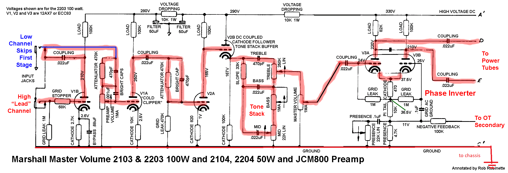

Ah. So you've taken an already high-gain design, and raised the gain quite a bit higher with your modifications. This will certainly make it more challenging to make the amplifier stable, and also to manage hiss and buzz.(Marshall 2203/2204 preamp) schematic...all attenuators are taken out, all gain stages have cathode bypass caps.
The question in my mind is whether your amplifier is actually unstable and oscillating continuously, or not. The radio reception problem suggests that it might be.
An oscilloscope would probably tell the tale immediately, if you have one. If not, if you have a radio try taking it near the amp, set it to MW, short-wave, and FM bands to see if you can pick up any squeals or weird noises from your guitar amp. Old-fashioned analogue TVs can be useful RF oscillator detectors too, though few of us have one around these days.
Typical input capacitance of a half-12AX7 gain stage is about 100 pF. A 34k resistor with that will only roll off treble above 50 kHz or so. So I think the grid-stoppers are blameless....grid stoppers...34k...took them out because they robbed highs...
However: feed the whole thing from a 1 meg volume pot (like your preamp volume pot), and that can really change things. The pot itself can have up to 250k source impedance, and combined with the 100 pF input capacitance, that can roll off frequencies above about 6 kHz. You can certainly hear that, even with a guitar speaker...though many guitarists are actually happy to have these harsh-sounding upper frequencies removed!
That treble loss is probably why Marshall put those "bright caps" in the circuit - the ones you removed when you discarded the attenuators. 🙂
I would suggest putting the grid stoppers back, to help with the stability problems, and maybe trying a lower-value preamp volume pot to solve the treble loss problem. Even a 500k pot (instead of 1 meg) should do the trick - now only frequencies above 12 kHz will be rolled off, and there is virtually nothing above 12 khz from a guitar speaker.
Nothing obvious leaps at me, other than the fact that you have a trunkload of gain in that amp, and the chosen construction method places dozens of components close and parallel to each other, and then dangles several inches of closely-spaced wires off the ends of many of them, all of which increases stray capacitance and stray coupling between components.

Oh, you certainly want the input jack and cathodes grounded to a good 0 V reference!It is so weird that the input jack and cathodes don't want to be grounded to a good 0v reference.
Factor #1: when you have multiple ground connections at different physical locations to the same chassis, small currents will flow through the chassis itself. Those currents flowing through the small resistance of the chassis metal will generate small voltage differences at all those points. So all points on the chassis are NOT good 0 V references now - instead, they have small noise and hum signals on them.
Factor #2: An amplifier can't tell the difference between an input signal at the input grid, and the same input signal at the input cathode - the triode amplifies whatever signal appears between its cathode and grid, and doesn't know which, if either, is zero volts.
Factor #3: You've built a high-gain amplifier that responds to very small voltages; low-gain vintage Fender amps were designed so 20 mV of input signal would drive the amplifier to full output power. Your amplifier will probably only need about one millivolt of input signal to produce (deafeningly loud) full output. Even as little as ten microvolts of noise would be only 40 dB lower than that - and 40 dB is a very poor signal to noise ratio.
Put those three factors together, and you see the problem. Poor grounding layout can easily cause a few microvolts of hum or buzz signal at some points in the chassis metal, and that's all it would take to cause your high-gain amp to hum and buzz.
Part of the cure is to make sure there is only one single point of your circuit that's connected to the metal chassis. This ensures that there are no noise currents flowing in the chassis.
Another part of the cure is grounding all the various parts of your amplifier together in such a way that the ground wires themselves don't cause the same problem that the chassis was causing - you don't want large noise currents flowing through any ground wires that connect to the sensitive input stages of the amp, generating noise voltages in the ground wiring itself.
That's the basic idea behind the star-ground: everything grounds at one point, so the ground wires from the input stages don't carry big noise currents; the big noise currents from the output stage do cause voltage drop, but only in the ground wires to the output stages, and the output stages by themselves have little voltage gain.
Star grounding sounds great in principle, but in practice, it's impractical except for very simple circuits. The circuit you built is not that simple - you must have at least a dozen different points in your circuit that all need to connect to ground in your amp. It's not practical to cluster twelve or fifteen ground wires all together at one point, so true star grounding is probably not going to be an option.
Instead, for a more complicated circuit like the one you built, you need a different solution. One that works well is a "star of stars", where, for example, you have a local star ground that connects the input jack ground, the input triode's cathode resistor, the input triodes cathode bypass cap, and the input triode's power supply filter cap, if any. Now you run a single wire from that small local star to the main star ground.
