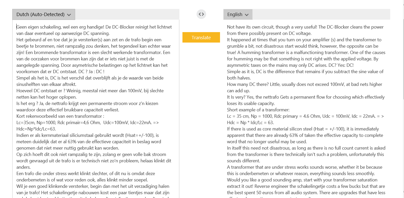

Pity I can't read it, there maybe a clue to why he/she chose to do it their way.

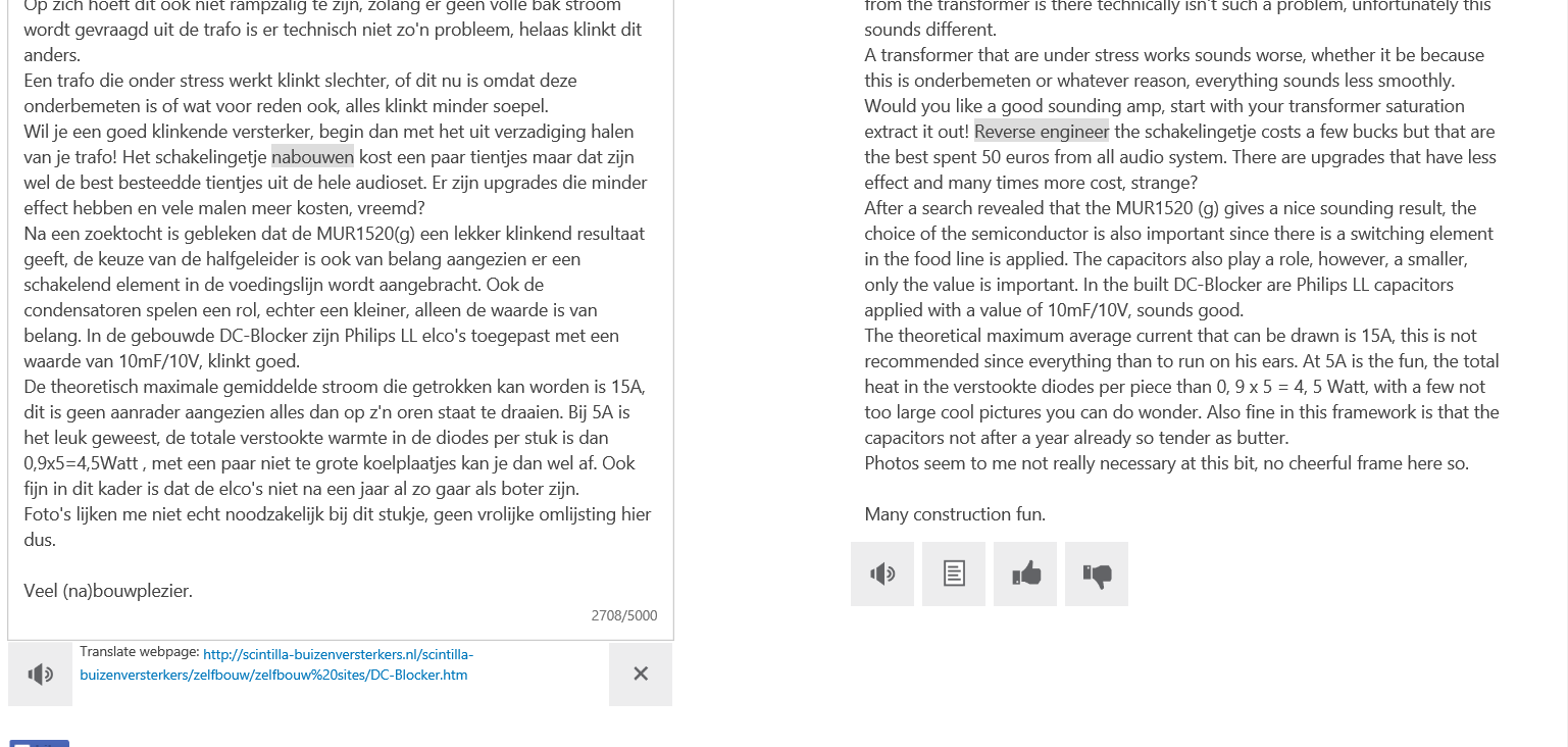

Just swipe the text and copy and paste it into an online translator (Bing or Google) if you haven't the accelerators installed to do it from your browser.
Translation is poor but it does not confirm why they chose that weird arrangement for the capacitors.
No clue to why the MUR diodes were chosen, since they are OFF in all normal operating conditions. There is no switching !
