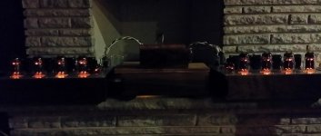

Hi guys. I was hoping to get some help.
I have recently noticed the transformers in all of my amps humming. Some louder than others but everyone is noisy. I thought to check what in the house had changed and found that two humidifiers we have running for the winter are the cause of the problem. I tried adding power line filters to the humidifiers but no difference. I than reversed the phase of one of the units and my amps transformers are quiet as long as both humidifiers are turned on. I’m not so sure this is a great solution.
My question is how to stop the dc from going back into the wall from the humidifiers or if it’s ok to run one unit out of phase.
Thanks for reading my long winded post.
If you disconnect the humidifiers, any change? If you take the amp and connect it in a very different location, still humming?
Both humidifiers unplugged and the transformers are quiet. Doesn’t matter where in the house I plug them in the humidifiers or the amps. My audio equipment is on a dedicated circuit.If you disconnect the humidifiers, any change? If you take the amp and connect it in a very different location, still humming?
Then I suppose a DC filter would do the trick for the amps. I suppose your humidifiers is creating a lot of EMC.
I suppose it would. I was hoping to stop the problem at the source instead of building eight dc blockers. Yes my system is active and uses eight amps.
I think the main problem is that US has no(?) EMC regulations so you can these "polluters". In Europe you are not allowed to sell devices over a certain EMC emission level. You could use my DCT03 which is capable of 12 amps and connect as many amps you want with the restriction to current consumption.
- DC filter
