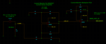

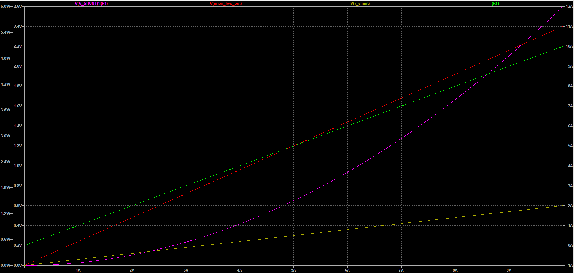

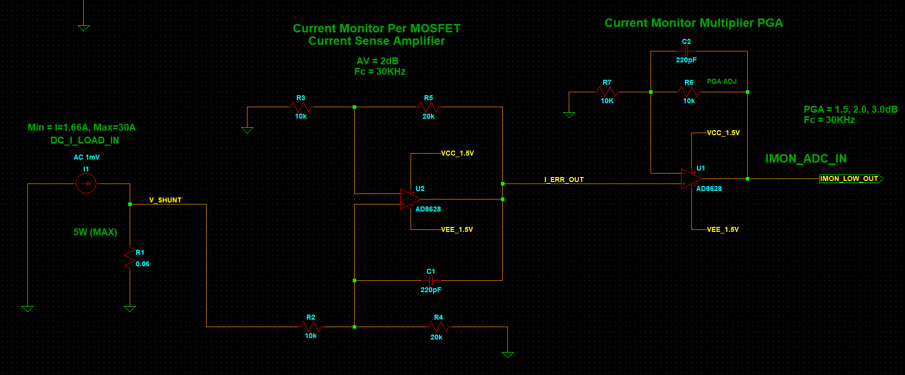

Attached are my simulations for my x2 0.12ohms (0.6 ohm) current shunts, each can deal with 10A @5Watts. I found a box of 25pc unused dale 3W LVR3 resistors 😀

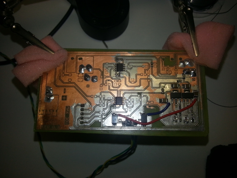

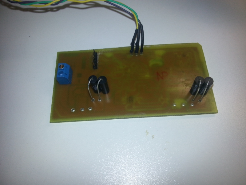

Also, see some assembly progress, thus far I found only one stupid PCB error I accidentally reserved the inputs to the regulators 317 and 337. luckily I used a psu with active current limiting set to 50mA. Both voltages are +/-1.5V with an effective 3V to interface with the MCU signal path.

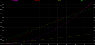

I am finalizing my final multiplier / divide network, a screen grab
Do they work with +/-1.5v?
if not, you can make 3v signal from +/-15v opamp easily by resistors.

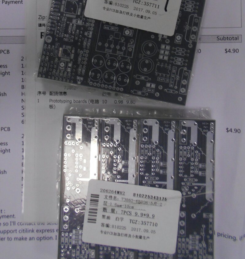

I'm back from my vacation and started to work. ordered some pcb at elecrow and now they have 5pcs option for only $5 for 5pcs 10x10cm pcb.
will upload if you need my layout. it is based on previous schematic of discharger.
