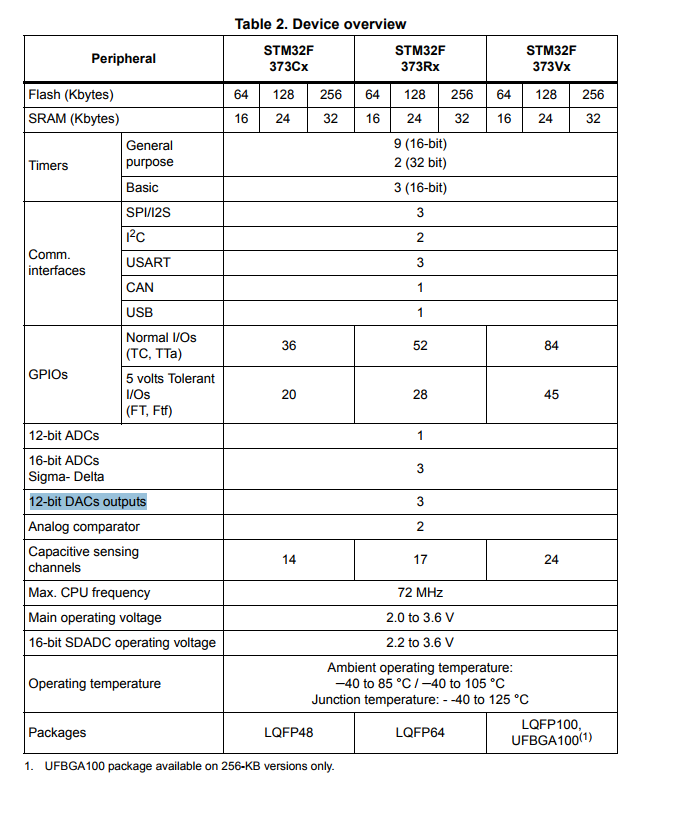

I did some quick search and found stm32f373 was cheap ($5@digikey and $3+@aliexpress), it has precise 12bit ADC, +-0.7LSB of INL. and 3x16bit SDADC (sdadc isn't good for dc but it may still worth).
You can choose which best MCU for $6 margin, I can order it and start with the mosfets. I need some specific information about its limitation and operating range. Will message you about it later.

Perfect MCU choice! it even has a 12bit DAC, one less part to deal with. looks like the only external parts remaining is an external reference and spi flash memory to store the data logging, store settings and calibration data. 😀
2.5Vref, 12bit ADC, 610uV per step, 4096 Quantization levels.
I will stay clear of any rtos for now, a state machine is simple enough. I have a licenced copy of keil V5 and a programmer header. I have a uncompleted STM32F4 DSP subwoofer project on my desk . 😀
which one you prefer? f3 or f4? f4 will be best for DSP, it has +-1.5LSB of INL. its decent 12bit ADC as well.
and it has more features.
I got both on order.
STM32F373V8T6, 32bit ARM Cortex M4 MCU, 72MHz, 256 kB Flash, 100-Pin LQFP
STM32F373R8T6, 32bit ARM Cortex M4 MCU, 72MHz, 64 kB Flash, 64-Pin LQFP
It turns out a 100PIN may still be attractive, user input buttons take alot of I/O and these devices are not badly priced, but I2C I/O expander is cheap as well.

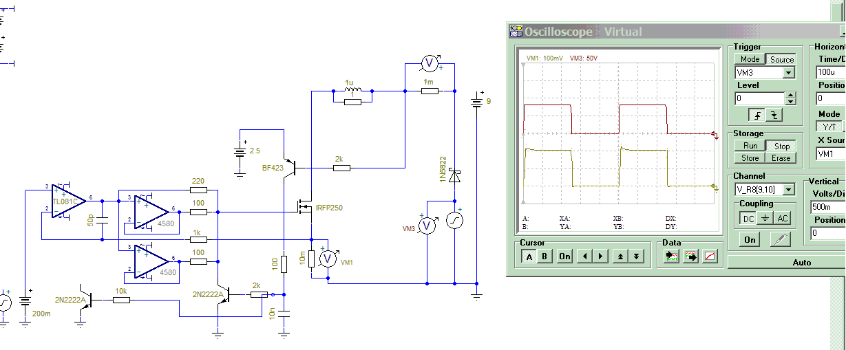

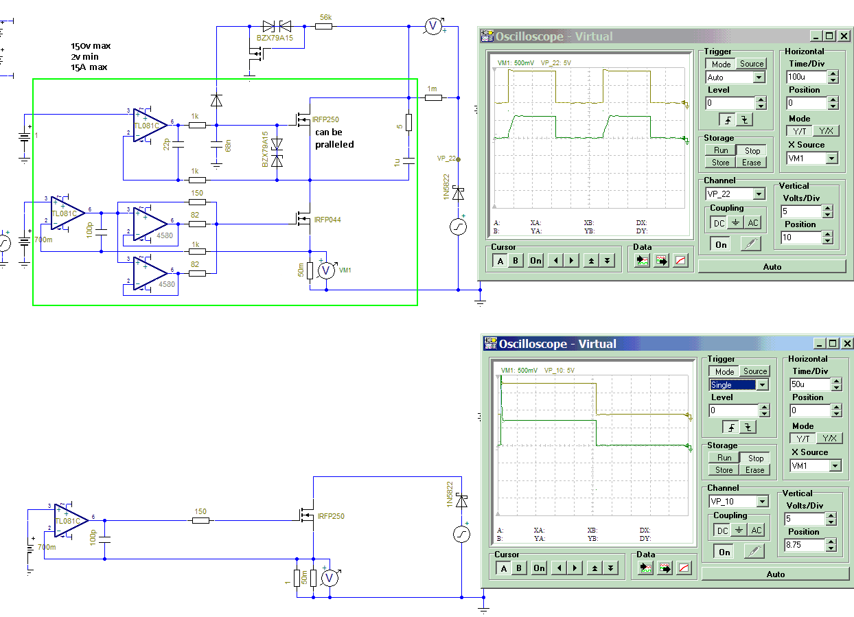

I did some changes to the mosfet and I need adjustment detail. load sharing between upper and lower mosfet and slope limit isn't implemented yet. will add later.
it has some advantage like short spike free from unstable source, and has quicker response.
it able to hold 100w by paralelling the main load with source resistor.
if you need ac 220v protection it required high voltage mosfet as the main load. but protecting from 220a isn't necessary.
the current sensing, since irfp250 max current in 30A it will safe to limit it at 15A. and the value of resistor can be adjusted to what you already have.

Hi, good attempt thus far, I'm lagging behind these few days, I started work today and some of my parts only arrived today, but they did arrive 🙂
I'm settled with the STM32f373, lets keep this conversation for later and jump into the analog stuff for now.
I see you have two servo amplifiers did you really need two ? or is the IRFP250 Qg placing to much demand on the outputs for a single servo amplifier. I have 20 pieces of 072 smd amplifiers I'm going to use for my prototype's servo stage.

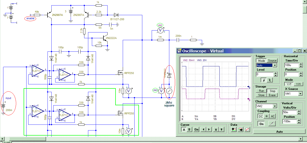

Oh the question about shutdown, yes shutdown is important, it is used to turn off the load electronically (without using mechanical) relays, it will just mute the power mosfets, either from a user input (turn off/mute) or system shutdown command.
looks like its ok this way, 4 of irfp250n. and simulated @2v, they draw 50A+. slow but stable with a tl072 servo.
next will be current sensing, voltage sensing (easiest way is resistor divider but always draw minor current). after that a power converters. then PCB. I can take care of them.
can you re map the port? and choose how to sense the current and voltage? the source resistors can be ignored since it is used for servo feedback.
