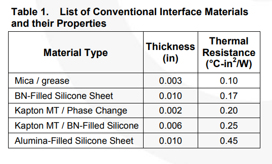

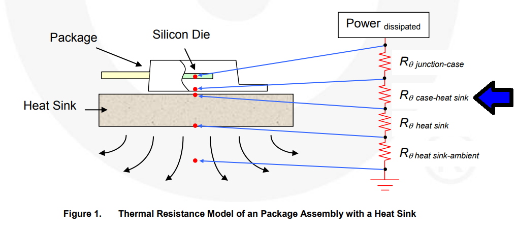

I found these in Fairchild's application note AN-4166, "Heat Sink Mounting Guide"
+1 NICE.

If the mica+grease has a thermal resistance of 0.25 degC/watt for a TO-247 sized piece of mica, and you're pumping 25 watts through each one, then (90 + (25 \* 0.25)) = 96.2 degC at the transistor case.
If each transistor has a junction-to-case thermal resistance of 0.7 degC/watt and you're pumping 25 watts through each one, then (96.2 + (25 \* 0.7)) = 113.7 degC is the junction temperature.

the Fairchild heat flow diagram is slightly unusual, in that it shows Rth heatsink thickness.I found these in Fairchild's application note AN-4166, "Heat Sink Mounting Guide"
Rth j-c, Rth c-s Rth s-a are all normally shown and using values allows calculation to predict junction and case temperatures.
The extra term Rth htkness shown by Fairchild is normally assumed to be near zero and gets ignored or omitted from the diagram.
For copper and aluminium of normal thicknesses it can safely be ignored.
Where one might add an extra thick spreader plate of use a very thick backplate then follow Fairchild and adopt a value for Rth hthickness and see what comes out.

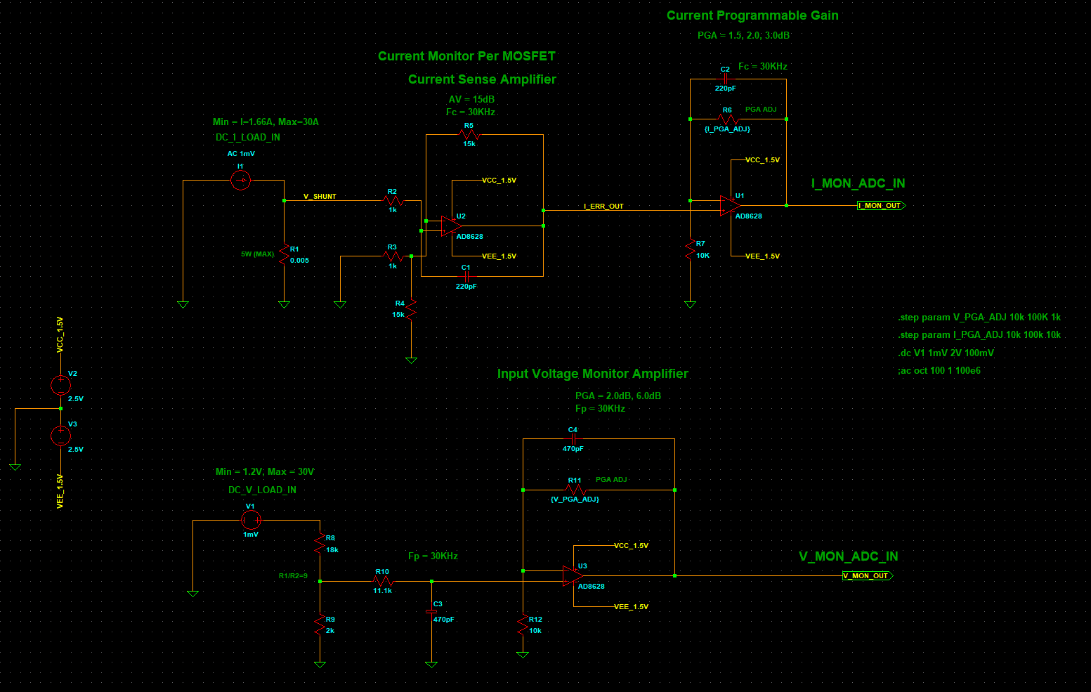

While I wait on the components, I've completed the Current and Voltage front end simulation. This is what I have thus far. I'm busy with the bode plots for the amplifiers, I think I'm on the right track here. 🙂
Note: The resistor scaling and PGA might need some reconsideration, as want to minimize errors as much as possible.

Hi Reactance
I have been watching all of the chatter from the first post. Many good things have come out. I have designed hundreds of Audio Power Amplifiers & Power supplies during my career and the KEY THING WAS $$$. One company I worked for was only concerned with performance and reliability; cost was not the limiting factor.

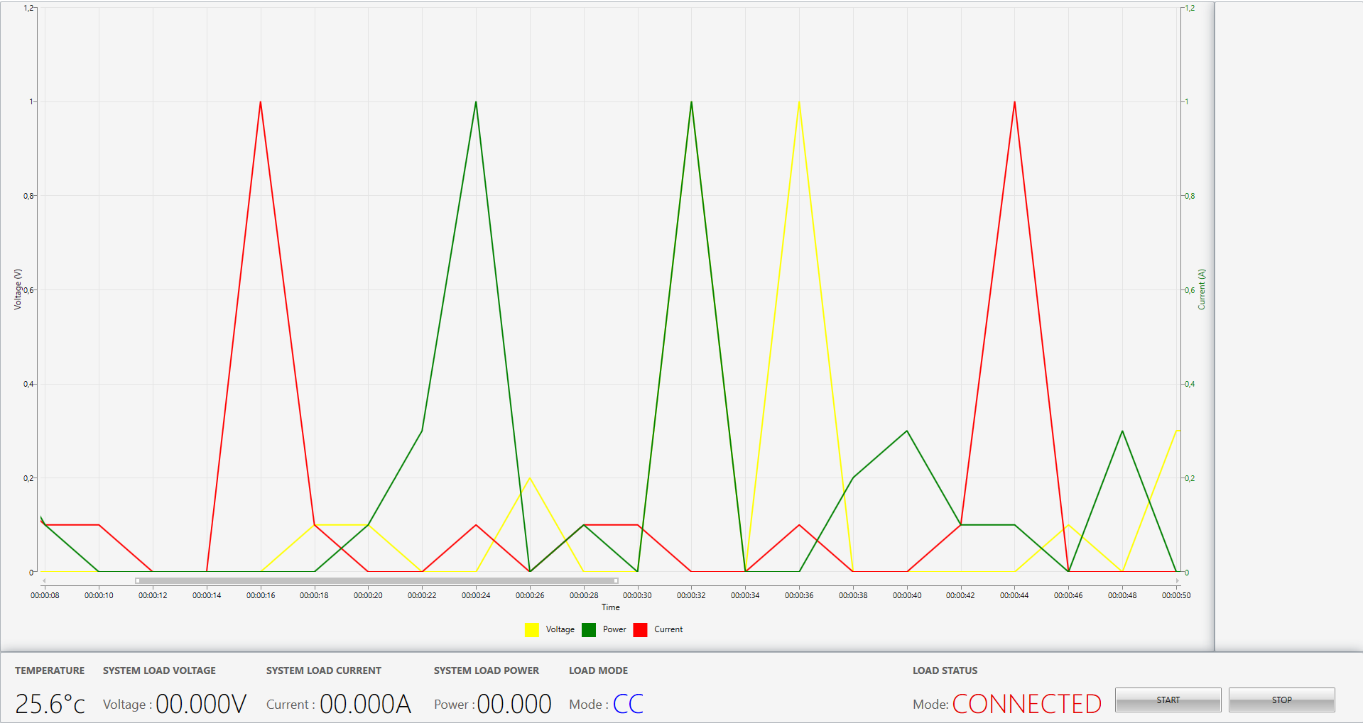

I've put the PC software on hold until the Analog design is actually working 100%. However, see the screen grab, the PC software I gradually started working on a year ago, I was curious at possibly designing an electronic load and played with the concept, now, its a serious project I want to try. The PC client runs on windows only, not sure how much people would want this to run on Linux ? The client is uses the WPF UI stack and looks very appealing to the eye (as it scales on any screen no matter what the screen size is) it also works very well (UI wise).. even better than the commercial BK precision client software which was developed in China which will never receive major software updates doomed by software planned obsolescence.
The MCU firmware I will have to redesign (not a problem for me as I do this stuff for a living, its my daily work domain "windows development and smart phone development"), the original MCU design uses a PIC24FJ128GB210 100PIN device, I don't need a device with this much I/O? (I only used it cause I had this Microchip x2 samples laying around the last 4 years and flirted with the PIC24F stuff) realistically, anything smaller up to ~64-PINS (max) should be used for the following I/O.
