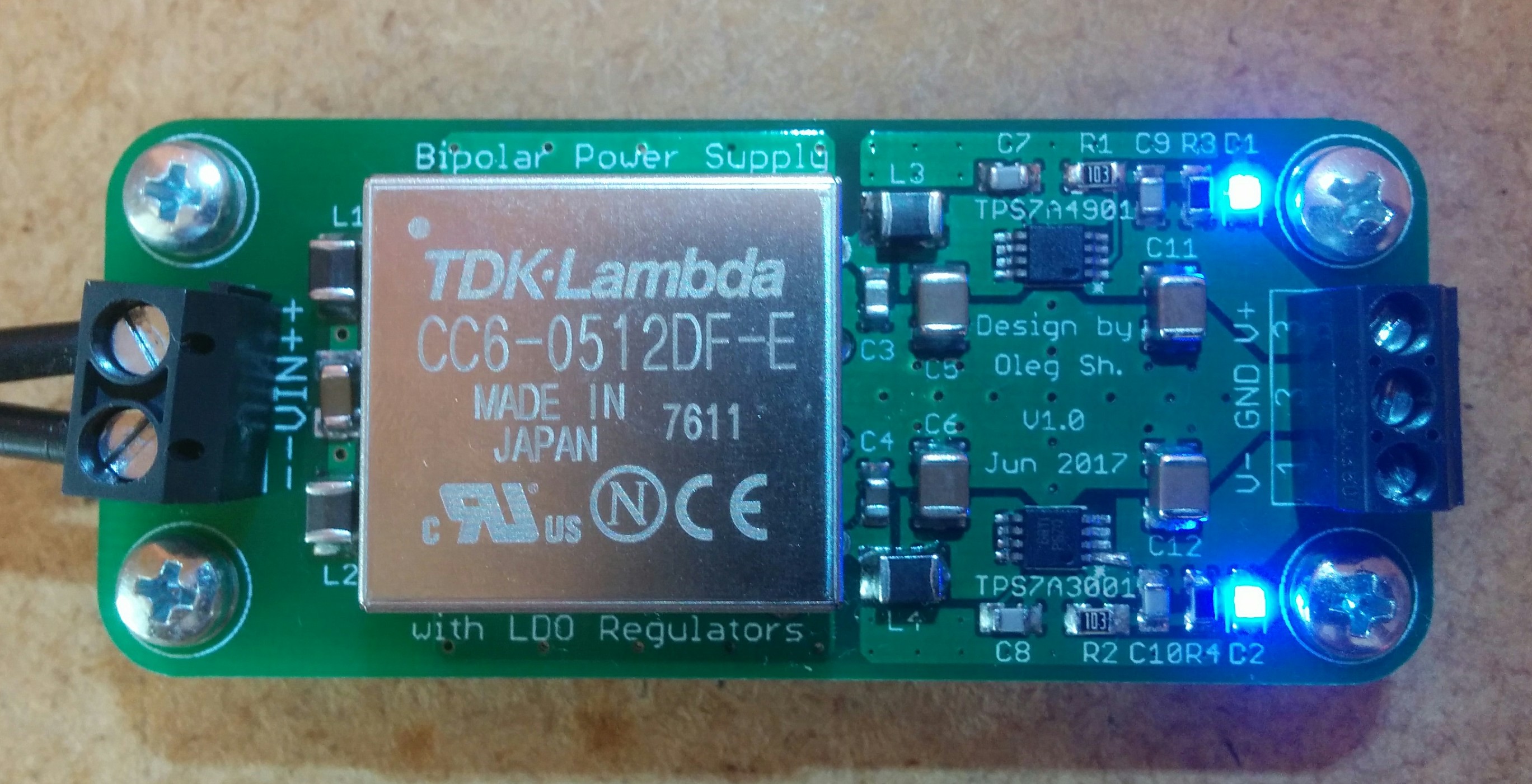

The way it was is shown in the attached zoom-in. Notice missing connection from pin 1 to the output copper pour in the red circle. The feedback components R2, C10, R4 are connected as they should.
The EN pin is properly connected to VIN (upper left pin in the attached zoom-in) but I measure only -150mV on the output after I connected the output pin to the output copper pour.
You may want to check the voltage at the feedback pin. That way you may get an indication if the reg is broke or if there is another issue, like with resistor values.
C2, and possibly C12, seem unsoldered at one side.
Jan
After changing the TPS7A3001 the PSU finally works! The rails measure +12.20VDC and -12.12VDC (less than 0.7% difference from each other and around 1.7% above the target). All within Vref tolerances of the regs.
The tests/measurements under load I'll probably do on the weekend.
Oleg

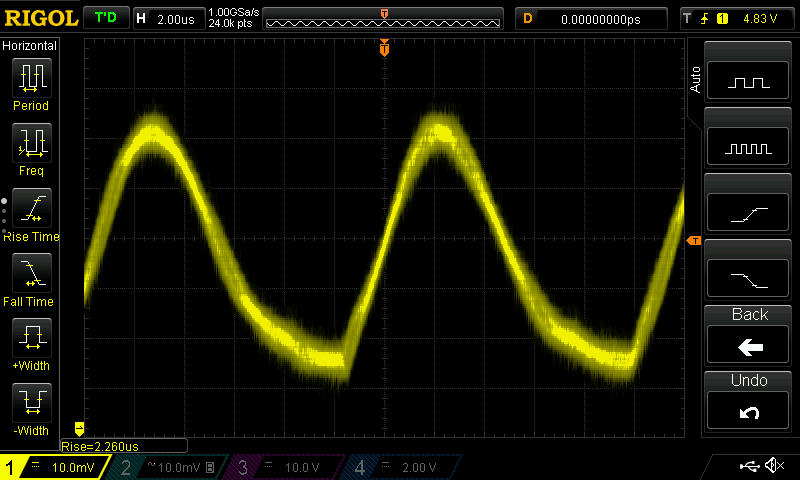

Just measured the input and output of the PSU. Under load pulling roughly 100mA from each rail, the input shows 50mVpp 83kHz ripple without indication of spike noise. The output is clean so the scope does even trigger. Interestingly, my earlier measurements all showed around 200kHz input ripple under heavier load and now it is 83kHz. Puzzling isn't it? Also the waveform has changed.

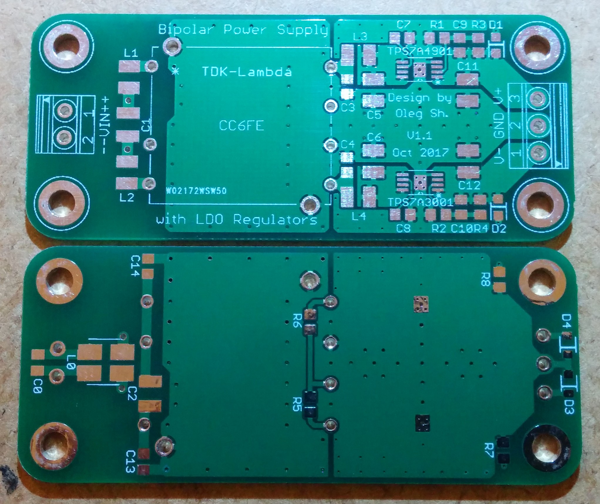

Just received new batch of PCBs with corrected error and some minor modifications/improvements. From now on all my line level projects will run off DC-DC converters. Getting away from directly dealing with mains power makes the life of a diyer so much simpler.
Oleg

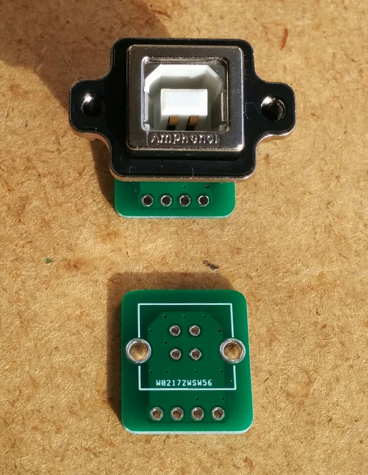

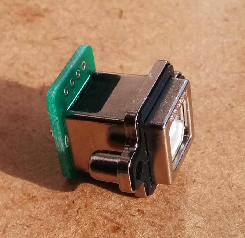

For power inlet I found a nice USB-B socket (mouser part number 523-MUSB-D511-N0). To make it easier to use I also made a small backplane PCB for it (see attached).
