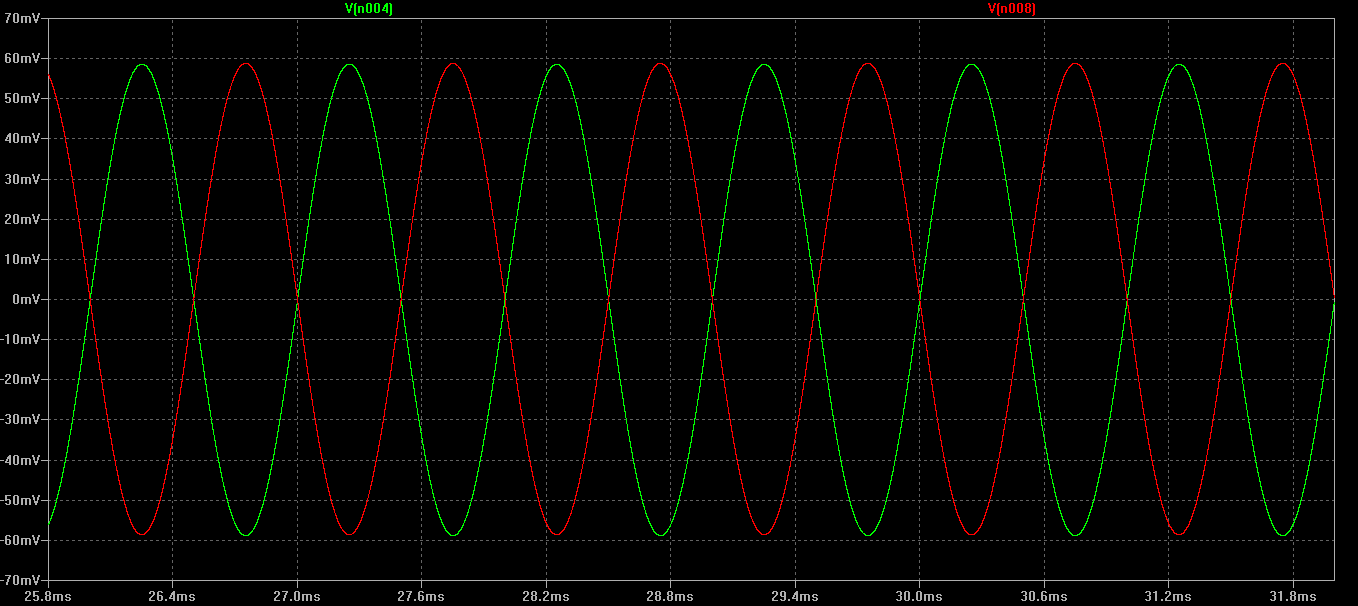

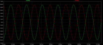

It may be that the sim has the tube characteristics with the output impedance of the cathode different from that of the plate output impedance. Try a different tube in the sim like a 12AU7 and see if it shows a different balance. This is a known issue with cathodyne inverter.The circuit show near 2V difference between outputs, why?
It's not a sim error. Not connecting C1 causes ripple on the B+. The anode output of the cathodyne has low PSRR so the ripple is added to the signal. The cathode output has high PSRR so doesn't see the ripple. If you connect C1 in the sim the outputs are the same as they should be.
Yes, if you actually do not have C1 connected for the sim, that will cause an error due to unwanted effects from R3,
which among other things, makes the plate resistor larger, and hence the plate output voltage larger.
Even if it is connected, the test frequency must be high enough so the impedance of C1 is very low to ground,
in order to avoid this effect.

Recalling an article interview with David Hafler and this issue in one of the amps, his explanation for a circuit adjustment was that the unbypassed cathode load resistor created degenerative FB that created the signal gain differential at the cathode. If memory serves correctly. Searching for the mag. it's in.
The plate and cathode signal currents are the same, so equal loading gives equal outputs.
Sure the output impedances at the plate and cathode are different, but that doesn't matter with equal loads.
However, if there is significant capacitive loading, the unequal Routs will cause an imbalance at very high frequencies.
Perhaps Hafler was discussing why the cathodyne does not have the imbalance problem of the "cathode-coupled phase inverter",
which does have an inherent output imbalance, due to the finite impedance of the CCS (or resistor) to ground.
With a perfect (infinite impedance) CCS, it too would have perfect balance. Of course, the correct fix is to drive it balanced.
Then it would have perfect output balance, by virtue of the symmetry.

Of course leaving C1 disconnected was the real cause of your problem.
But do not overlook the potential problems of 2. and 3. in a real circuit.

Stupid of me! ... Now the outputs are perfectly equal.
Another day, another lesson...
Thank you very much to all.
