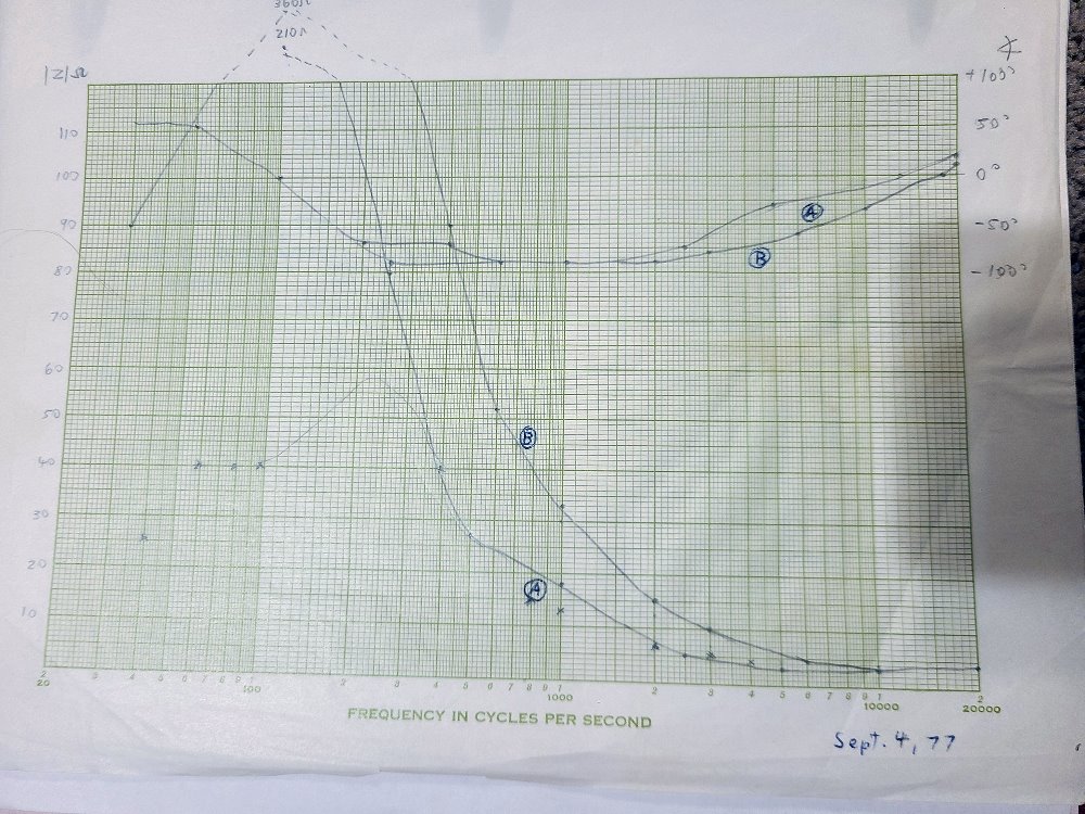

Attached is a graph of the impedance I measured of the speaker at the transformer input, at different primary impedance. I had it wired in parralllel and in series for different stepup ratios. It seems that the transformer had significant self inductance even at 30 Hz to prrovide an easy load on the amp.
  1. If the impedance plot is measured at 2,83Veff (4Vpk) : same plot at 28,3Veff (40Vpk) will raise self inductance by factor 10 ( examplewise, depending on core material etc.) at low frequency < 500Hz.​
  2. The 100Hz impedance peak is resulting from parallel resonance of self inductance as first contributor and net secondary capacitance stepped up by square of step up factor as the other contributor. Secondary capacitance is ~constant when voltage is changing.
  3. 100Hz impedance peak will go down in frequency by square root of the factor 10 : ~30Hz
  4. The curve above impedance peak frequency is "widely shifted to the left" and impedance is severely lowered there.
  5. Transformer primary midrange current will go up strongly with raising signal level in the base . This is not because saturated core. Maximum effect is when base and midrange level ( music ! ) is both present. Nasty load for the power amp !
  6. Huge amplifiers needed to charge internal transformer capacitance. Here primary - secondary capacitance will be a strong contributor ( big core ). To get an idea of the primary transformer capacitance : impedance plot of the transformer without electrostatic cells and then comparison to the loaded transformer curve.

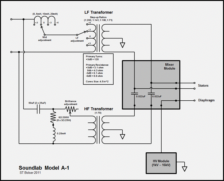

  7. What could help : using the big Hammond transformer below midrange and taking a small core second second transformer for the rest of the audio bandwidth...see the soundlab approach attached..
  8. the parallel resonance itself is a big helper as current is lowered : real power fro the electrostatic cells is vanishingly low..
regards, Philipp
