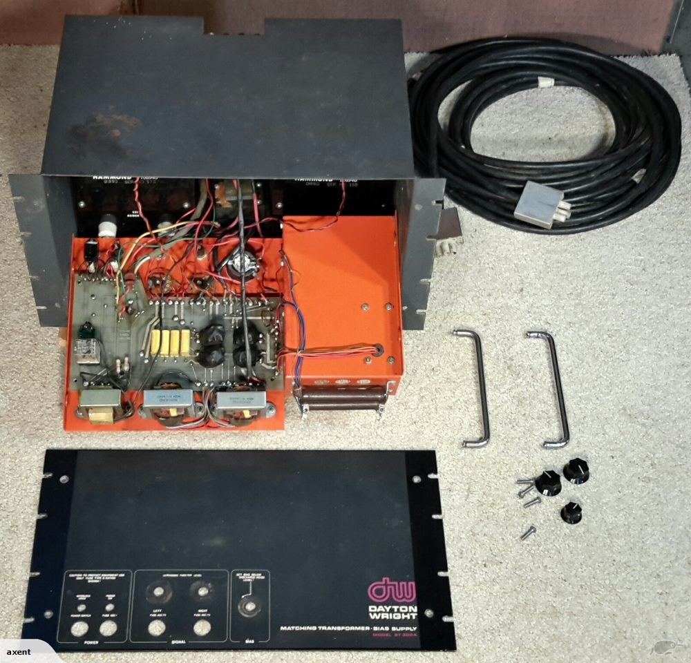

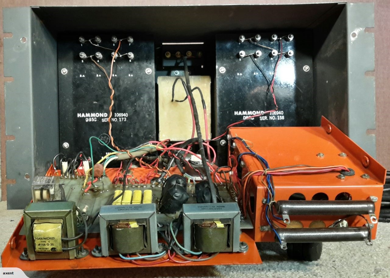

The DW transformer made by Hammond is a piece of art : little whobble around 10Khz, but up to 20Khz and above flat !
price to pay : internal capacitance of the transformer will suck out any normal amplifier´s current capabilities above ~2kHz ...difference of the speaker connected connected to the step up transformer compared to the transformer alone is low - seen from the amp..long stories, I close for now,
