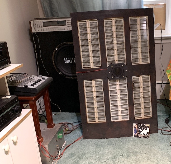

I just acquired a pair of DW ES speakers w/o any ID on them as to model. I am a total rookie when it comes to the ES world. They have 10 panels and 2 tweeters. The bias supply is an ST-300A. I’m reasonably sure there is no gas left in the bag. The person I got these from tried to power them up. One side crackled and the other was dead. The story I got was they were in a damp basement for decades. I took the grills off due to mold and wiped down cabinets. It looks like one speaker has a corroded connector in need of replacement. Any info on these dudes would be helpful. Did some on-line info gathering but haven’t found any links to manual or model #
Dan
Dan
Dayton-Wright XG-10 ESL.
I sold 3 pr of the XG-8. Fantastic Loudspeaker. A bitch to drive.
On first blush it sounds like a PSU issue. They definitely need the gas. Suppher HexaFlouride.

Thanks, Dave.
About 10 yrs ago, sold my XG10 (with Klipschorn bass... very good match to DW) to a group from the Montreal club, I have returned to my open-air system with XG8 panels (6 per side) that sound better than the XG10s. Built these around 1977. Bias from an EMCO module.
Recently, wanted to downsize and sell these panels and the two extra DW transformers (37 lbs each). But I couldn't do it.... the sound is simply too amazing (but the two extra transformers are still for sale and other DW bits).
The gas enables the XG10 to put out nice bass down to about 50 Hz but inhibits the treble. The panels were on the surface of a sphere which, Mike said, was like creating a virtual point source.
The XG10 piezo tweeters actually test quite well for FR and distortion, but look cheap. I help my top end (north of 4kHz) with fancy film tweeters which are better.

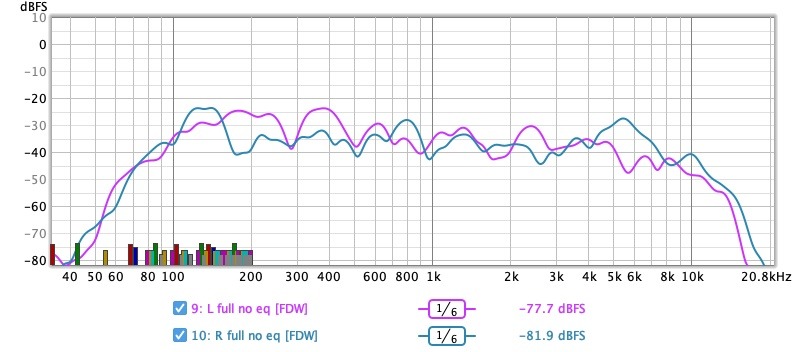

Attached is the full-range FR for the panels, no EQ, no tweeter, rather small room. Distortion is so low hard to measure without having the silence of an anechoic chamber. The aluminum box in the lower left corner holds the transformers etc.

Serious downsides to using HS6 (if I have that right). Not sure of the value of the benefits. You lose loudness with lower bias.
The gas and sealed mylar front and back produce a big bass boost, but a single pair will never be satisfactory without a woofer.
Might be my imagination, but I like the transparent super-clean sound of my free-air panels better than the DW stock units in the square box (hey, square bad acoustically, eh). And that's what I'd suggest to you, forget the gas and quite heavy mylar.
I think I've run free-air up to 6kv but seems comparably loud at 2.5kv.
My panels (with stock DW transformers, 2 spares still sitting around) are pretty capable down to maybe 120 Hz. With larger DW box, maybe lower.
On music, no loss of stereo even with a single mono woofer (even off to the side) below that, as some decades of experience tells me. With stereo woofers located near each panel, no issue at all.

I have a pair of DWXG-10 Mk II with the Panasonic leaf tweeter. I used them from 1980 to 1995 with HF gas. Mine were not that great in holding the gas. I think every 5 years I needed to top up. As far as efficiency went, even with the gas, you needed tons of power. I used a pair of bridges Hafler 220. Thing is that even when they played loud, the amps did not like them and sounded harsh above moderate level and depending how much midrange the music had. Bass output was never an issue, and any good recording with drums pretty much sounded real. I heard a lot of high end speakers, but never the just there bass with perfect transient control. The closest was those servo feedback woofers from Velodyn. But for me unaffordable when they came out. Over the years I found that the sound changed as the state of charge varied/, they had to be plugged in all the time because they took several days to fully charge. A full charge was audibly, you could hear the slight hiss of the corona and they efficiency was so high you could hear the HV power supply hum. Of course then you needed to low er the bias or the corona would create conductive paths and increase the leakage and making the cells unrepeatable (according to Mike Wright). But when they sounded good, I could only describe it as a window to the music, if you had the right recorded material. Crap recording sounded like crap. One more thing. I thought they had a certain tonality unlike any other speaker, but your mind completely ignored it after listening for a few minutes.
I decided to run the speakers without gas and resigned myself to just playing jazz and other natural recorded music. I had to turn the bias way down, to maybe 11 o'clock on the bias dial. What killed it for me was that cells started to die, more in one channel than the other. Some of it probably was my fault, I sometimes played them so loud that they would arc over on heavy bass transients.
After this I embarked on a project where I would rebuild them in a frame of my design, because it was pretty obvious if you hit the wooden structure the individual cells were mounted in, you could easily hear the resonance. It could have bee the cell resonances, but I devised a better way to mount them so that repair would be more easy. So even if the design and other things were done right, the frame holding them was not very sturdy.
It was huge work to take each of them out, so I only did one channel. Then I decided to take a cell apart to repair the diaphragm. I had talk with Mike many times. He told me what the diaphragm resistance should be, what semi-conductive liquid he used and where to get it. Also what glue to glue the Mylar on the plastic frames.
Basically I had all my duck in a row. I got a 1000 ft sample of HS65 Mylar from DuPont, got the liquid from the lab in the US and bought an electro-voltmeter that could read up to 10e14 ohms. After I drilled out all those rivets without damaging the plastic frame, I thought all this is crap-load of work. This was in 1999. Stuff came up and i never did anymore. Meanwhile a local audio store that i visited often had a pair of older speakers. I could not pass up the $200 sell price including delivery!
Then life intervened and I finally decided to do something with them. Naturally the company with the coating no longer exists, and the stuff I had was completely evaporated. There is pretty good crazy glue designed to glue Mylar to plastic nowadays. So here we are so many years later. I now have MartinLogan speakers and initially started a thread there with pictures and descriptions, before it all gets lost as DW website is no longer.

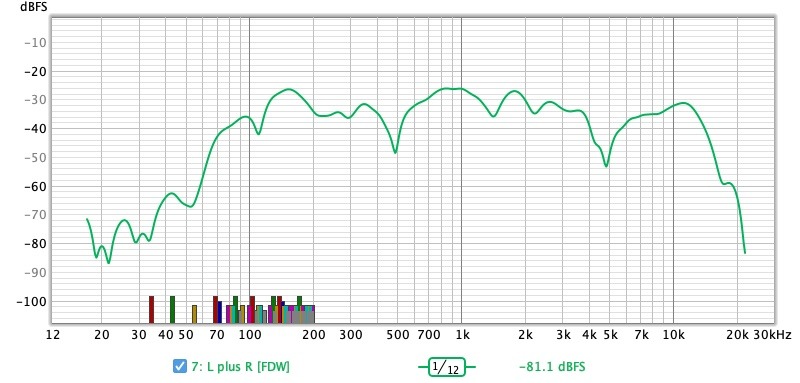

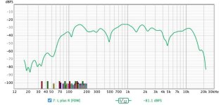

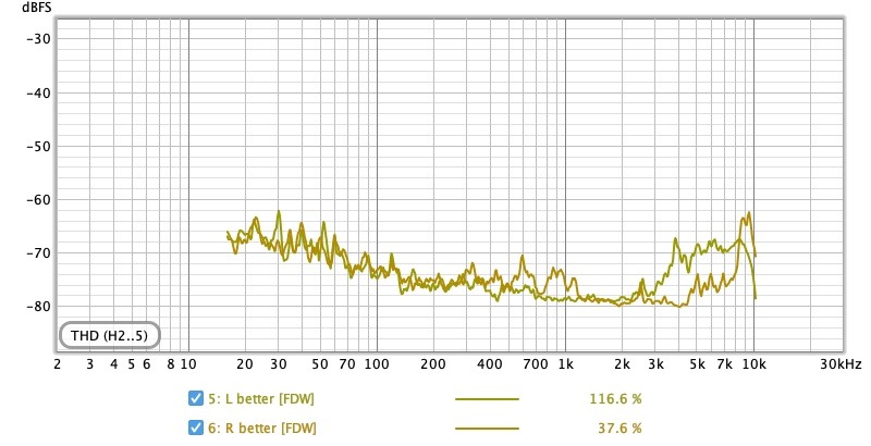

A few months ago, amidst some confusion in my affairs, ran my panels directly from the headphone jack on my 13 year old Mac laptop directly into the brutish Kenwood amp (class G, guessing around 1982). No DSP, no EQ.
One chart is REW combining L and R (but separately, panel traces look pretty much the same). Not bad considering the mic was near my chair in the centre of a rather small listening room. 1/12 smoothing. The horrible bumps and dips would all be different if I moved the mic a few inches: FRs get a lot more attention than they deserve. Sometimes I make curves by averaging 3 locations, a nice feature of REW.
The other chart is distortion. The two curves go down just as far as REW can take it in my house at that hour if nothing was playing. Not sure what it means exactly but "-60 dB" is 0.1% distortion showing up at the mic. Usually, 1000 ways to make bad looking traces but only one way to make true ones.
Hey, not bad for the headphone amp in my ancient laptop and an old cheap Behrenger mic mixer with phantom bias supply feeding the mic signal to a $20 Behringer DAC....not to mention my 1977 DW panels.
The sound was just as crystal pure as you'd think, given the miniscule distortion. Maybe not on organ music, eh. Treble wonderful, at least good enough for my failing aged ears (1940 model).
